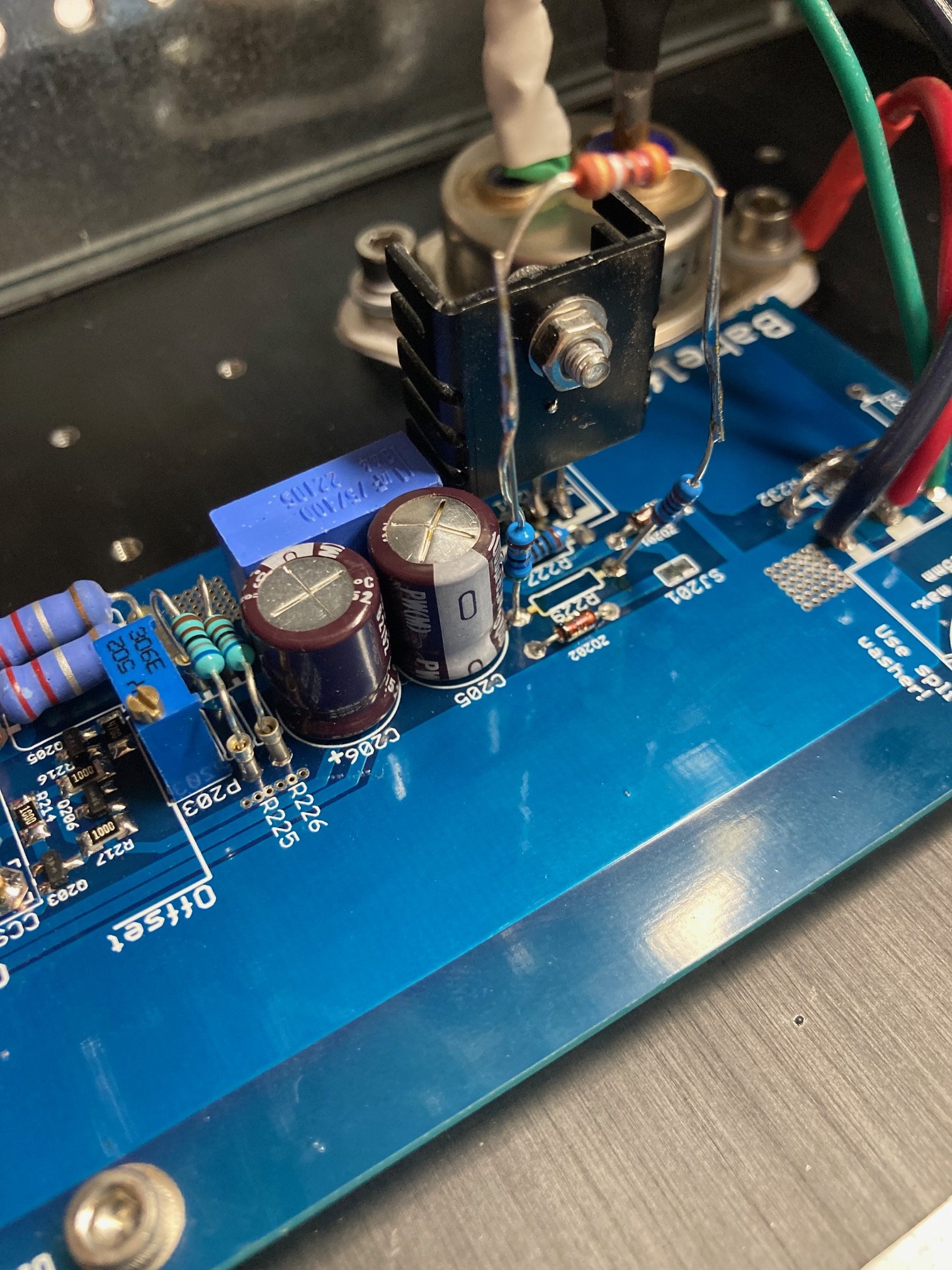

Yeah I ooked up, and ooked further with one channel before I figured out a part was missing. To include letting the gate of the SIT go open when under power. Regarding that, despite 8A coursing through half the circuit for a few seconds, no parts were obviously damaged... except this capacitor, which I noticed & replaced yesterday (please ignore the gate shifter aerial, lol).
Regarding Ugs. I guess I don't know what that means when it comes to a SIT. Vgs doesn't make sense to me with a depletion mode device because tying the gate to 0V means it's fully open. The values I gave were more properly Vth, as determined by hand with a frankentracer, and looking for a voltage drop across a source resistor. IOW the gate bias at which the SIT started conducting. Those values are as I said before, that is, -5V5 and -5V6. Is that inconsistent with the gate biases I reported for the channels when passing 1.8A?
