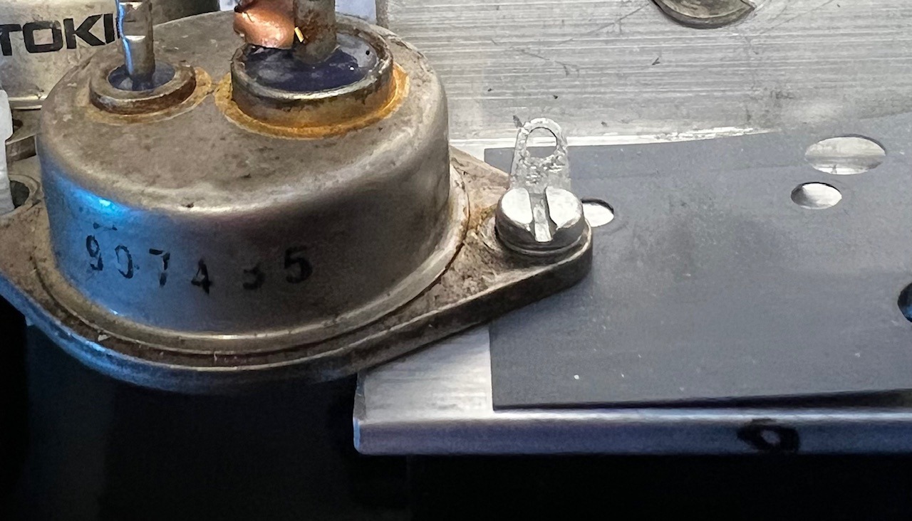

The Tokin 2SK180 hole diameter is .205" ~5.207mm and flange thickness is .123" ~ 3.1242mm
The Tokin THF 51 Hole: .2" ~ 5.08mm and flange thickness is .102" ~ 2.591mm
This will work for #6 or #4 screws: https://www.mcmaster.com/products/n...ew-size~no-6/sleeve-od~0-187/screw-size~no-4/
This will work for 3mm screws: https://www.mcmaster.com/products/n...ers-6/screw-size~m3/?s=nylon-shoulder-washers

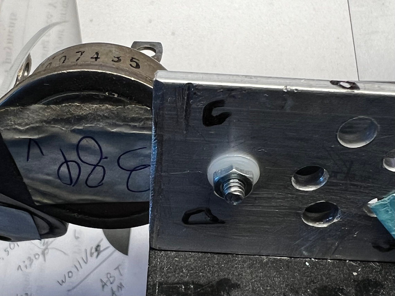

I can't find ones that will work for 4mm screws. But if you are mounting to an L or T bracket you can use a larger shoulder washer on the opposite side of the hole in the bracket to insulate the screw. See attached photos for example:

Or this works with a 4mm screw: https://www.aliexpress.us/item/3256801699853028.html?spm=a2g0o.productlist.main.1.3ea4becf7BaNZl&algo_pvid=c6313550-0d33-49d2-be39-a6c6de1ce364&algo_exp_id=c6313550-0d33-49d2-be39-a6c6de1ce364-0&pdp_npi=4@dis!USD!0.96!0.83!!!0.96!0.83!@2103247417068828069281925ef4d6!12000018014948771!sea!US!117126853!Z&curPageLogUid=HVFOvoCjITqM&utparam-url=scene:search|query_from:
The TW 10 is little bit long for a THF 51, but you can trim the length with a sharp chisel if you are careful.

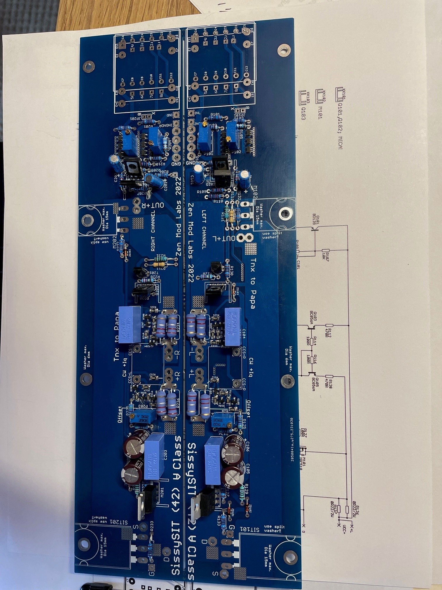

New SissySIT build started, thank you ZM for an intact and complete set of boards and components.
First question from Post #1:
"- two tiny (isolated) wire bridges on right channel pcbs - mount it just for SissySIT "
Where do you install these tiny isolated wire bridges on right channel pcb, and what's the best method to do so? Are the tiny wire bridges included in the parts kit?
Many thanks in advance,
Jim
