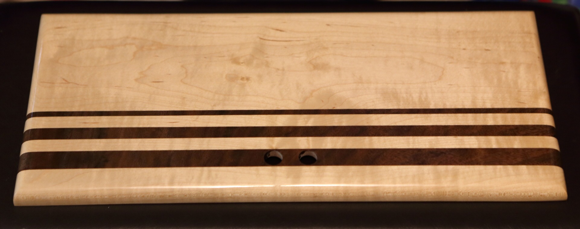

Been kinda quiet on the build front while waiting for parts, so I finished the front plate. I rounded the corners, sanded, and drilled two holes for the power switches. Switches will be flush mounted push buttons with an LED ring - one for each channel. I'll post final images once the last shipment arrives.

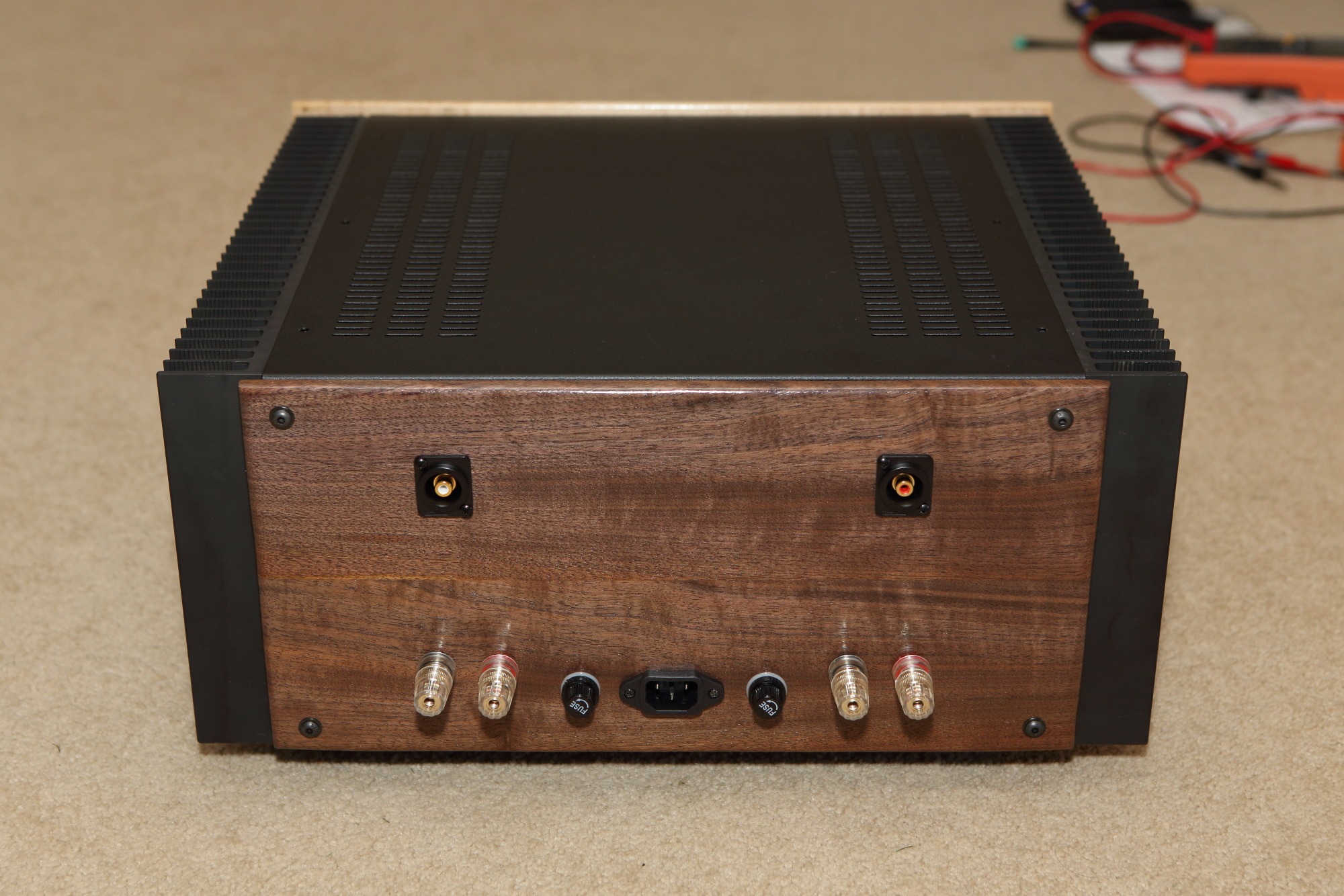

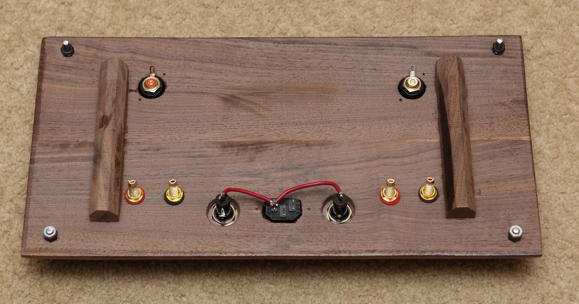

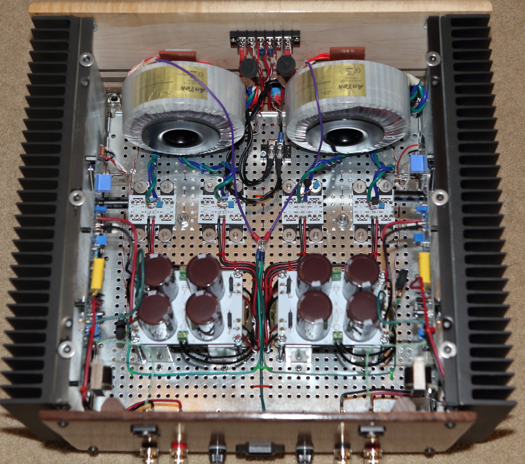

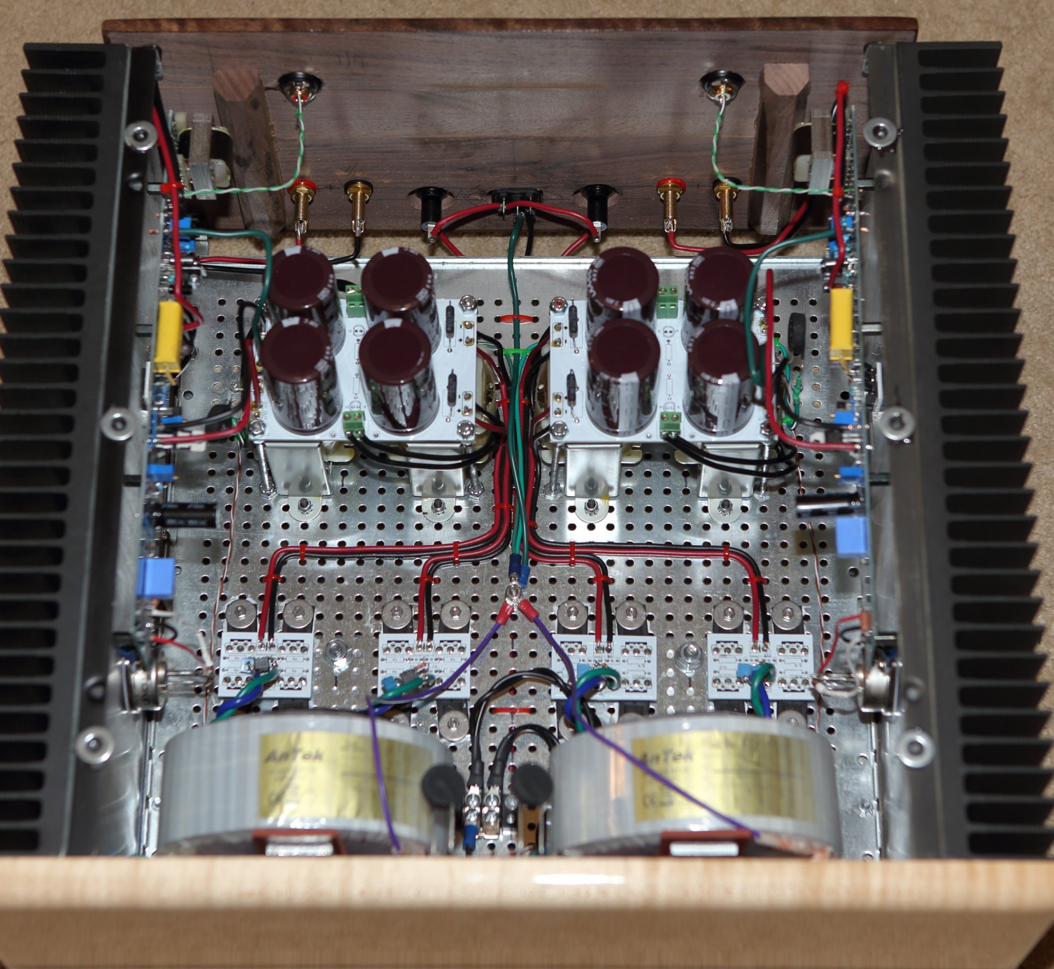

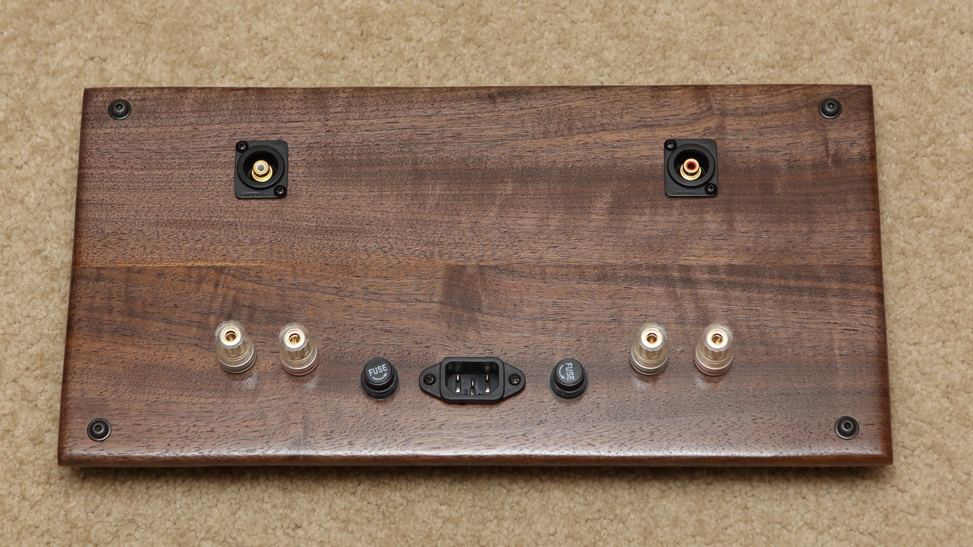

Spent the past day and a half doing final wiring on my SissySIT amp. I always seem to underestimate the amount of time it takes to get all of the wiring in order. The back panel is a piece of walnut that I split down the middle, joined edge to edge, and added some ribs for strength.
Pass DIY Addict
Joined 2000

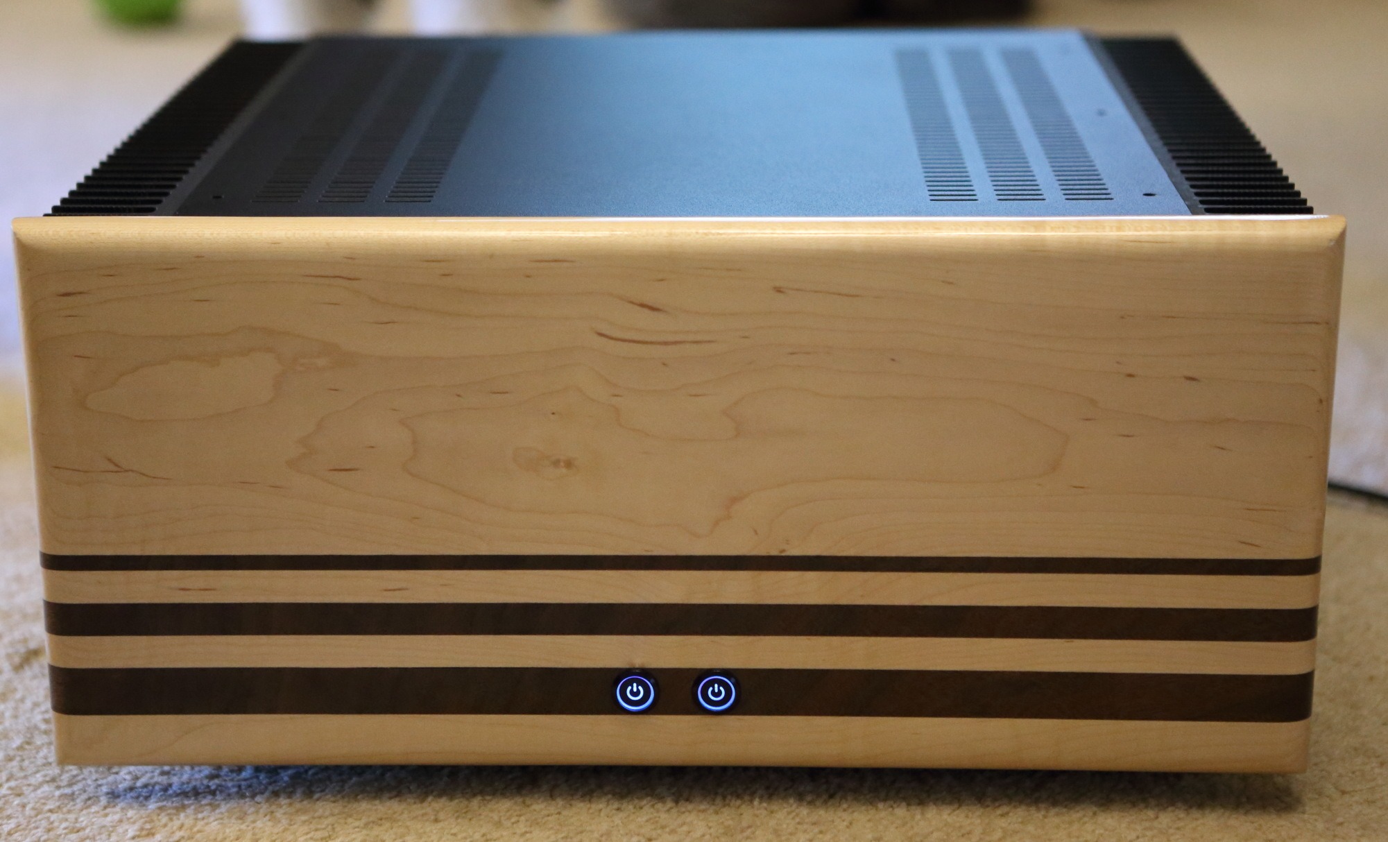

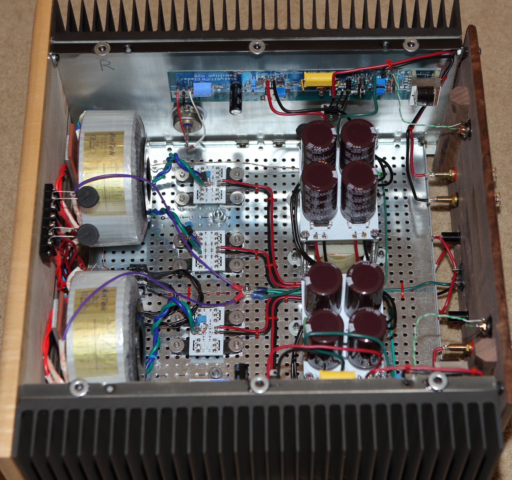

Here are some additional inside shots and a few of the closed chassis. I put the power switches in the walnut stripe to hide them a little. First power up was smooth and uneventful. I spent a little while dialing in bias for the input and output stages and zeroing the offset. Like all of these heat monsters, the numbers in my DMMs all seem to dance around a bit. I've learned from my Aleph-X days that ballpark is good enough once fully warmed. Set bias to about 1A85 and resulting sink temp seems to be near 42-44c. Haven't had time to really listen yet, have an event to go to next.

I'm a little surprised at the final overall dimensions: 480mm wide, 420mm deep, and 200mm tall. I was trying to lay things out so they are clean and neat. I also want to measure the PSU ripple and see it on my scope. I expect it should be pretty clean. The only part of the psu shared by each channel is the power cord.

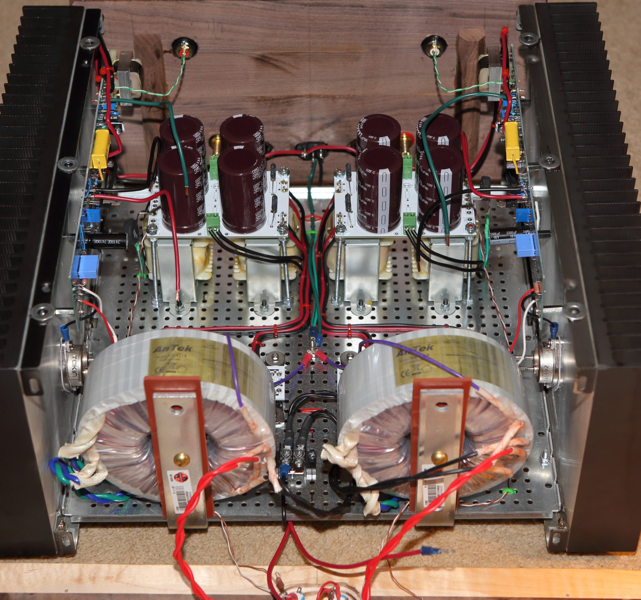

Wow! Just measured PSU ripple and speaker output with the inputs shorted. Pos and Neg rails on both channels as well as speaker terminals ALL measure 0.00mVAC! Color me impressed! I didn’t think 33k uF caps would be enough to produce a zero ripple PSU.

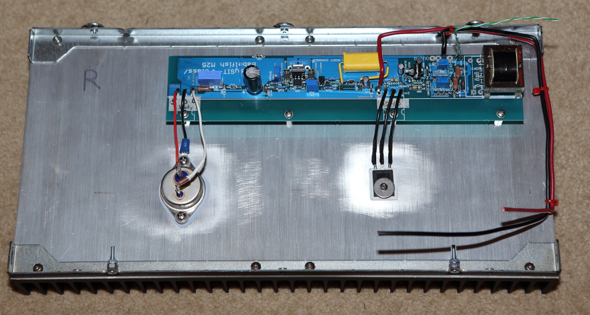

Thanks, Dan! That was my first thought about the PSU ripple as well - I was expecting to see something in the single digits of mV ripple given that I only have 33kuF before and after each choke. The chokes are Hammond 159ZJ, 10mH, 5A, 0R160 Ohms. I'll have to recheck ripple tonight, something seems fishy to me as well. I also sat and played with bias and offset adjustments last night. When I made ripple measurements, the amp had only been on for a few minutes. It seems that the bias wants to creep upward as the amp warms up. After about three or four hours last night of tweaking, putting the lid back on, letting it sit for 10 mins or so, and watching the meters, the bias was creeping just north of 2A0. I was seeing about 25c thermal rise on the sinks opposite of the transistor mounting sites. I think it started somewhere closer to 1A7 when it was cold, so I want to see where it starts off tonight at first power up and see where things are/go.
Front end bias seems to hold pretty stable at 20-21mA, but the offset seems to wander +/- 3 or 4mV or so on a pretty continuous and somewhat random basis. Output stage bias seems to climb at is warms and speaker offset also seems to dance around by +/- 20mV or so. I discovered that merely putting my hand on the sink creates an instant drop in bias (voltage dropped across the PSU choke by about 10-15mV). It pops back up again as I remove my hand. I'm guessing it's a capacitance thing more than my hand changing the sink temperature because of how rapid the reaction is.

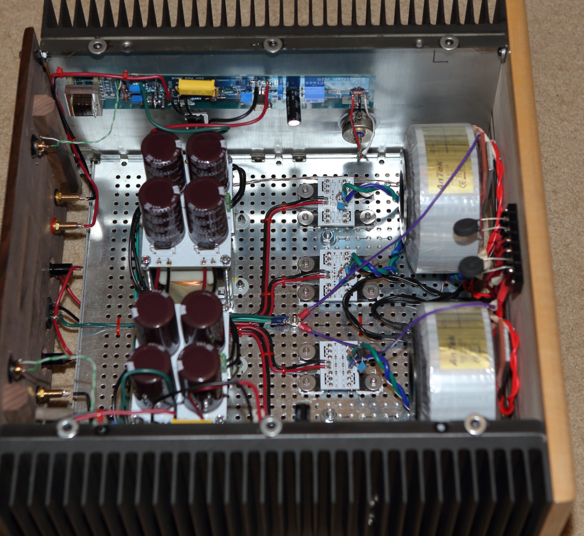

There are few interesting asymmetries in the behavior of the two channels. In the left channel, the positive rail exhibits no measurable ripple, while the negative rail exhibits about 2.7mV of ripple. It is exactly the opposite in the right channel. The dc offset in the left channel spikes to about -200mV within the first 30 seconds, then settles to about -25mV by the 5 min mark, then bounces around the zero mark, going pos and neg by about 20mV or so. The right channel maintains about -100mV offset for about the first 30 mins, then settles closer to zero after about an hour. Given that even 200mV of DC offset into an 8R load is less than 0.005w of dissipation, it’s not worth worrying about. Both channels run on 23.8vDC rails.

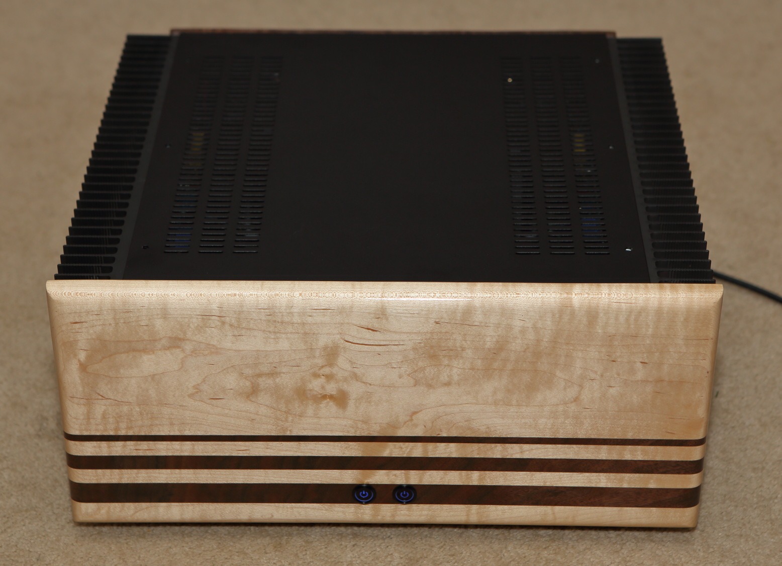

The giant chassis absolutely dwarfs the 3U chassis for the Sony VFet amp.
