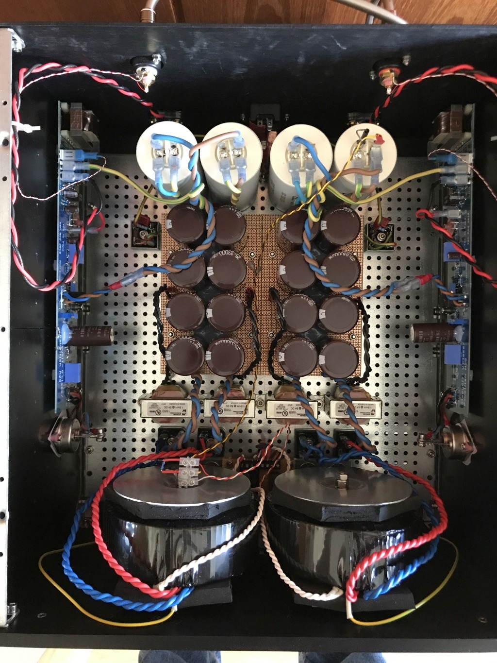

Just a fyi
Years ago, when I first built a CLC, it was suggested that I use Erse Super Q 2.2mH units. I have a couple of separate box CLC s built with these. I use Powercons to connect to amps. Unfortunately I don't think they are still available but the specs are on line.

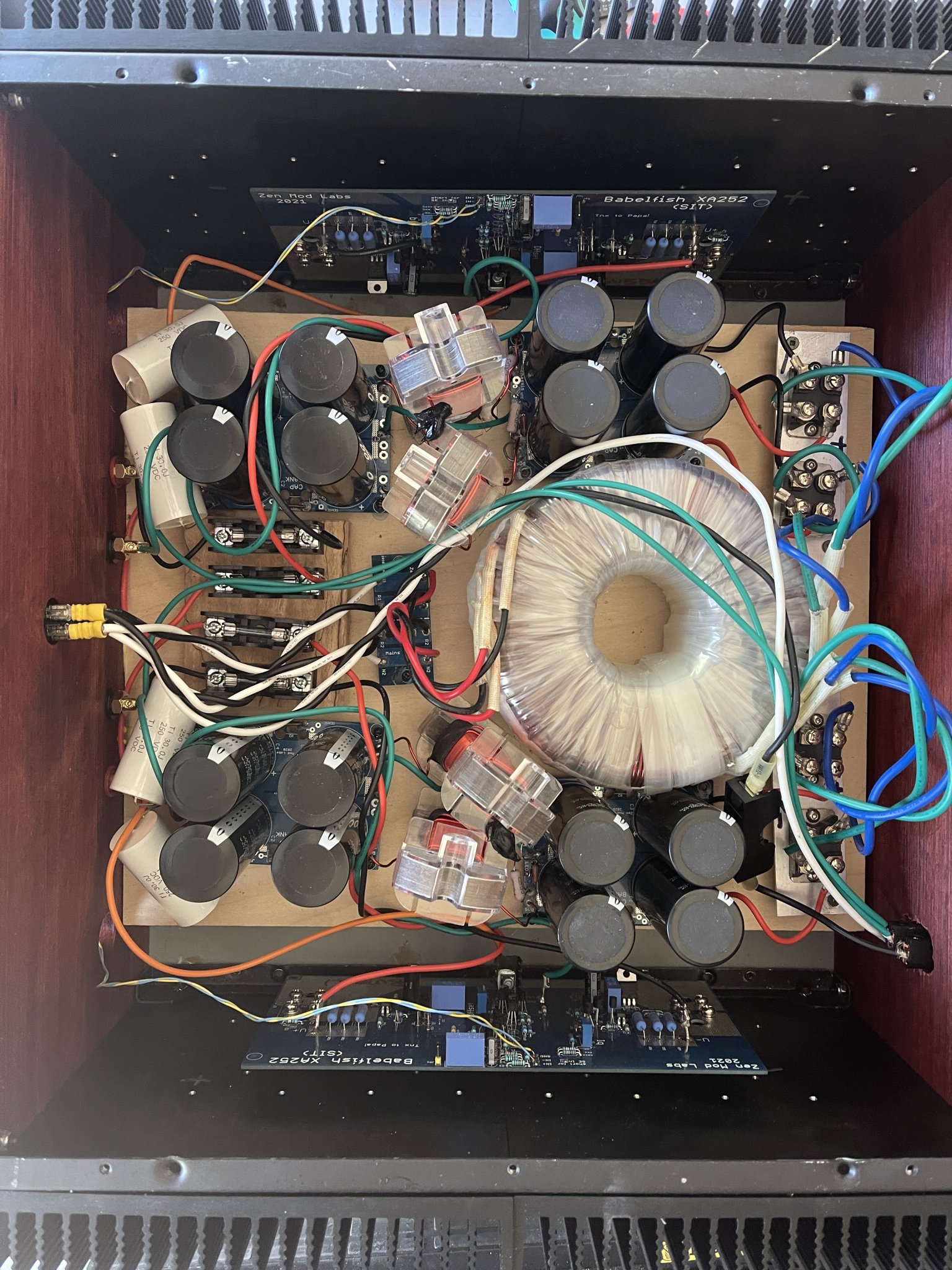

For a "stereo" PSU (500 VA transformer @2x20V, 66k uF - choke - 66k uF in each leg) I have used a 159ZL for each rail.
In my dual-mono build with 2 x 400 VA @2x20V transformers, I thought four 159ZL would be too big for my 5U/400 case. Here, I used four 156B (1.5 mH, 5A, 0.07R DC).
I always wanted to go with a very low DC R and get the filtering action from the inductance, to get a low PSU impedance.
All amps I have tried in the dual mono case (currently a SissySIT R3) are dead silent on my 100dB/W speakers. I have 66k uF - choke - 66k uF in each rail (512k uF total in the amp), plus a motor run in each rail as icing on the cake.
Best regards, Claas

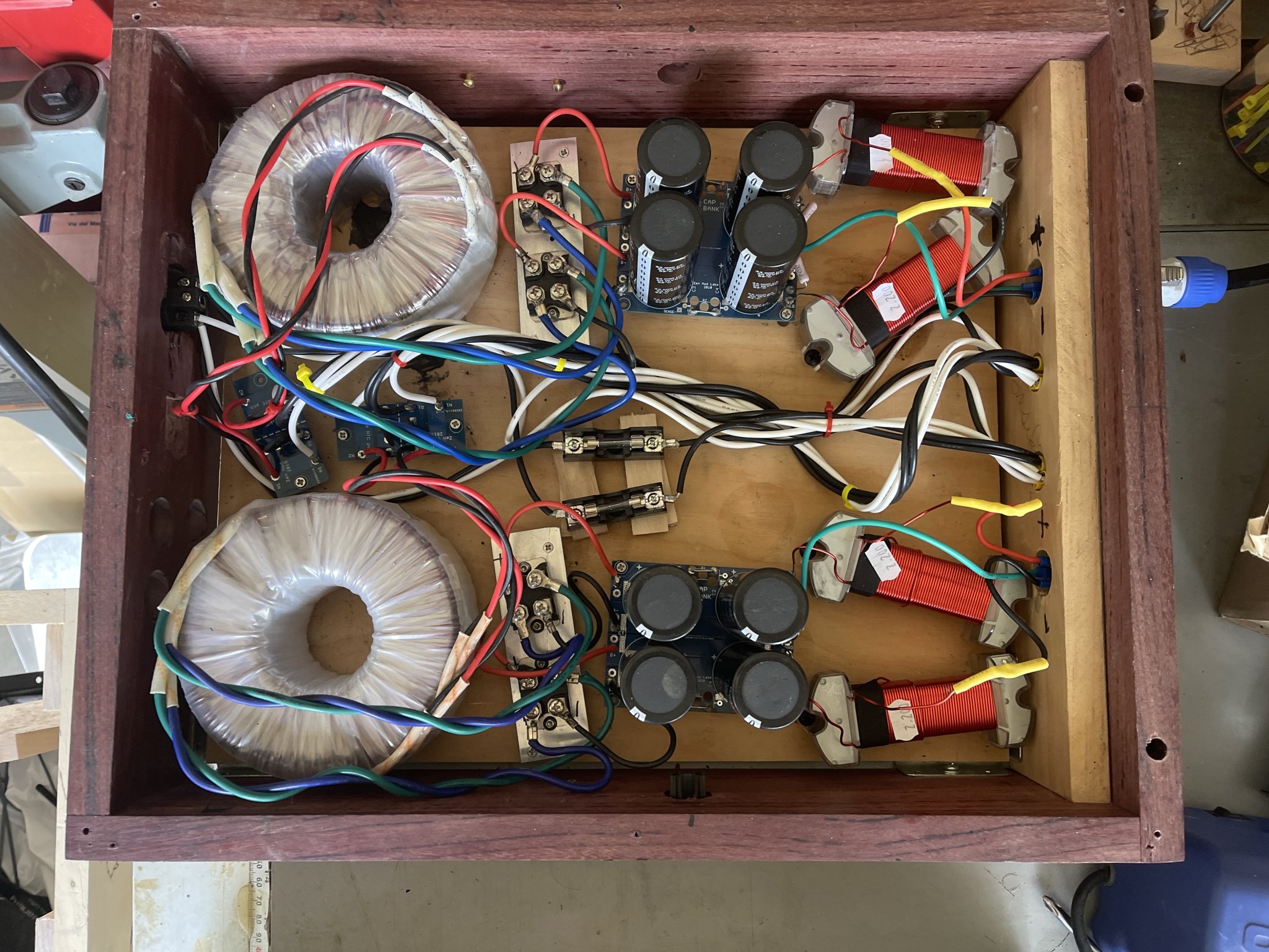

Best regards, Claas

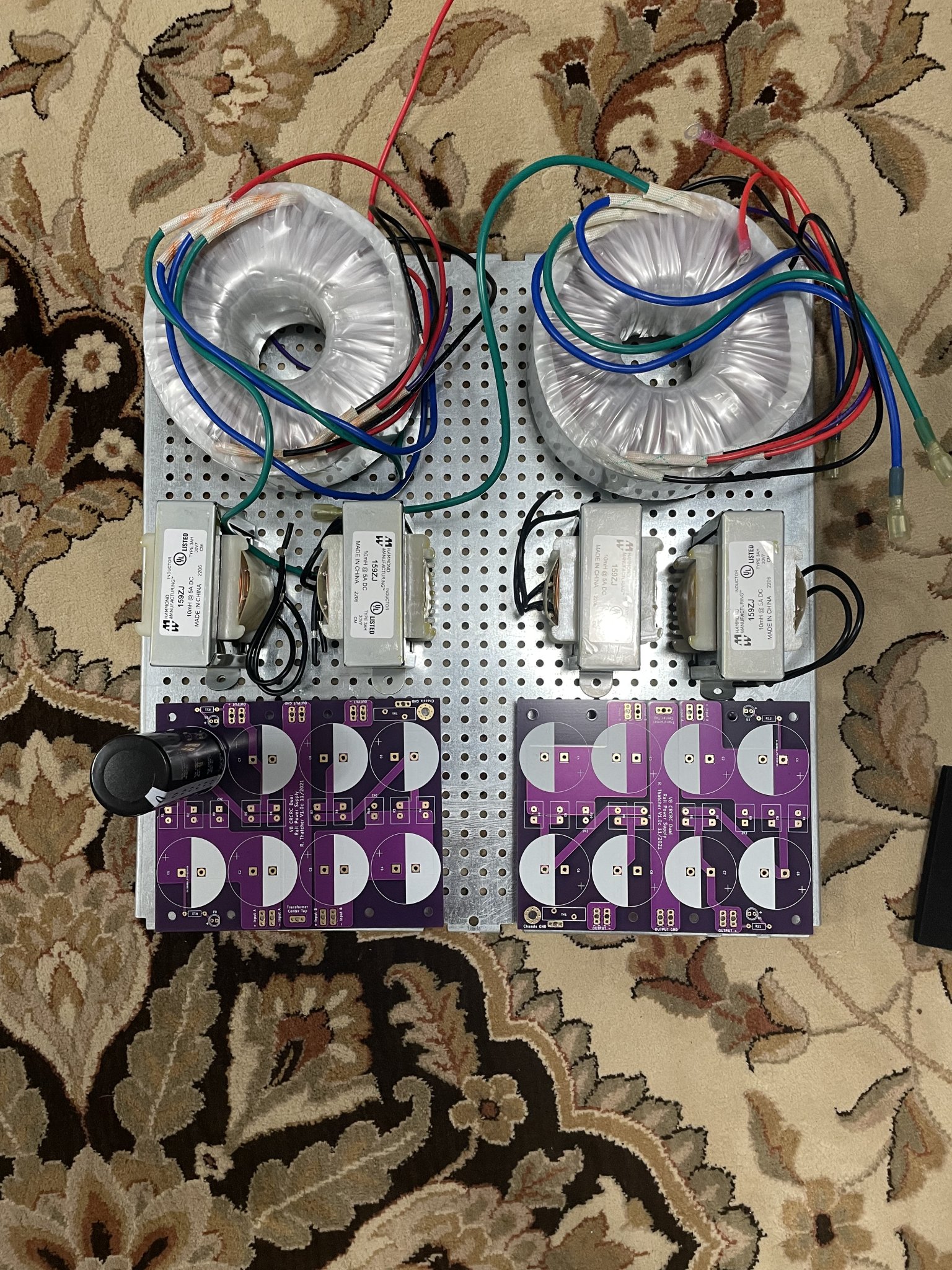

Still a work in progress.
if possible. mount cap banks on top of chokes (long distancers to bottom plate)
much easier everything if you have more floor space in case
^ Agreed. Sadly, Chokes are ~ 67mm and caps are ~82mm tall. With little fudge + base plate etc...
So, unless I use a 5U chassis... no bueno. I like the 5U Pesante, and I used similar 3U for balanced Iron Pre. I really wanted to use 3U, but will likely use 4U for PSU. I can re-design PSU boards and get new shorter / fatter caps, but I already had these parts. I have 5U, 4U, and 3U for comparisons with baseplates for test fitting...

Just for your awareness, I shoehorned my separate dual mono CLC in a Galaxy 3U (330 x 280), so Pesante 400 should be quite roomy.
Could you rotate the filter caps boards so the long caps are horizontal?

Very nice! You need some floor space for rectifiers 😉
wires up, so you can read label from bird perspective......so they are closer to the ground plane chassis?
