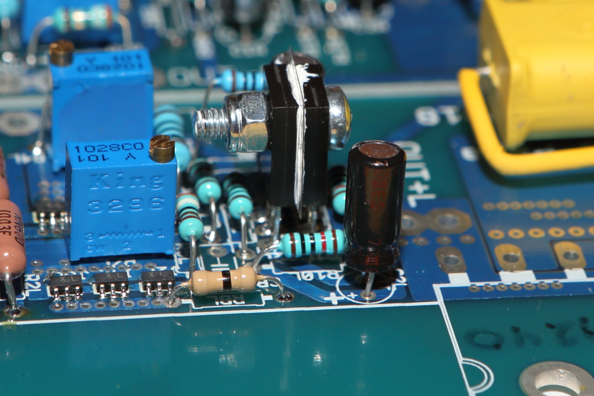

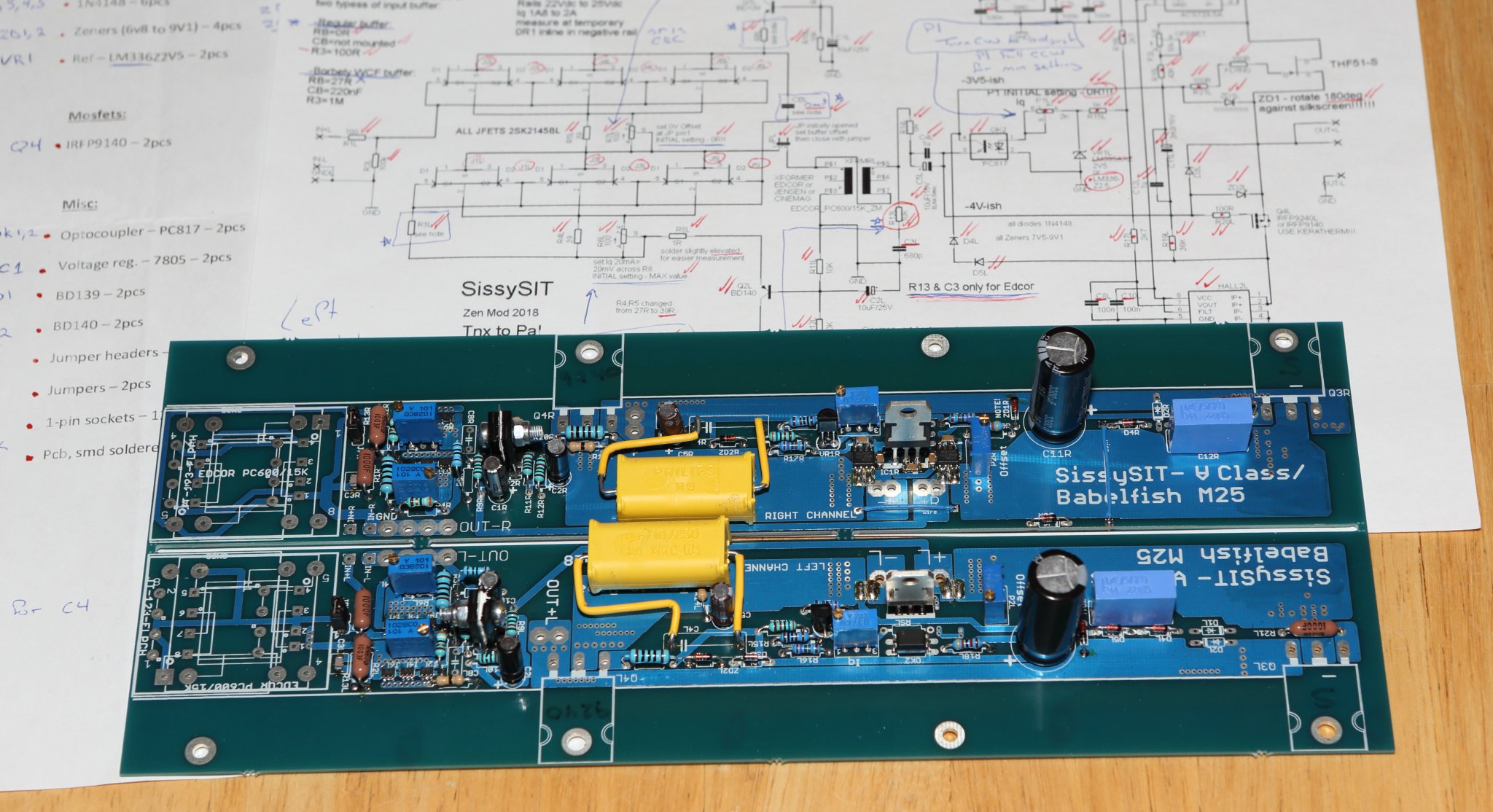

I'm building the SissySIT, so I omitted D1, D2, RS, R13, and CB. ZD1 is installed backwards. Q1 & Q2 are installed back to back with a mica insulator and grease and tested for electrical insulation before installation. P1 adjusted and measured in situ for min initial setting. P2 pot adjusted for middle setting. R6 pot was adjusted and measured for max setting. R7 pot adjusted and measured in situ for min setting. 100R flying resistor mounted to gate pin of SITs. R8 mounted tall for easy measurement. I happened to have a few big yellow film caps sitting in my box that were the right value, so these went in the C4 position. SITs matched at -3.37v from Pras. 9240 devices from Zen marked at -4.2v.
Final board carefully inspected front and back for inadvertent solder bridges by scraping around all pads with a micro screwdriver with a bright light and magnifier. No cold solder joints and all pads completely covered with solder.
Just waiting on PSU and signal transformers now. Looking forward to hearing it! Thanks for the kit, ZM!
Need to map things out and see if I have room for CLC or if I'll just use CRC. Build will be a dual mono PSU in single chassis.

Eric,
It looks like you are using the original SissySIT boards. If so you may want to consider implementing the Darlington Opt to prevent Iq is creeping.
twitchie posted a good step by step on how he implemented it. I used this post for mine implementation and it worked.

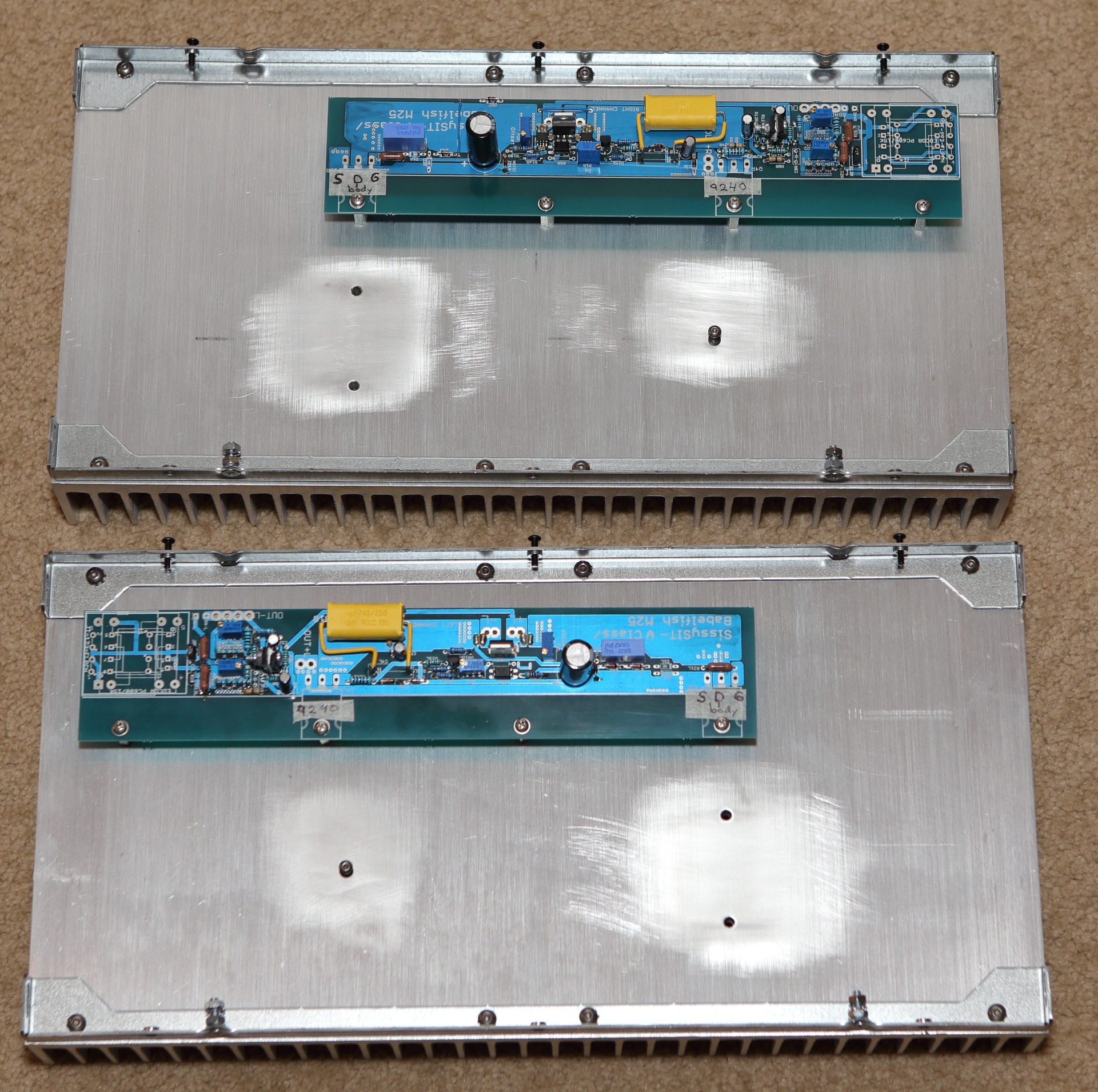

Here is my proposed layout for the boards and transistors on the sink. Sink is 200mm tall and 400mm wide, fins are 4mm deep, and base plate is 10mm thick. Transistors are symmetrically placed side to side and are 1/3 of the height of the sink. Brackets are from the DIYAudio store. I figured mounting the board a little higher on the sink would make it a little easier to adjust the pots once the center of the amp is filled with a dual-mono PSU. PSU traffo will be on the left side, closest to the SIT and furthest away from the Cinemag transformers that I have on order.
Any recommendations or advice on adjusting this mounting layout before I start drilling holes? Thanks!

Drilled and tapped a few holes yesterday. Chassis brackets and PCBs test fitted. The back of the sink is pretty heavily grooved, so I sanded some smooth landing pads for the output transistors. Power supply will use discrete diodes bolted to the bottom plate. I'm likely to build a CLC, but not sure yet. Have to wait to have everything in hand to see how much room things will take up and decide on a layout. Front and rear panels are likely to be wooden, I have some nice pieces of figured Walnut that have been laying around waiting for a good project. I'm not sure if I'll leave the sinks in natural aluminum or give them a light coat of black paint.

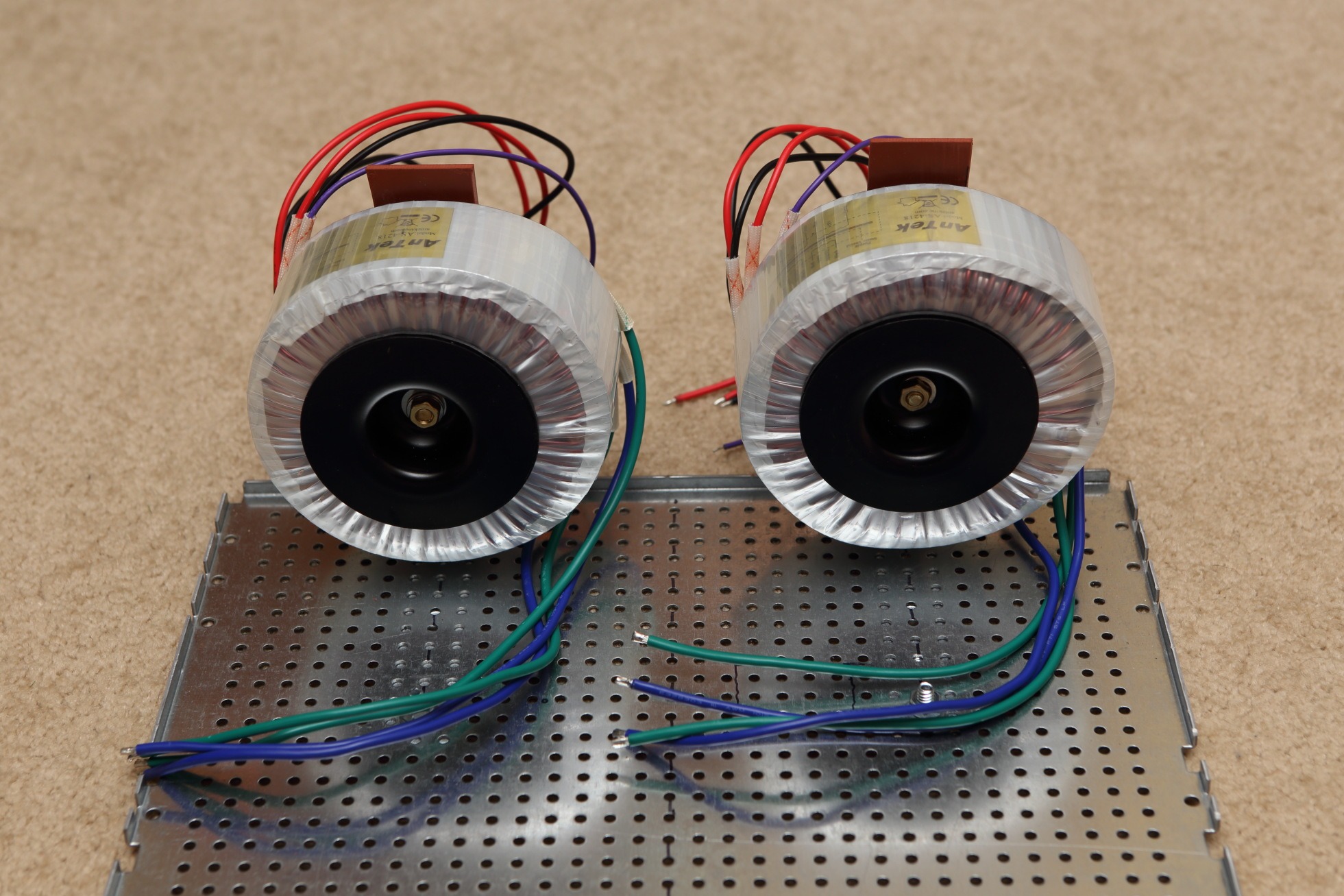

Antek goodies arrived (400VA with 18v secondaries). 300VA still not in stock and I figured the 400VA would sag less with the load, keeping the PSU closer to the recommended 22.5V or a little more.
Am I asking for trouble by aiming the center axis of the transformer directly at the Cinemag transformers? I mounted them with a brass center bolt. I was trying to preserve extra space on the chassis floor for a potential CLC by standing the transformers on edge, but I'm thinking this arrangement with the power transformers might be inviting trouble elsewhere. Any thoughts? Thanks!

Hi Eric,
I have 2 x 400 VA Toroidy transformers mounted at the front of my case exactly in the way you're proposing to mount the transformers, and the Cinemags at the back.
Totally silent. Even on 100 dB/W speakers.

Awesome! Thanks, guys! Glad to know I’m not inviting problems, especially because I won’t be able to tell until after all of the work is done…
