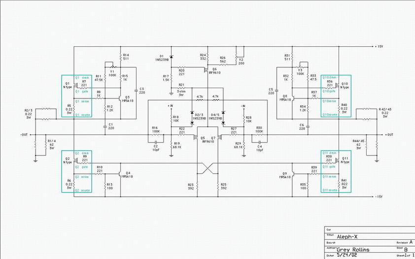

ANALOG GUY said:My next project is 2N5462 instead of 2sj109BL.
I can't find anymore 2SJ109BL from my country, if I want to use +/- 15V power supply rails as ALEPHX how do I set CCS and OUTPUT CURRENT ?
tnx

just to be clear-you wanna make Aleph X with 2N5462 in input?
I can't reply ,just because that is little unclear (at least for my brain) 😉

I said about 2N5462 instead of 2SJ109 in BABBELFISH J
Could anyone post ALEPH J 30WPC (NEW ALEPH3) schematic ?
tnx
analog guy
tnx
analog guy

2N5462 looks promising....voltage-wise even better than 2SJ109
just be sure that you match them tight and they are thermally coupled-little blob of thermal paste between them and sort of wire ring to keep them together
