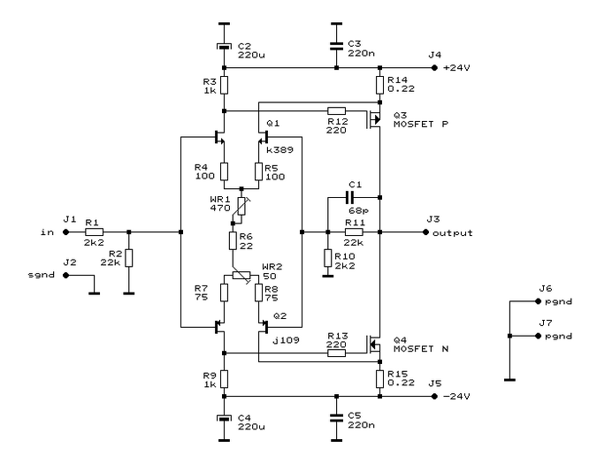

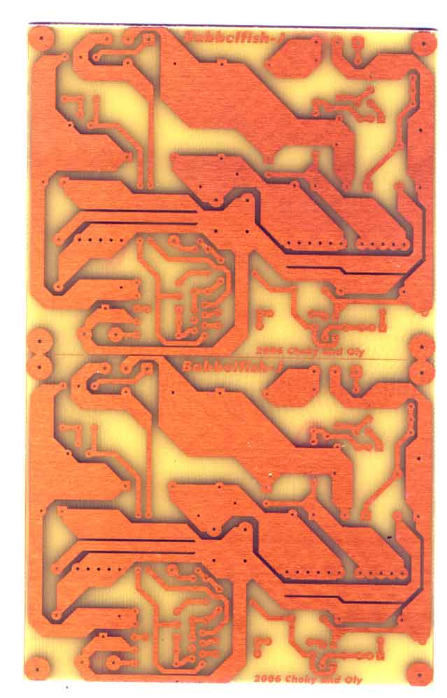

steenoe said:Nice boards, Choky. Any chance to see the schematic of that minimalist symmetric amp?
Steen🙂
http://www.diyaudio.com/forums/showthread.php?postid=867473#post867473
Thanks. That is simplicity, indeed.here it is:
Only problem is the 2SJ109's, seems like noone has them. At least Dalbani and Schuro are out of stock.

Hi Steen! I am Oly
You can try with single fets instead of doubles k389/j109:
2sk170/2sj74 or 2sk246/2sj103
Only penality is maybe is little temperature unstability or drift.
Yes, 2sj109 is difficult to find... 😕
Oliver 🙂

- Babbelfish J PCBs
