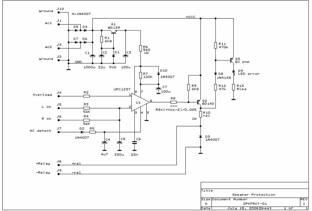

Unrelated question:
Would a zener based CCS for input pair lower the turn off thump?
Unrelated question:

two bjt CCS have pretty nice tempco , and that is important for achieving lesser initial offset...........
besides that- thump isn't big really?
anyway- use spk protection with delay,so thump can't be problem
I must confess that I'm paranoic regarding my spks
The turn ON thump is hardly noticable, but the OFF thump is louder. I don't know of any universal reference I can compare it to.
I have been thinking about speaker protection too, perhaps I should surf the forum for a nice solution.

I think I'll mod it for some ta7317p I have in the drawer....

you can always buy few mosfets and resistors,if something goes south.....but if you have rare ,or just expensive, speakers ......going south is major trouble .
because of this,I know that I'm right 😉
I tried this schmtc on breadboard . pcbs are in drawer (Oly is magician,as always) ,but I'm kinda short with time.
