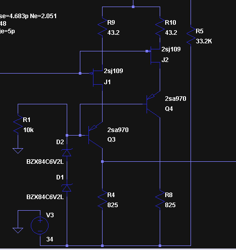

Lovan said:So what would one do to make these work with +/- 35V?
cascode 2SJ109
or put enough leds in each drain to burn 10V
or put few small zeners
Lovan said:shouldn't that be 20V?
now is +/- 25 max
you want +/-35
difference is twice 10 V
I meant-burn at least 10 V in drain's side ;
but-no more than 15
Now the thread has turned from fish to jfet voltage, I was wondering if anyone have tried cheaper/easier to get jfets?
What is the transconductance requirement for babbling? A good (high idss) pair 2n5462 should be possible to get, but the transconductance is only 2-8mS whilst the 2sj109 and 2sj74 claim to have 22mS typically... what would be lost in this circuit with the low transconductance?
(The 2n5462 can work with higher voltages).
The 2sj108 which papa uses for F4 offers good transconductance but 5V less than 2sj109, so it would be working in the red zone in a babbelfish...
How about wiring a couple of 2n5462 in parallel?

I'm working something on that ........finding easy solution ,or sub.....eevn in case that you must buy -say-100 pieces for 30-40 Euros,and match them ....you can always find good use for several matched pairs or whatever . but I can't promise that I'll have my final conclusions faster than a month
even two jfets -meaning two pairs instead of one SJ 109 isn't wrong solution ; in toob world you can often find two triode systems within one envelope paralleled

Regarding the J-fets, I dont think its unconditionally wise to use the cheapo's. It has often been said that for audio purposes, the Toshiba's rule. One way around the J-fet problem would be if we stick our heads together and invest in 1000 pcs of the 2sk370 and 2sj108 wich is still available from Toshiba. Any interest?
I'm very curious how papa is using the jfets in aleph j, but in babbelfish, I think you need every volt accepted by 2sj109. The 2sj108 only withstands 25V, so you don't have much headroom...
casscoding it is not a major crime........still...........

Not pretty... could running the j109 Vds at -10v permit a higher bias?
