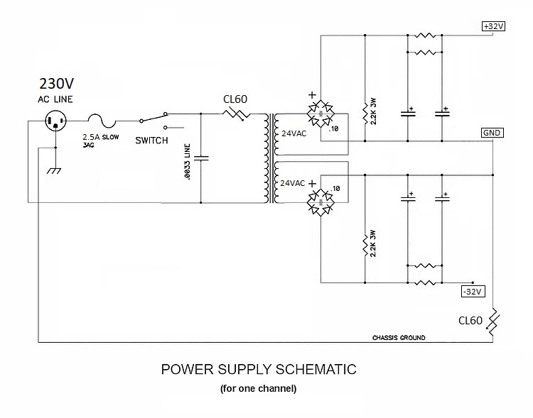

Regarding the NTCs for inrush current duty:
The CL-60s are tough, but as everything they have their limit. And everybody has to decide how much risk he can see with failing electric devices he himself build (risk for the people close to you, risk of fire, the insurance, ...)
In the old CL-60 datasheet, and also the new, I can't find the data for the maximum recommended energy rating in Joule. We know that many Pass amps use it (the bigger ones don't), and many diyers use it, too.
The energy the thermistors have to withstand can be calculated this way:
E = 0.5 * C * V².
I would have a look at other datasheets, compare the diameter, thickness and resistance, add a safety margin, and decide what my CL-60s will take for years.
If I had a bigger power supply (I have), then I would look for something different. A big guy for example is Amtherm's MS32 50006-L. It can take repeatedly 250 Joules.
Just a short anecdote:
When I switched on my amp after a moving, I saw some magic dust. 😱 What I found was very unlikely, because of 3 CL-60 thermistors (and of cause a complete F4) the CL-60 broke which was used as the ground breaker between the audio ground and chassis ground. After replacing it, the amp works completely normal. So, even if this CL-60 was WAY overspecced for this duty (as per schematic of Firstwatt Amps), it is normal that everything can fail in reality, if (ab)used or not.

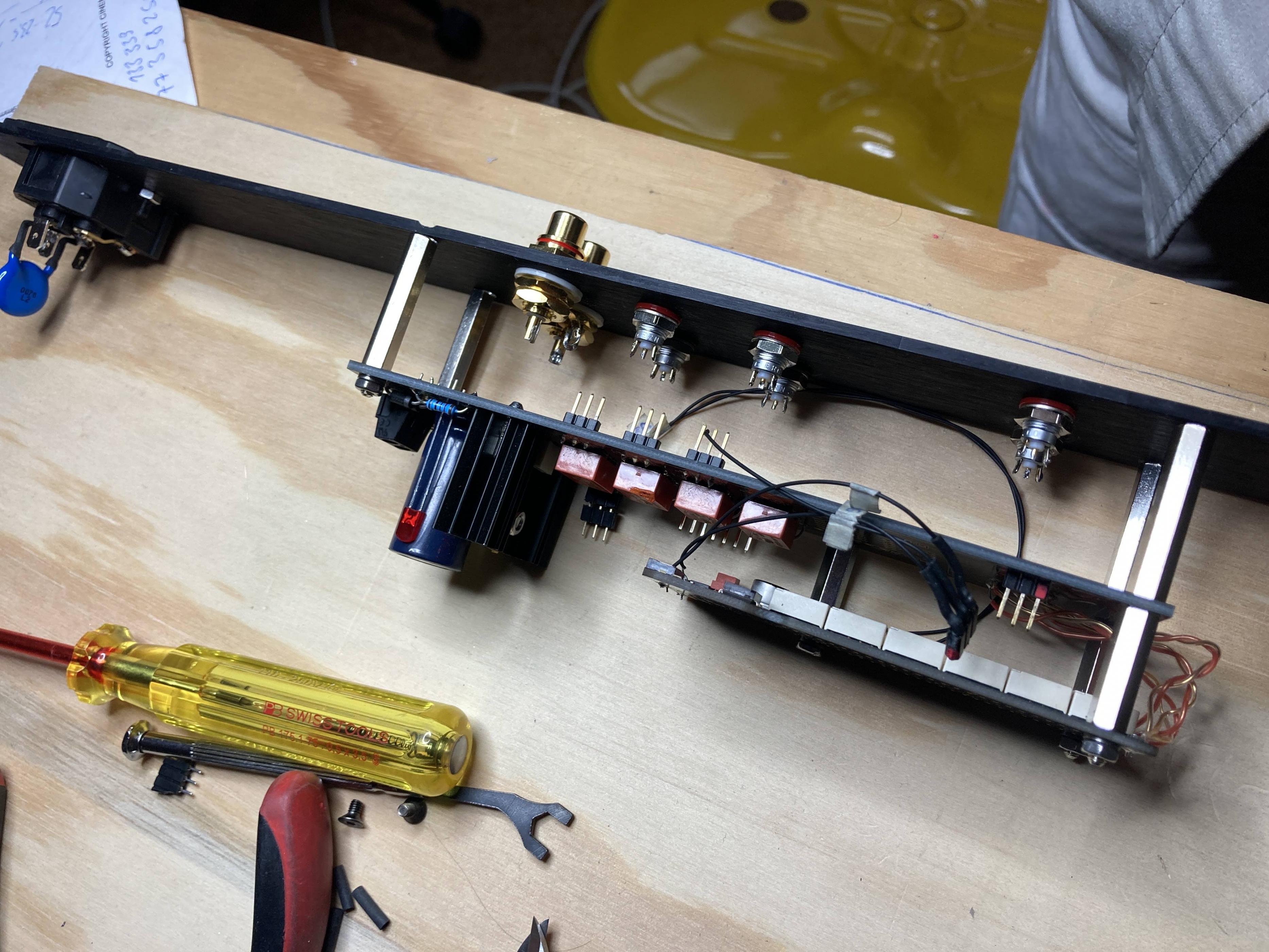

How is your WLS coming along? . 4 JFETs in.
Veeery slowly.
Taking care of what was done the sloppy way, approaching significant steps (reconnect, test, etc.)
New back-plate: image-2021-05-11-17:21:45-679.jpg

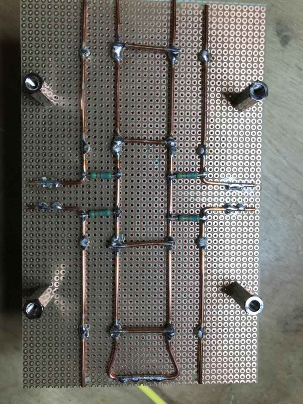

And here are some pictures of my PSU construction. It is not truly "p2p", because I built it on perf board (fibreglass, not resin paper, because of the heavy caps).
I first did the layout for the caps, the connectors for the chokes, and the wire attachment points, and drilled holes for the snap-in cap terminals, etc.
Connections underneath are done via pieces of 2.5 mm^2 solid copper wire (from house installation cable; about 13 AWG). The caps are secured by the solderjoints on the underside; when I'm finished I also like to secure the caps from above with hot melt glue in between them, but that's mostly for vibration damping.

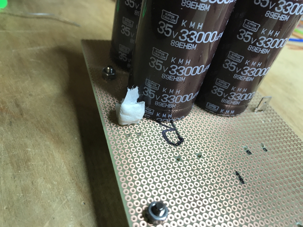

Small trick: In one of the pictures you can see a piece of tissue wrapped around one of the spades. I often had the issue that when soldering spades from the underside, solder would wick up the spade and spoil the blade ... just wrapping some tissue around before soldering prevents this.

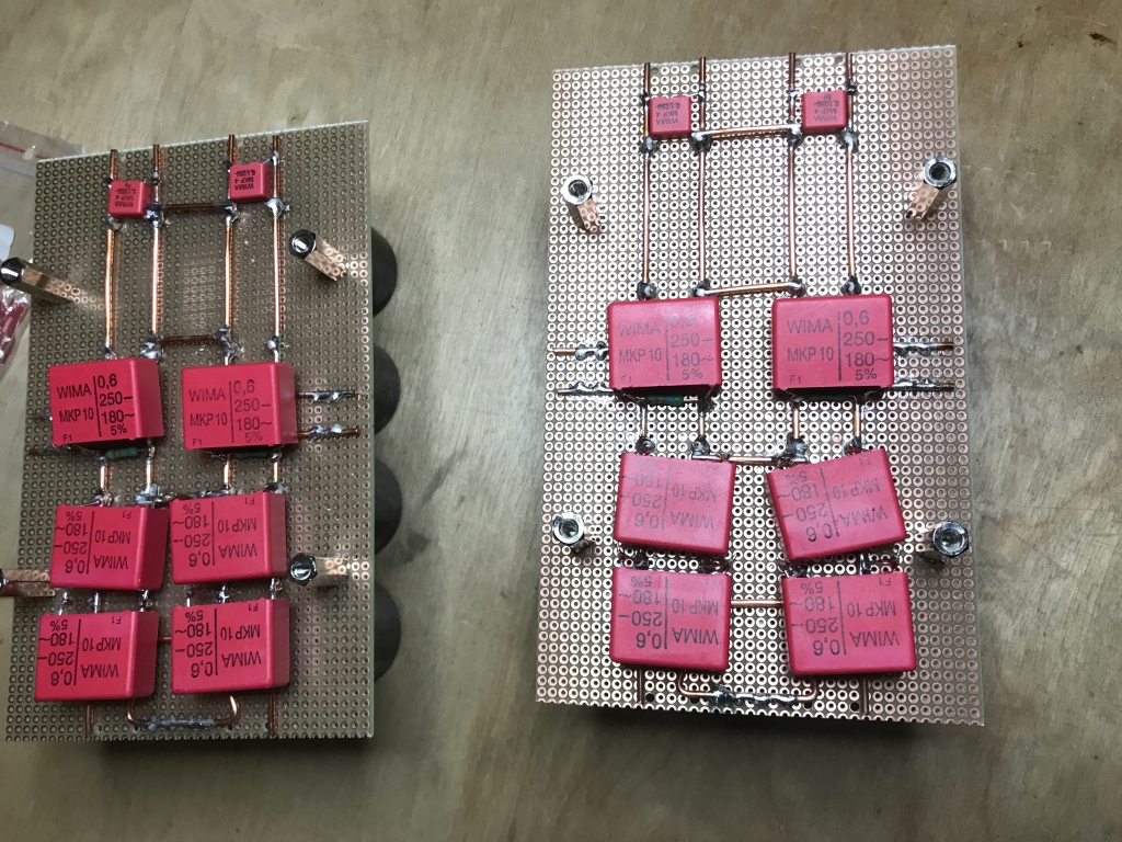

And finally, some bypass film caps for superstition ... 😀
I used spades / quick disconnects for the chokes. Raw DC wires from the rectifiers are soldered in, because these get disconnects at the rectifier bridges.The same goes for the rails - soldered in at the PSU board, because those get their disconnects at the motor run caps.

Chede, your PSU looks absolutely completely utterly fugly!
A couple of your design choices I want to ask you about, just for enlightenment.
1: I have chosen to decouple only the last set of caps before the amp boards, meaning the 100kuF’s. What was the reason you chose to decouple them all? Should I too?
2: You have made ground links across all caps. I am planning to only make one link, between the last set of caps. I am planning of cutting an aluminium triangle there, you know, 1980’s Krell+Choky style. This choice is a result of some discussion and reading this winter, with amongst others Bonsai. But I am open to try different things.

I'm also thinking about CL60 capacity and soft start circuit...
I'm starting to build a BA-3 (complementary bias) dual mono (one chassis),
with two 600VA 2x24V transformers and two CRC filters C=0,56F each channel ~1.12 Farad total.
I am aware this is absolutly oversized and not necessary but I quite like oversize PSU.
I am concerned about CL60, can I still use this circuit (avoiding fire)?
Hi Andy,
To question 2:
I built these PSUs two years ago for my SissySIT. That was before the discussion became widespread about connecting the grounds of the two rails only in one spot, on the clean side of the PSU. So I didn't take that into account and wanted only to make a ground connection as solid as I could, so I used multiple connections. The "clean" side is where you can see the "U", where I bent the ground wire around uninterrupted.
I have used this double-mono PSU now with two different amps - SissySIT and F4 with higher bias current. Both are absolutely silent over my 100 dB/W Jericho Horns - absolutely nothing, the most silent amps I have built so far. 😎
So in my case, having more than one connection between the grounds of the positive and negative rail hasn't hurt, it seems. 😛
To question 1:
I already called the additional film caps "superstition" in my original post 😉.
I just had the WIMAs lying around and needed to make use of the real estate on the bottom of the board, so I put as many in as would fit in convenient spots. If bypassing would bring real benefits, it should benefit also if bypassing caps earlier in the chain, or not ? 😉 Aah, and then there are the four Motor Run caps between PSUs and amp boards ... :wiz:
At the input to the PSU from the diode bridges, I put a small film cap across. This is meant to be helping to quiet switching noise, if the diode bridges would have that ... probably more effective if attached directly at the pins of the bridge - somewhere around here I have seen a small PCB exactly for that.
