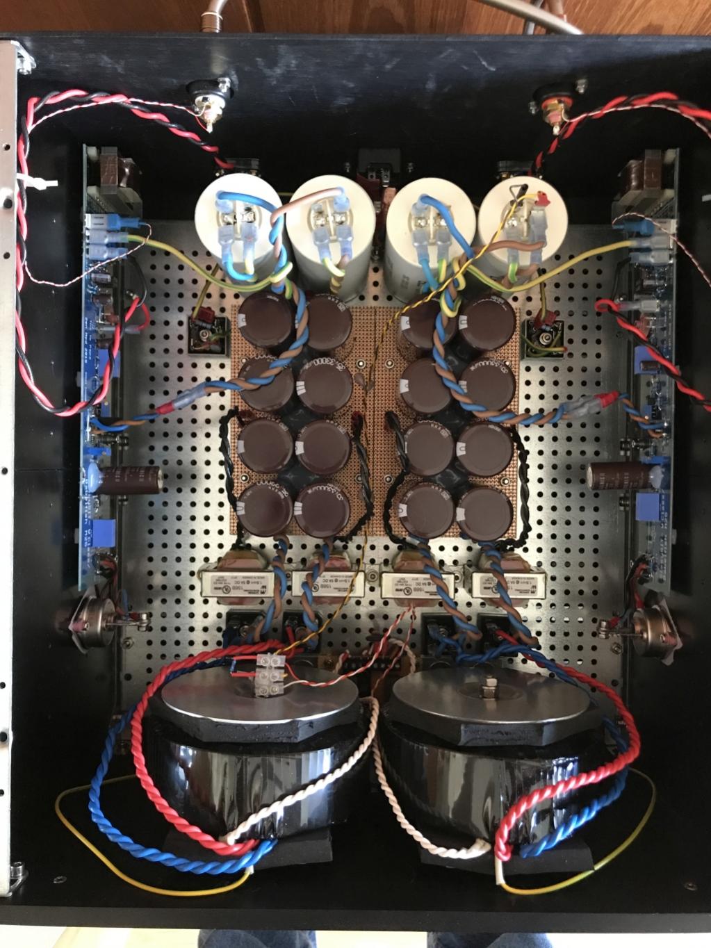

For what it's worth, another data point regarding soft starting:
I have a dual-mono PSU, 400 VA transformer, 264,000 uF.
So, together 2x 400 VA transformer, 528 mF capacitance. That's not 0.8F, but still a good 0.5F.
I have run this PSU for my F4 and SissySIT so far.
I am using just a single CL-60 for the whole amp. 230V mains, 2A mains fuse.
Works perfectly for more than 2 years now. :D
Regards, Claas

That is very, very good news, Claas. Thank you for sharing both your experience and the pic of a beautiful amp. Kudos!
I was actually contemplating doing the connections under the trannies up front, just like you. If so I was planning on using two CL-60s, one per PSU/channel.
I was under the impression that I have to use one fuse per mono PSU, and have parts for that. But it does complicate things a tad. Could you please share your view on the subject?

Hi Andy,
- on the CL-60: I purposefully used just one CL-60, so that it has enough current running through it when the amp is operating in steady-state (about 1 A). That way, it heats up properly and has less voltage loss. If the one CL-60 wouldn't withstand the inrush current, I would use one per transformer ...
- regarding the fuses: for ease-of-use purposes, I use the one fuse that the IEC inlet caters for. I like my fuses close-rated; if a fuse blows every couple months on switch-on, I consider it correctly sized :p.
However, in addition to that, I have two more fuses, between distribution block and transformers (everything mounted on a small perf board between the two transformers).
Zen Mod always advises to fuse each mono PSU side separately, and I agree that it provides better protection to the components in the case of a short in one of the channels. I don't remember exactly, but I think I have 1.6A fuses for the two mono sides.
It would be a pain to change these for the occasional fuse-blow, because I would have to open up the amp. So I choose for my "primary" fuse in the IEC inlet a closer-rated 2A one, so that that one would blow on inrush. Has worked perfectly the last two years so far :D
Regards, Claas

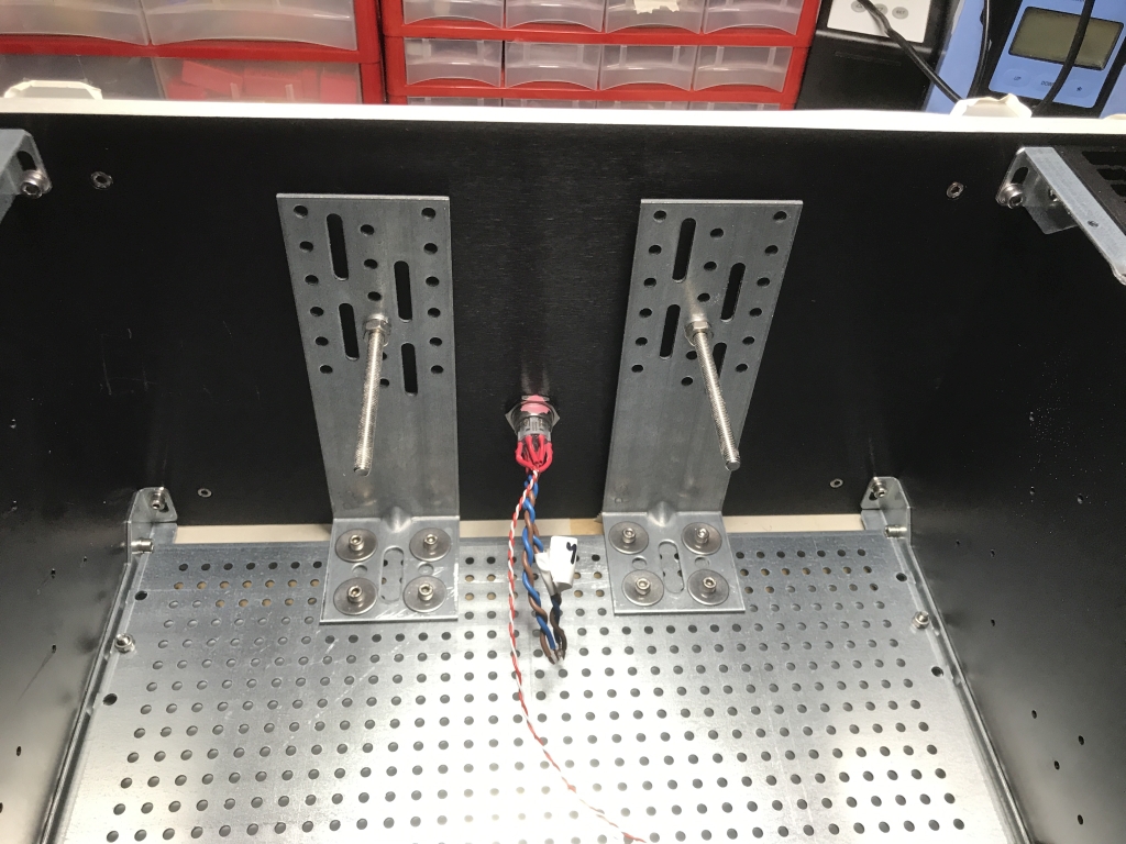

Explained mounting technique for those trannies would also be lovely. I have rise panels, but prolly need to weld the bolt to their underside. Plus they take up space. Would love to avoid them.
Andy

Lovely, really lovely. I am on the lookout for such perfboards or the likes, as I want to solder as much as possible. Avoiding distribution blocks completely, is also sort of a goal since we are dealing with 230Vac. Kinda feels.... safer, guaranteed reliable.
I have i my boxes Littelfuse panelmount fuses, plan was to put them in the rear panel. I do have long primary wires, so with a bit of luck I can make my connections all down by the inlet. But doing them by the chassis front has it’s advantages too. Like less wire chaos right under the inlet, and also the front end which will be at the back.
Did you cut that perfboard yourself or did it come in that size?
BTW: my steady state will be approx 1 amp as well. Like the idea of letting the thermistor work.

OK, last one before going to bed ... :)
attachment.php
Steel angles from Bauhaus (local hardware store). Not attached to front panel. Transformers are Toroidy audio grade, they come with resin-filled center with just a bore. Neoprene sheets on "top" and "bottom" of transformer; using the mounting disk that comes with the transformer. To give it a bit more stability, I wedge a piece of neoprene between the angle iron and the front panel, and between the transformer and the bottom plate - gives some tension on the angle iron.
Regards, Claas

Hah! Really really nice. I actually think I have some suitable angles from the local hardware shop. If not, we too have Bauhaus. Jeez, why complicate matters. KISS should be my slogan, got burnt many times allready complicating things.
I believe I will do just that!
Going to bed too. Good night!
PS: After sleep, I would love a link to that front panel switch
