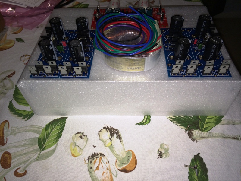

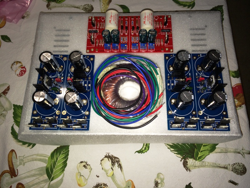

BA-3 As Preamp
Power supply is with C-R-C, regulator stage is with zener diode 4x6,2V and series transistor, or cap multiplier or LM317/337 reg. (PS with or without feedback)
Input selector is with 5 inputs, mute relay and 7 relays for attenuator. You can use pot like on picture. Relay attenuator and pot can be connected as classic or as shunt type.
Preamp section can use for BA3 unbalanced or balanced (two boards needed), for Uskok unbalanced or balanced, with one par 2sj74/2sk170 or two, with 2sj79/2sk216 or 2sj313/2sk2013 (different side of heatsink) or IRF610/9610.
This board dont have DC servo like Uskok. It was hard to make on one layer pcb.

I haven't finished the B3-pre yet, but I did get a chance to upgrade the MOX II active crossover from one power supply to dual. The change was significant. Better channel separation, solid imaging instrument placement, bit more depth and more bass. Not sure how dual power supplies improves bass response, but I assume the XO drives the amps with more ease.
Still using 1 transformer, but might eventually add another.
Preamps seem to respond well to power supply upgrades.
I recommend dual power supplies (one for each channel) for the B3-pre as well. I think it's worth the extra effort.

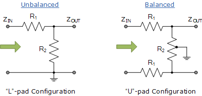

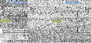

Can I add a resistor to the input or output on the B-3 to pad one channel a decibel or two? Anyone have any ideas for that? I'd rather not use a pot if possible.
