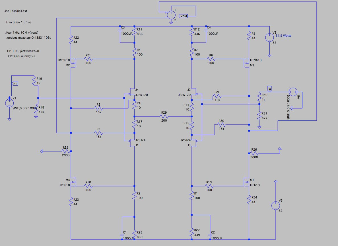

since it is originally designed to drive BA- power buffer amp I suppose that have more or less determined the supply voltage
but is it also optimal voltage for preamp use ?
and I better not ask how it would work if output mosfets were replaced by another jfet pair

if I build the BA-3 pre stage it would because I wanted the gain, and I might
but what is the point without the gain 😕 (just curious)

Any links to that?and I better not ask how it would work if output mosfets were replaced by another jfet pair
Any links to that?

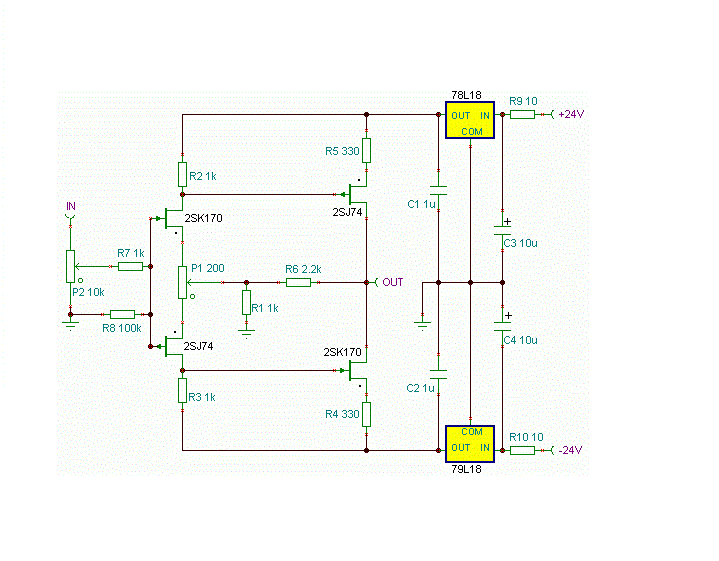

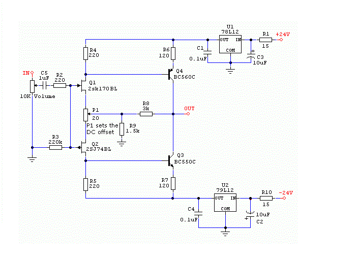

tricky(difficult)
but easy to just post the schematics 😀 hope that is ok
even if that's similar , it isn't anything like BA3 FE
and I'm pretty sure that Juma didn't wrote it is
no, he did not
and I never said he did
probably accidental mistake on my part when I asked for such a design, and suddenly remembered these curcuits by Juma
they are probably from a thread about 'alternative' preamps for F5 😉

pretty important virtue of BA3 FE is lack of overall feedback , while both of these stages are more like F5 , with feedback connected in more common manner
they're both great specimens , I'm just making distinction to BA3
