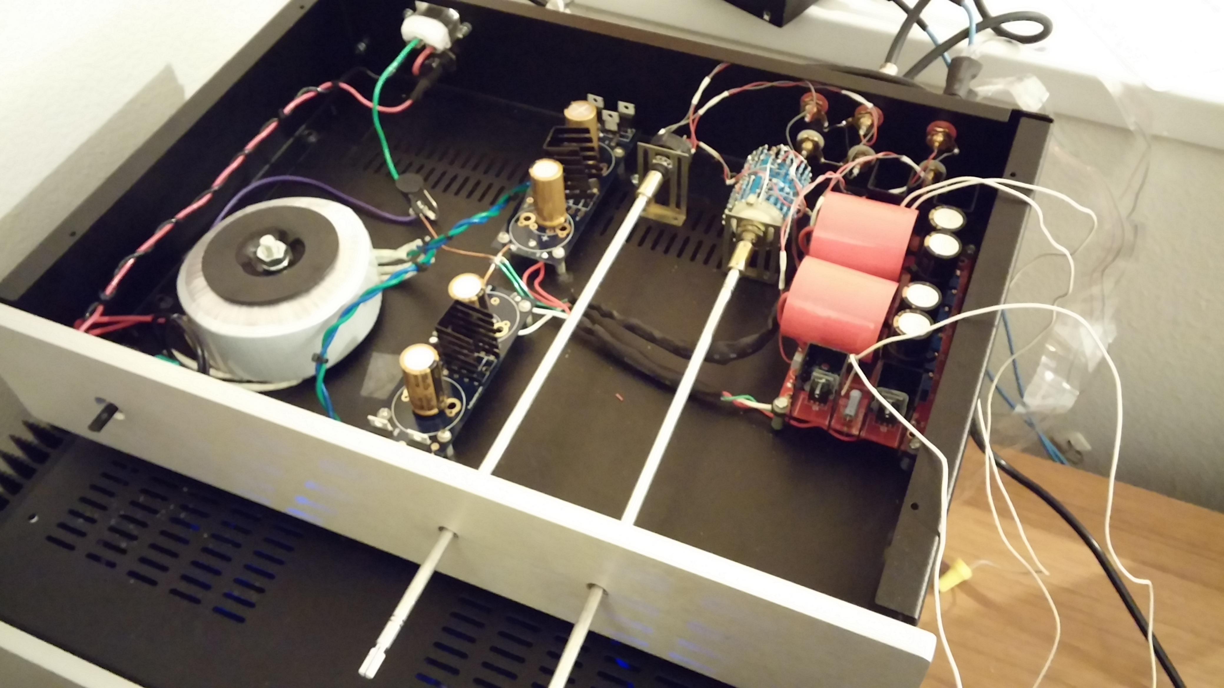

Hi delecoy,
congratulations to your decision about those builds
I am actually about to do the same, but I am still waiting for the BA-3 PCBs and some of the components to show up.
People tend to point to an Ernie Borbley paper about pot value, I think describing higher noise and a little bit narrower bandwith, by using higher value pots.
I have looked at the following two ways to do it (see picture), and think that number 2 must be the right one. As far as I remember Nelson used that principle on the B1 buffer also.
I have in mind to make mine as an integrated amp, and run the BA-3 from the same PSU as the F4.
The F4 will run nacked/crippled/liberated what ever people want to call it Which means without the input buffer.
From experience be very carefull to set the F4 pots to the right value at startup
Best regards

No.
The 2 version simply adds load to the output of the Pre.
It does not attenuate the excessive gain.
If you add a series resistor before the R2 then you create an extra stage of attenuation.
version 1 works as two stages of attenuation.
But why?
Why have so much gain that you have to install cascaded attenuation stages?
But why?
