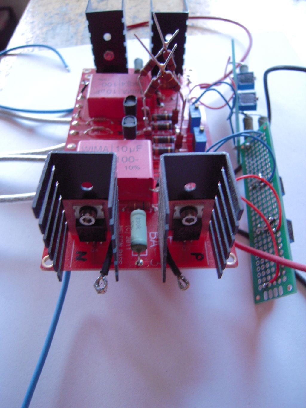

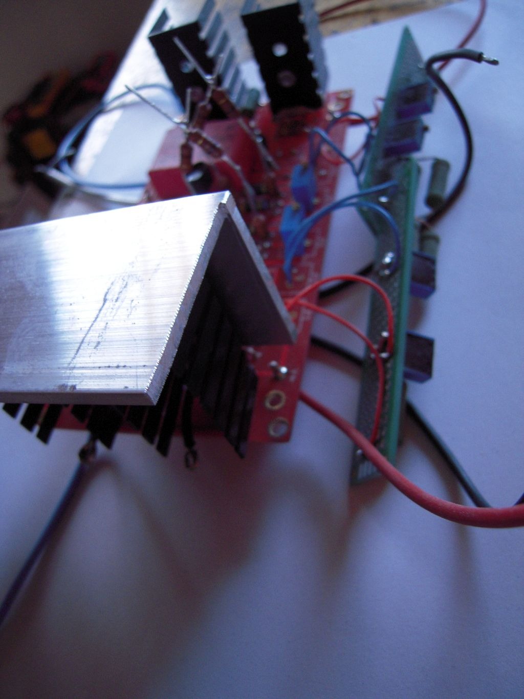

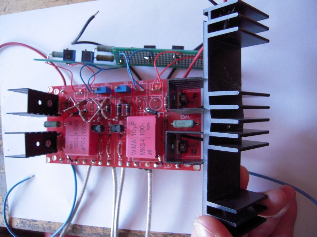

Hello Andy,
there is no 'supersmart' Cubicincher way. Why? Because Cubicincher isn't that smart!
When I run output-transistors in my preamps or driverboards the 'hot way', I often make my heatsinks on my own. Take a simple piece of aluminum (flatbar of ca. 2 - 3mm thickness / right angle bar). If I use a 90degree
aluminum angle, then I bore holes on the topside (the horizontal part), so that there is some better airflow.
Many options. Big surface of the aluminum heatsink and good airflow help.
Or you could mount the output-Mosfets to the case of your amp and put/solder the gate-resistor directly to the leg of the Mosfet and prolong with some short wires to the pcb?
Cheers
Dirk
