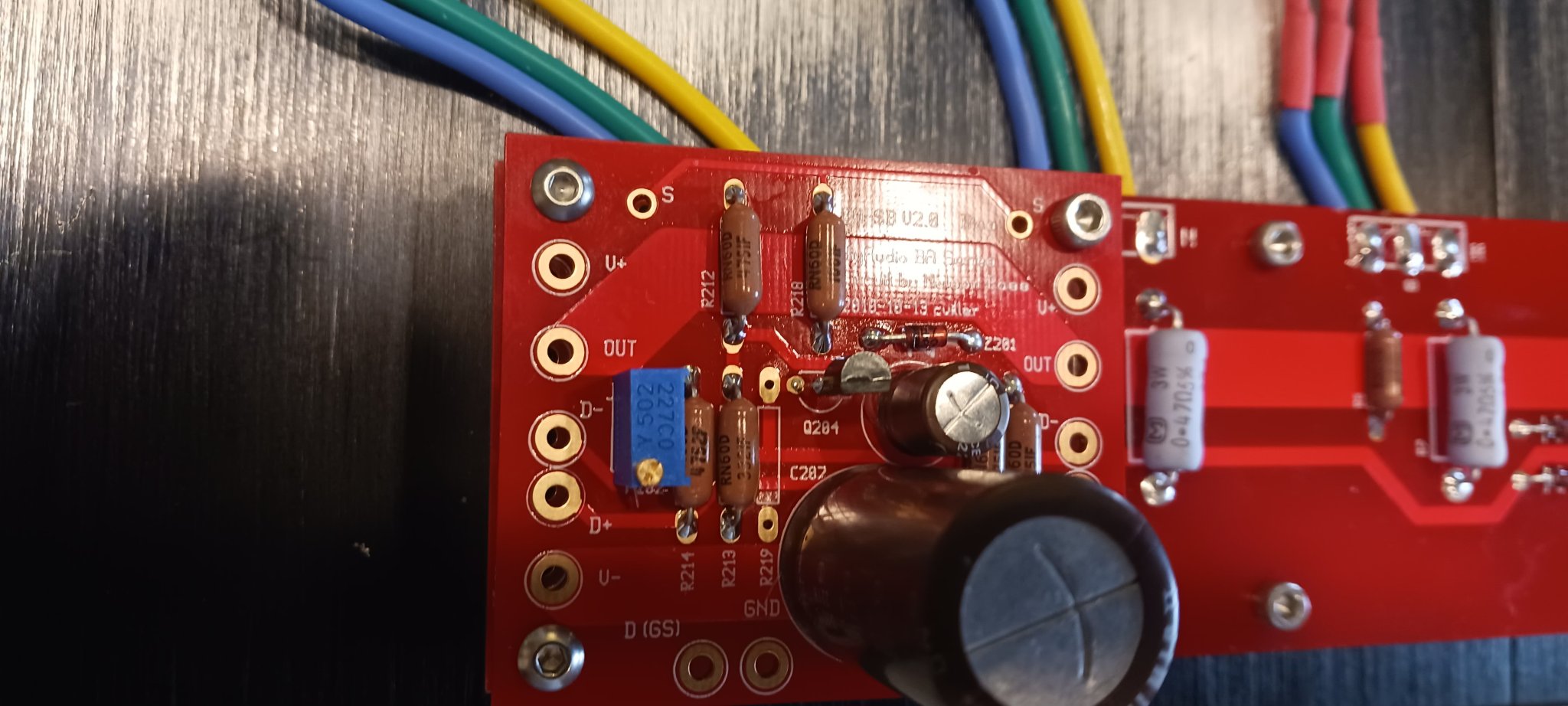

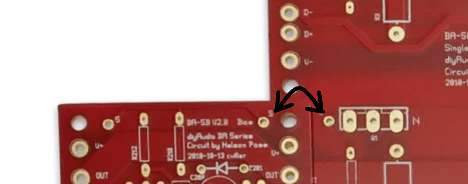

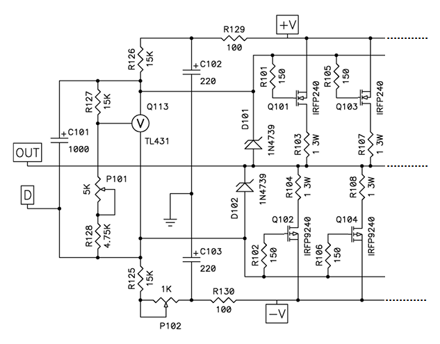

Building a BA-3 with the SE output boards. I'm a little confused with the hookups between the bias board and the output board. These boards have pads marked OUT and S. 6L6's pics show the push-pull boards only have the OUT pads which are joined. The schematic for the SE boards shows the S joined, but there is no reference to OUT. Which ones should be joined?
What I would do is...
  • Connect the 5 pads on one side with V+ through V- between the boards exactly as they are marked and aligned from the bias board to the output board.
  • Connect one S pad from bias board to output board similarly
6 connections.
I would not worry about a guide for a different amp... See BA-1 thread.
I'd get double confirmation.
