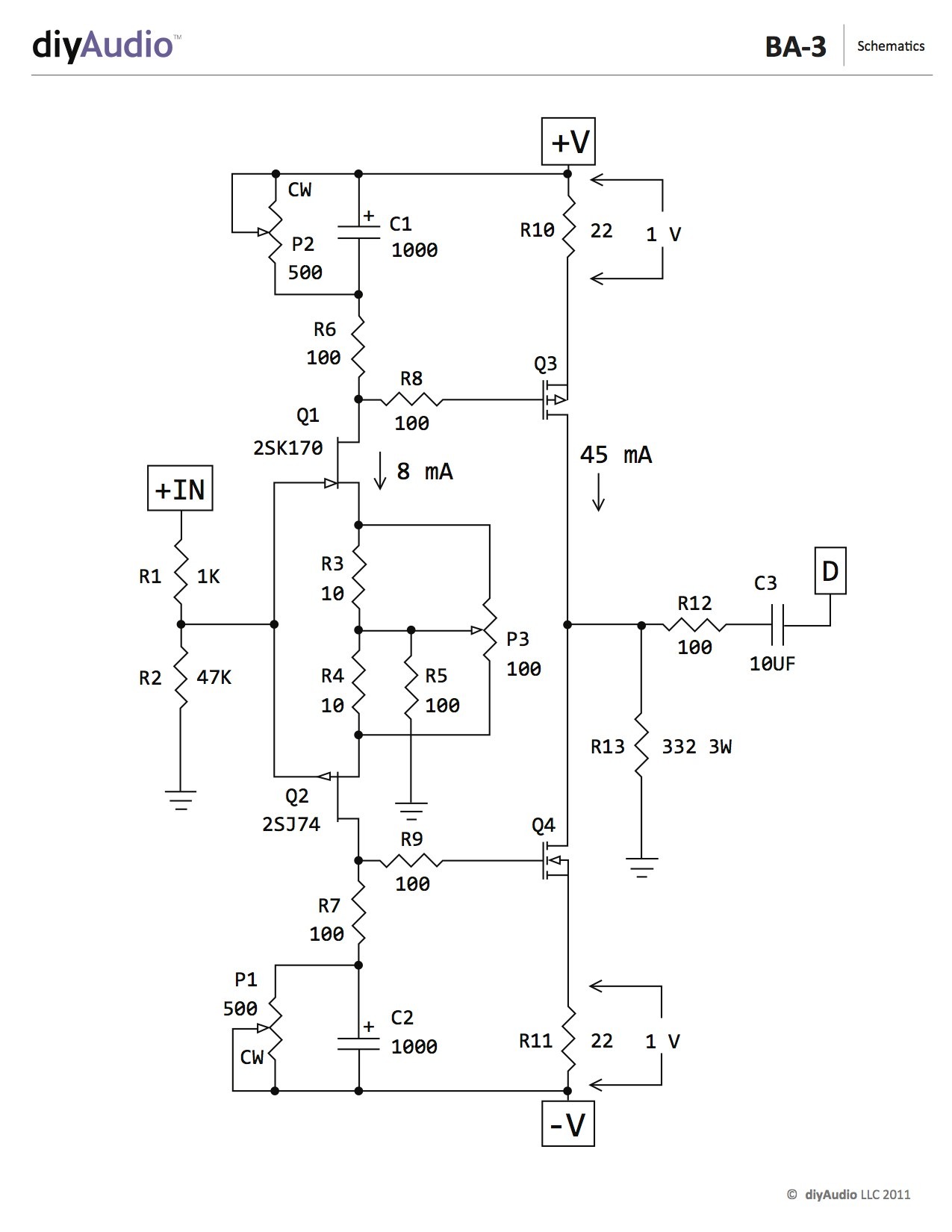

by changing the Aleph J with the BA3 I noticed a sensible (pretty big) drop in the volume, of course at the same volume setting of the preamp BA2018.
In order to align the sensibility (increasing it) of the BA3 to that of the AJ,
have I to change the value of resistors R5, R6, R7 (in the gain stage) or other?
Thank you,
Thank you,
The BA-3 should have more gain than the J. Or did you susbstitute some of the values of you BA-3 gain stage while building?

then I have done something wrong... I'll check the components on the gain boardThe BA-3 should have more gain than the J. Or did you susbstitute some of the values of you BA-3 gain stage while building?

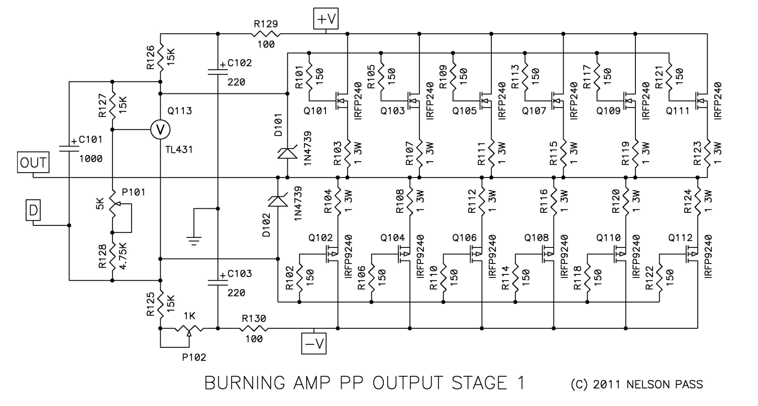

My BA3 has dc offset 56mv , it is a safe for my speaker;
Good Question .
The Single Ended output stage I've prototyped , Vout = 0 ---> + 50mV of drift , as the amp warms up .
So think it would be best to let the amp warm up , and then fine tune the P101 trimmer .
Embarrassing Question .
For the Single Ended output stage , I can't find a reference on why R131 is in the CCS , and do you calculate its value ?
Just for clarity.... When you say gain of the BA-3 amplifier is 15dB, the gain is from the front end only and the output stage is just a follower (like the F4). So total gain ~15dB as the BA output stage adds no gain.Just to clarify, BA-3 amplifier is not a buffer. (F4 is a buffer with no gain, perhaps you are thinking of that...)
BA-3 amplifier has about 15db gain.
B1 buffer has no gain, but B1K NuTube has gain.
Iron pre has 6db/12db as noted, and works very, very well with BA-3 amplifier, and sounds an absolute treat. 🙂
Also, BA-3 front end, does it benefit from regulation or is it dead silent when supplied off the main PSU rails?
Correct. The BA-3 front end supplies all the voltage gain. The "BA-2" complimentary output stage is very close to the F4.

Yes, the front-end has the gain, and the output stage is a follower. (BA complimentary output stage is an F4 without the Jfet buffer)
Will the front-end benefit from a regulated supply? Probably. It’s absolutely worth trying if you are interested. Is it a panacea for reducing noise? Doubtful. Proper layout and amp building practices will be the big determinant of overall noise.

I think my BA3 has more gain (than 15). F5 is supposed to be 15 db. My BA3 has noticably higher gain. I notice Aleph J is similar. My M2 seems more like the F5 in terms of gain, I assume 15ish.
My BA3 front ends have more gain than my BA 2018 line stage, both have more gain than Iron Pre, set at 6dB.
