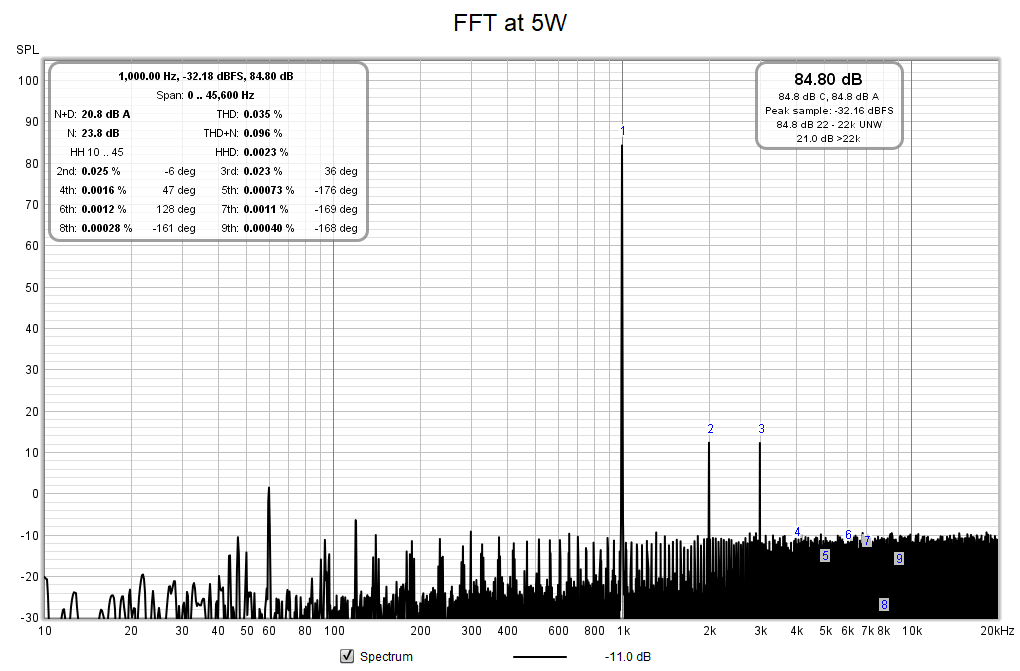

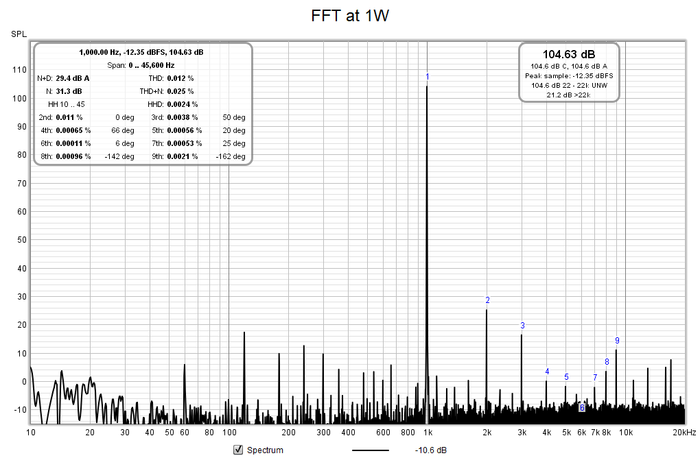

This one is beautiful... I don't care about the total distortion, as in my experience that makes very little difference, but instead look at the very clean curve (or stair step) of the harmonics decay. Nothing out of place, every higher harmonic lower than the previous.
Wonderful!
In a perfect world (well, my world, anyway...) I would adjust until the 'step' between H3 and H4 was a little more smooth.. I.E., lower the total H2 if possible, as that will lower H3 as well, and see if the plots could fit on a horizontal asymptote. It's pretty close as-is, so it may just be gilding the Lilly.
But the entire point of P3 is to fiddle around and try stuff, so might as well try.![]()
Ohh, hey, awesome! That's for the feedback, that's really helpful. I'm glad I'm getting somewhere 🙂
They say the definition of insanity is doing the same thing and expecting different results. I feel like I've been doing the same thing, expecting the same result, but *getting* different results! I'll chock that up to user error. 🙄
For tweaking, the process should be, turn P3 a couple turns in a hopeful direction, zero offset, observe measurement, repeat? That's more ore less what I've been doing. Will continue.
ZM: I will check out those articles, thanks. Does the absolute phase matter, or just the sign (ie, is 87* better or worse than 152*)?

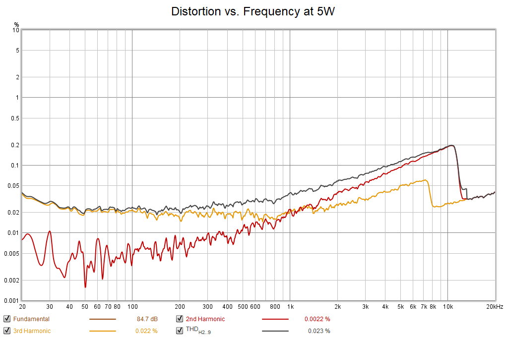

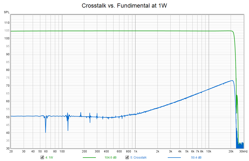

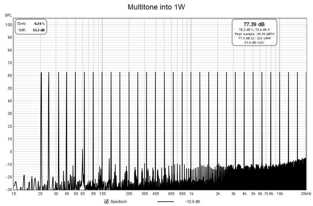

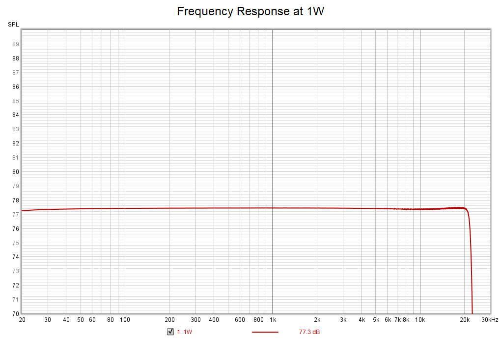

I'm pretty happy with my current setup, so I decided to take some proper measurements. All were done into 7 ohms (because that's what I had). Actual output power might be a little higher than stated (1.2W~), but it is consistent.
Most interesting to me was how the distortion profile changed from 1W to 5W. Also that my crosstalk curves upward from 500 Hz.
well, even your car is sounding different at 2K and 5K RPM

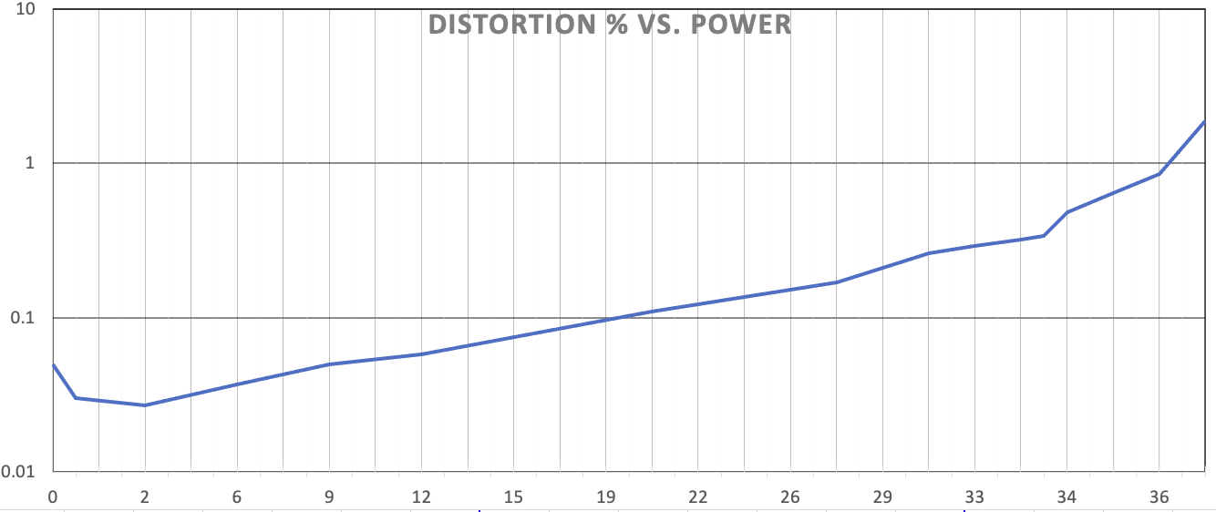

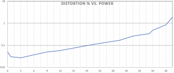

Here's one more, max power before clipping. Measurement was taken into an 8 ohm load, with clipping defined as 1% THD. I beat the spec, reaching just over 36W into 8 ohms!
Incidentally, does anyone know a good way to automatically sweep and measure power vs. distortion? I couldn't find a way to do it in REW, so I plotted these points manually.
