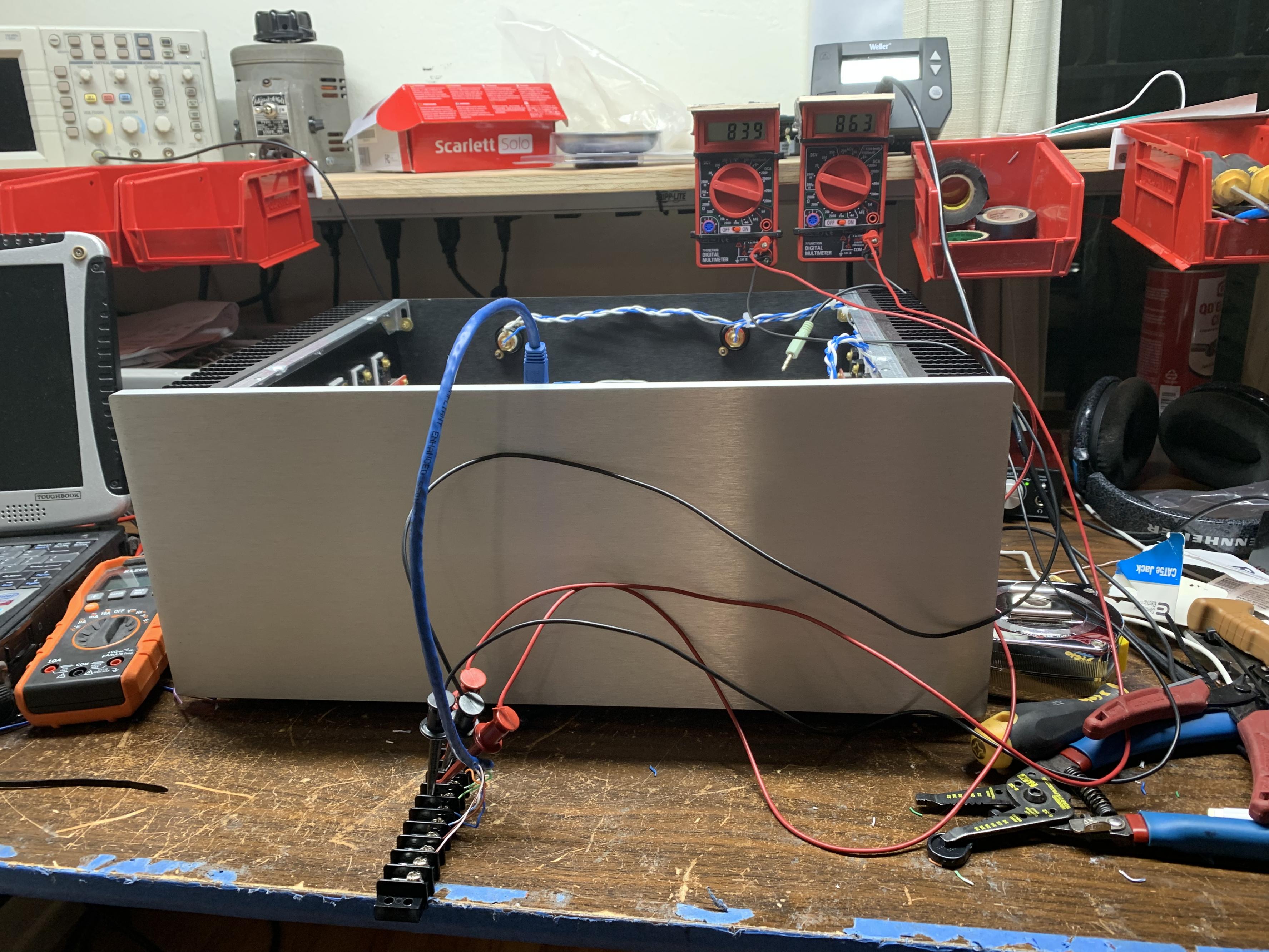

Ok, so, I’ve got a Focusrite Scarlet which I’m feeding from the output of my Front End. Amp is unloaded, taking a 1 KHz tone.
I’ve got the 2nd and 3rd harmonic clear as day in REW, and using the distortion products window to see what’s going on. I can adjust P3 and make the harmonics go up and down, so far so good. But when I try to balance the bias currents across Q3 and Q4c it totally changes the harmonics! It’s like I can set them with P3 *or* bias, but to make harmonics what I want means I can’t have balanced bias.
Does this make sense?

Very good now you have the proper tools.
- Let the amp warm up for an hour or so
- With P3 you can adjust H2.
- P3 will also change Bias and Offset.
So you adjust P3 for minimum H2 then readjust Bias and Offset via P1 and P2.This will change the harmonics again so thats normal.
- Then readjust P3 again for minimum and so forth.
You cannot get any thd spectra you want, but you can trade off H2 for a little more H3. Or you can maximize H2 for a little less H3, if you like. Bias current through Q3 and Q4 should be the same.
Don´t know if thats coherent with theory but I found cancelling H2 gives a little more H3.

Does the position of P3 relative to the voltage across R3 and R4 matter? Papa mentions the degree of H2 going more positive as P3 aims towards Q1 and more negative as P3 aims toward Q2.
It matters in as much as it has an effect. Turn P3, and the voltages across (current through) R3 and R4 change. See the schematic.

re: what ozorfis said, I found that the total bias of the BA-3 FE could affect THD along with the relative balance of H2 and H3. You can measure it with or without the output stage. See the BA-3 as a pre-amp thread.
I found that changing P3 changes the amount of H2 relative to H3 along with THD if bias is kept constant and DC offset (for the FE before the cap) is reset to as close to null as practical. If you just twiddle with P3 w/o resetting the bias and offset, then results are likely unpredictable / not repeatable.
I did all this before I knew how to check the relative phase of H2 to the fundamental, so apologies for not knowing which way things go. I can't wait to try it though.
When I changed P3, I measured and tracked voltage drops across R3, R4, R10, and R11. That way, I can go back to any previous point reliably (I think).
Ozorfis, when you reduced H2 were you doing it balanced (my guess is that was easier to completely null)?
AND/OR, did you just get it to where H3 was higher than H2 (H3 goes up a wee bit, but mostly reduced H2) with a single-ended amp? With my SE amp, I could not get H2 into the noise floor, but I could get it pretty low relative to H3. Initially, I had it set for months and months with H2 and H3 roughly equal.
My guess... is that there could be more control over the relative levels of H2 and H3 along with THD in the balanced amps, but that's just theory. I'm still playing vs. knowing. My guess is that it's also now a 6 pot balancing act vs. 3 for each channel. So... yikes.
Papa is referring to the phase of H2 being positive or negative. Starting from the position of P3, where H2 is minimal, you get more positive phase H2 by turning P3 one way and more negative phase H2 by turning the other way.
The phase of H2 I could not see with a soundcard. Here I had to use a notch filter and a scope, which was only of educational value.
I adjusted each channel in single ended mode. Not sure if it is possible to do in balanced operation simultaneously.
Front end balanced is a little less distortion but comparable. With P3 you can still have H2 balanced, if desired. I am running minimum H2 now as I have become a sucker for detail.
