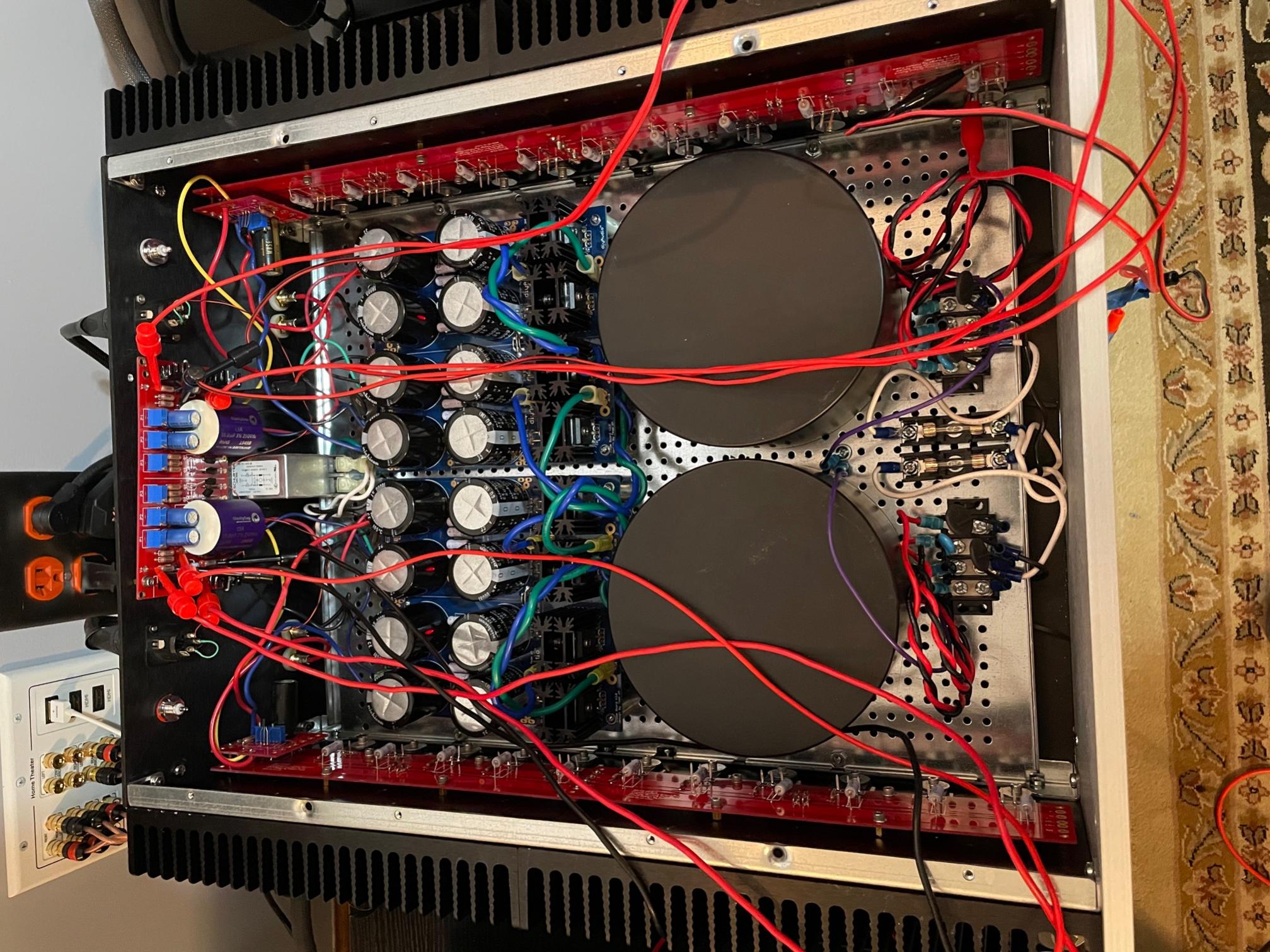

Pics. Of course! Wanna see my kids? 😀 Here's BA-3 showing off. To the left is BJ2, and hiding shyly below BA-3 is Balanced Iron Pre. :joker: Current state of affairs after letting it sit over night at 0A4 bias per output device. Sinks are getting toasty, but not true burning amp toasty yet.

Nice, REALLY nice, work. Looks amazing. So guess you matched your own MOSFETs. Harris? And the case, is that 5u 500? And what type are those transformers?
Nice to hear I am not the only one toasting a bit, at 0,75 amps per device. 3 deep but still.
Thank you very much! I am a bit ashamed re: 1) Wire dressing at I/O and entire back section. I thought I had it planned well, but... 2) Completely botched the holes for mounting the FE board to the back panel.
All will be fixed / tidied up.
Output devices are Vishay. I bought a few sleeves each of the 9240 and 240s about a year ago and tested them all at 0A5 for Vgs. I sorted and labeled them all for planned projects.
As an example, when I did the "3-deep" build, I knew I may want to try 6-deep and perhaps do balanced monoblocks. So, I sorted out 48 devices, marked them and set them aside. I haven't measured across all the source resistors yet to see if there are any little piggies trying to hog current, but all the Ns are matched to within ~0V06 (4V097 to 4V156) and the Ps were incredible out of the tube and are within ~0V01 (4V290 to 4V303). My matching technique probably has a bit of error, so I probably should be clear that those were my measurements... any may not be completely accurate. I was consistent and used heatsinks, so the delta between them is probably pretty solid (decent precision), but the actual Vgs may be off a touch.
The chassis is Pico's Toxic Masculinity 4U/500. The BJ2 is in a 5U/400 to the left for comparison.
In preparation, I biased the "3-deep" up to 1A0 in the 5U/400 to see how burning I dared go into burning amp territory. 🙂

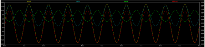

I linked here pic from post you mentioned, so you can see that Iq of OS need to be half of Peak Current (edit: when dealing with wimpy made output stages, having local degeneration; take PL XA25, which is not having that, and throw all this calculus through window, at least when speaking about defining KlunK! point)
843721d1589395906-ba-3-amplifier-illustrated-build-guide-sim-sshot-png
now, you can do simple math for any load you intend to burden your Sissy amp with, so you can make some plans - how much of heatsinking, and Watts in Donut and Farrads in cans and number of output devices you think to mess with

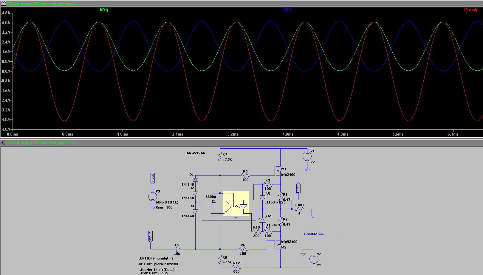

Before, I had the AHA and understood the simple concept that during "handoff" both devices in push-pull are still working. That was a big understanding.
Taking it further. It looks like R1 and R2 would be the source resistors for a complimentary pair. Current through them blue and green. Red is current through load, which looks like noted as 4R.
The current through R1 and R2 would be Ip of 4A and Ipp of 4A, correct?
The current through load would be Ip of +- 4A with Ipp of 8A. Is that correct?

re-read few times what I wrote, then try to imagine what I forgot to wrote :rofl:

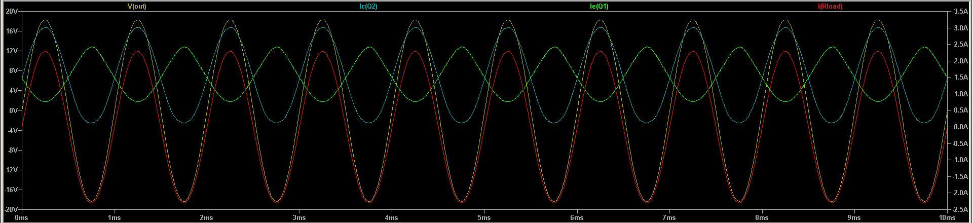

simple as this :
maximal current you can get in load is one rail voltage divided with Rload, not counting losses in source resistor and transistor itself (Rdson)
to avoid KlunK! , your Iq needs to be at least half of previously calculated current (Ipeak)
sum Iq is divided by number of vertically looking/oriented pairs, simply because that is current path - vertical
so, it's simple - you know sum Iq, divide it with number of pairs, you have Iq per pair, divide with 2 and multiply with rail V, you have dissipation per part
simple math, imagine apples or oranges or marbles, same thing
please, do not confuse me further with Xpeak related questions, while I just got (right I hope) relation between Xpp and Xrms :clown:
just to illustrate fact how things are simple, here is sshot from sim of amp I'm recently working on
(current through upper device, current through lower device, current through Rload, voltage across Rload)
prototype measurements are confirmative
rails are sorta 22-23Vdc, Iq 1A5, no emiter resistors (yup, bips in OS, shoot me)
I need to find math model for prediction of that (KlunK!), but I'm neither Pa (replaced math with mileage) nor lhquam (all math which I'm not even capable to imagine), but I think that I'll stay with sims and measurements
prediction is, anyway, for Sissies :rofl:
This is brilliant! Thank you. :worship: A few hours for me to rest the brain also helps. 🙂
From #714, I previously got it right from intuition that max current (Ipeak) will be from one rail. 😀 It makes perfect sense to include the loss from the device Rdson and the source resistor (if used) to get true Vpk from rail. I never considered the loss from the transistor.
#715 and previous graphs from early posts in May with new explanation help tremendously.
Noticing your new graph, each part in the vertical pair doesn't even have to pass equal current.
I don't need to know the math like Lynn, and I will never have the experience of Papa. I respect all approaches. As a padawan, I like to learn general concepts that apply in most situations and see if my wee brain can comprehend.
Observations
I finally just picked up that the Iq (since the devices are always on and passing current) is the starting point or (not sure of correct term) zero crossing vs. 0A.
Am I looking properly at the graph in #715? It seems one device (Q2) is working a bit harder than the other. Q1 is 1A5 Iq with swing of ~+-1A. Q2 is providing more ooomph or passing more current at the same voltage. 1A5 Iq with swing ~+-1A5. Could that be because of different Ice?? You have c and e in the graph and mention emitter resistors... so assuming collector and emitter in this case. I just don't know equivalent term for Ids for something with collector and emitter. I admit to a bit of guessing, but trying to exercise the brain and show a bit of thought since you put in so much effort to teach.
Interpreting what you didn't type - 😉
In this case, if I understand properly, Vpk is ~18V. Ipk with 6R will be 3A. 3A/2 => 1A5 Iq
Working backwards designing an amp to work well with normal 4 to 8 ohm speakers... Class A to Vpeak of 18V into 6R load => 1A5 Iq Little lower "Class-A power" into 4 ohms.
If I only had one vertical pair 1A5 Iq is the set point. If I had two vertical pairs 0A75 for each would be the set point.
Maybe?
