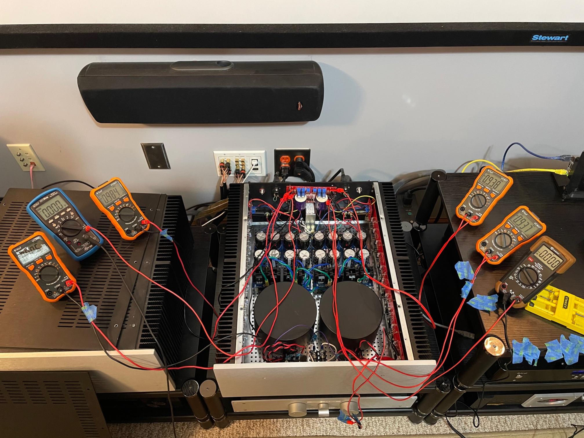

Hi Andy and ZM -
ZM - Thank you! I was absolutely scratching my head when looking at the article on the FW site vs. your referenced post. R8 and R9 in the article actually refer to R10 and R11. Making much more sense. I am still weakling re: actual circuit, but each day learning a bit more.
The FE bias doesn't drift too badly, I may just be worrying about nothing. It does stabilize after an hour or so. It is just challenging to get set within 5% on each side. It wanders about 5mA against a 45mA target when the lid comes off. The DC offset drifts 20-30mV immediately when the lid is off. Targeting 0V. I have it centered at about 8mV on one side and 6mV on the other.
First action will be larger heatsinks for Q3 and Q4 just to sleep better. They are really toasty, but not out of SOA. I think (as usual) that I am worried about nothing, but larger sinks will give those devices some help either way.
Andy - your observations and bias / offset plan are very similar to mine. I let it "cook" for about 2 hours initially or just wait for the meters to stabilize for small tweaks with the lid on. I use 6 meters for the front end (2x R10 2x R11 2x between "Top of R12" at C3 junction and GND). See pic. I use 4 for the output stage (2x at source resistor and 2x at output/GND)
I suppose I need 10 meters 😀
The output stage is absolutely rock stable. I can dial the bias to within a mA and null the offset to within 0.1 mV. Easy-Peasy.
Pics. Of course! Wanna see my kids? 😀 Here's BA-3 showing off. To the left is BJ2, and hiding shyly below BA-3 is Balanced Iron Pre.Current state of affairs after letting it sit over night at 0A4 bias per output device. Sinks are getting toasty, but not true burning amp toasty yet.
