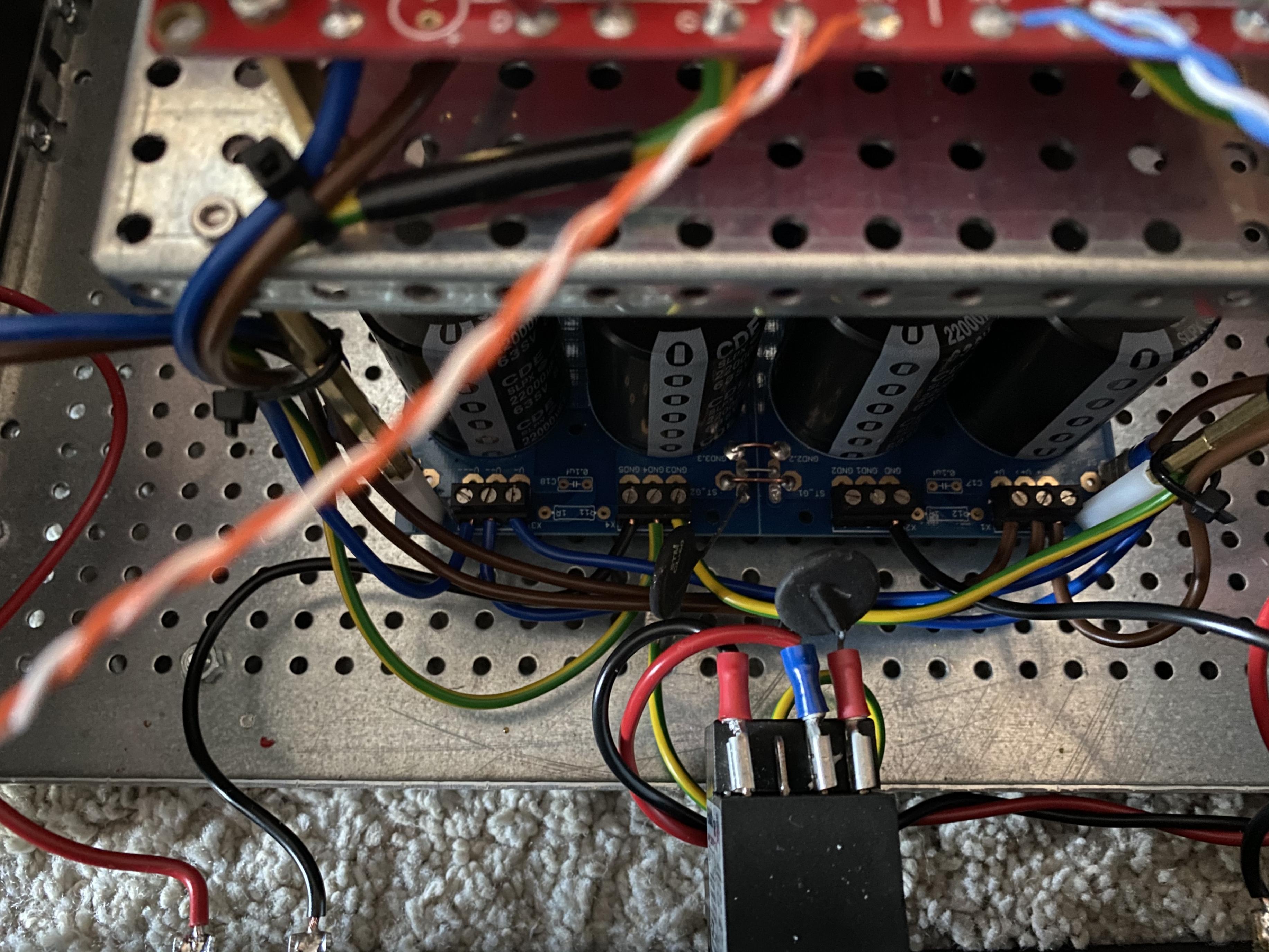

I took good time wiring, planning it carefully. But nevertheless, I suspect it is a wiring issue. I did spread the ground wires between the two PSU boards, half in the negative side ground euroblock, half in the positive side euroblock. May that be the issue?
NTC soldered the same place and way 6L6 does, and all ground jumpers soldered on. Will take som photos tomorrow, and do some initial tests based on the grest tips from you guys =)

Here is a picture of the PSU connections. It is basically as 6L6 did it, almost at least. Ground is a direct copy, more or less.
This morning the hum is much lower in volume. This leads me to believe that perhaps DC on the mains make the transformer hum more. But that does not explain me hearing it at the speakers. But, putting my ear close to the transformer, it is the exact same sound as in the speakers, frequency and all. Just aounds the same.
So I suspect magnetic coupling with the FE. Or that the hum is just so loud that it is picked up by the FE. Does that make sense? Messing about in the chassis, the FE seems very susceptible to noise in there.
I did some tests today:
1: shorted inputs. No change
2: connnected the amp to bouth grounded and ungrounded wall sockets. No change
3: moved all gnd cables to same euroblock, except for one of the speaker post negs. No change
4: tried to put some aluminium foil between the transformer and FE. No change.
5: moved the FE 2 inches further away from the transformer.
6: reduced bias to half. No change. So the transformer is not struggling. Maybe it is just bad.
So I sorta feel I am at a loss here. But I also feel my main hypothesis is strengthened: the transformer simply makes so much noise it is picked up by the FE.
I have not tried moving the transformer out of the chassis, pr disconnecting the FE. Will do sowhen I have more time. Now, the hum is not hearable at the listening position, so I can live with it. It must go at one point or another, however =)
If it truly is the transformer noise being picked up by the FE, I might consider a Toroidy and their in house DC blocker.
Thoughts?
