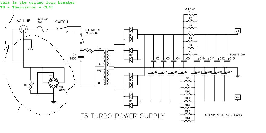

Hello Andreas,
fantastic news! Enjoy the sound!
The hum could also be caused by your ground routing - not only by the transformer.
Seems to be 50/60 Hz - hum from mains - how you describe it.
Have you built an ground-loop-breaker between audio-ground and mains-ground?
Nelson Pass uses often a 35A - rectifier - bridge together with a CL60- thermistor to do this.
I have to search for the pic / schematic. It is easy.
I used it.
Greets
Dirk
I used it.
Greets
Dirk
Mechanical noise from the transformer and hum at the speaker tend to have
different causes.
First try shorting the inputs of the amp and see if the hum at the speakers go away.
If so, that's indicative of a ground loop.
DC on your mains power can cause transformers to hum.

Hi. Dirk and Dennis! Thanks a lot for your input.
I actually had planned to try shorting the inputs. So thats probably the first thing I will do, it is the easiest.
Dirk: I have the ground loop breaker iaw schematic. Basically thought I did everything right 🙁 Btw. The frequency I assess to round about 100 hz, not as low as 50. Sounds just the same as when putting my ear close to the transformer.
Dennis: Even if there is DC on the mains, causing the transformer to hum, it should not appear at the speakers either way. Hmmm. This was an irritating one.
Plan:
1: Short inputs and check for changes.
2: Reduce bias and check for changes
3: Check orher wiring, perhaps this one first of all =)
Come to think of it, I have had ground loop issues in the past. But they were always volume dependent, as opposed to now.
Plan:
