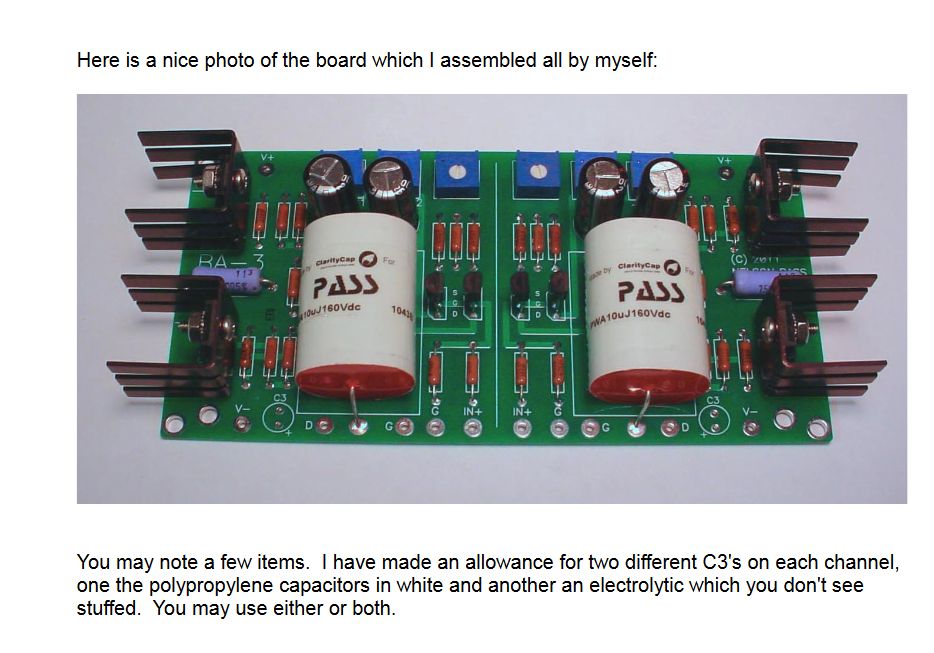

So I’ll soon be finishing the front end. I have a question regarding caps. I bought som big Vishays for C3. Should I put in some small silmics as well, or can i just leave small C3 spot completely open and unused? Nelson did this in the depicted board in the BA-3 manual. Reason I ask is because I see people bypass the big C3, for example 6L6. Why? Does it mean that you can leave the small C3 spots unused, but not the big ones? I also bought bypass caps, so have several options. I also have small Nichicons I can use. But need your advice here.

Hello andynor,
I would use an filmcap with around 10µF. But you can also use a bipolar.
Some use bipolars and bypass with a small filmcap.....
See pic below from Nelson Pass BA-3- article....🙄

Hello andynor,

But the one question remains unanswered: Can I leave the small C3s open (with NO parts) if I use the big caps? That is the picture I mentioned. Nelson says you can use either or both.
Thanks. I’ll go with the big ones then. Guess this a mix and match and feel kinda thing, but I’ll start with my big green half-ugly Vishays =)
