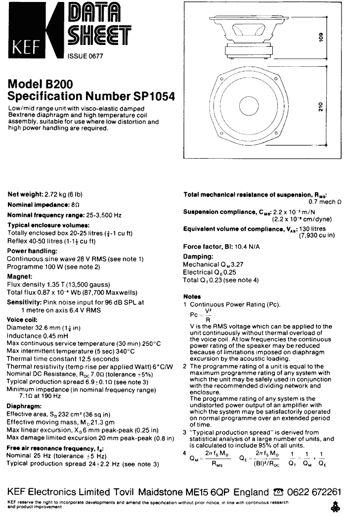

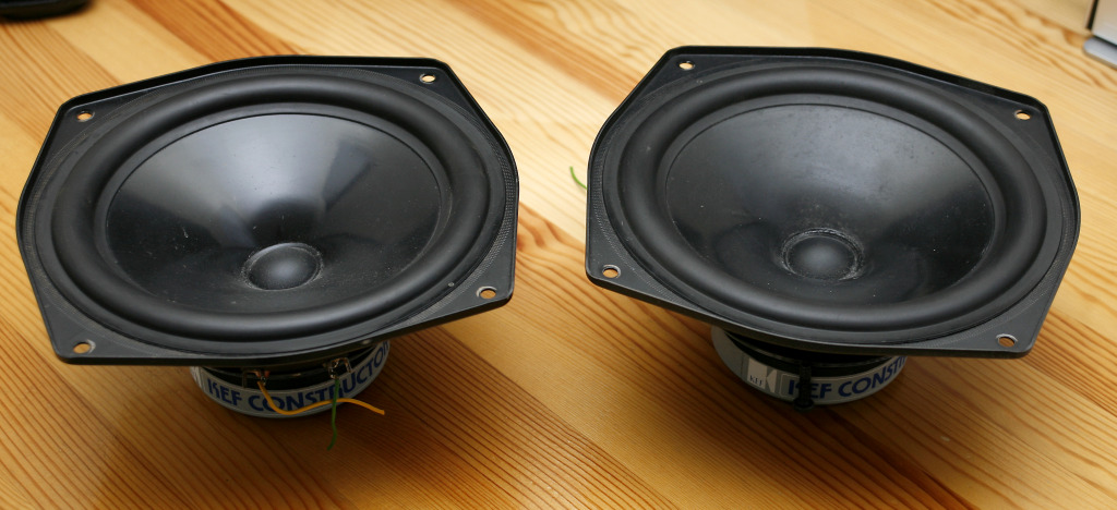

I think I'm becoming obsessed with this KEF Calinda crossover. It interests me, because 8" bass plus 1" tweeter is such a common design and I'm figuring what to do with mine. 😎
To recap, here are the main T-S parameters for a KEF B200 SP1054 8" bextrene bass/mid (large magnet, low Q. n.b. Other B200 models had Qts around 0.45 and Le around 0.25mH):
Vas 130L
Qm 3.27
Qe 0.25
Qts 0.23
Le 0.45mH
Re 7.0R
Fs 25Hz
Main parameters for T27 SP1032:
Le 0.05mH
Fs 900-1100Hz
Re 5.2-5.6R

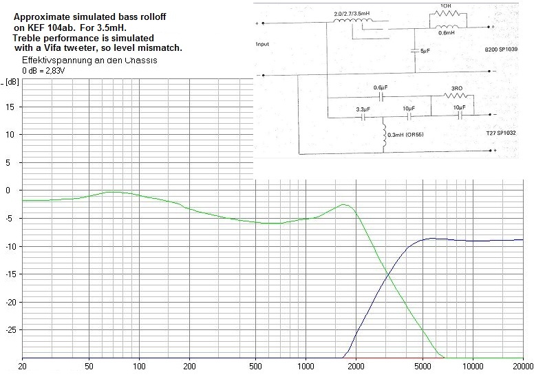

Looks pretty much as i'd expect post KEF 104aB.
2nd order on the woofer, with a notch filter + 3rd order HF + their acoustic butterworth mod for the T27 tweeter.
http://p10hifi.net/planet10/TLS/downloads/Kef104abXO.pdf

Back on-topic @ Planet_10. I looked up the simulation for the KEF 104ab which uses the lower inductance B200 SP1039. The bass rolloff isn't too bad, especially since it's been done for the bright midrange setting with 3.5mH.

Michelino, I've been looking at that B200 SP1054 a bit. 7 ohms Re. Le 0.45mH. For a 10" wide cabinet, your 6dB bafflestep (aka bass boost) is 2.4mH in parallel with 7 ohms. Unsurprisingly close to the KEF 2.7mH.
Loudspeaker Diffraction Loss and Baffle Step Compensation Circuits
I'd then try this third order butterworth on the bass with -3dB @ 2500Hz after the 7 ohm resistor: 0.45mH, 18uF and use the 0.45mH B200 inductance itself as the third term. So it's really electrically the 7 ohm resistor, one inductance and one capacitor to fit.
A modern 6 ohm tweeter with an Fs of around 600-800 Hz ought to be able to cope with a crossover @2500Hz. So the tweeter crossover is 6 ohms, 10uF, 0.2mH and 10uF in 3rd order B/W highpass. The six ohm resistor gives you a slightly different calculation that you can check here:

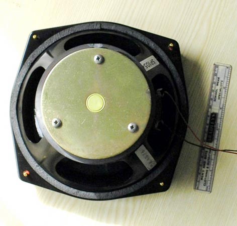

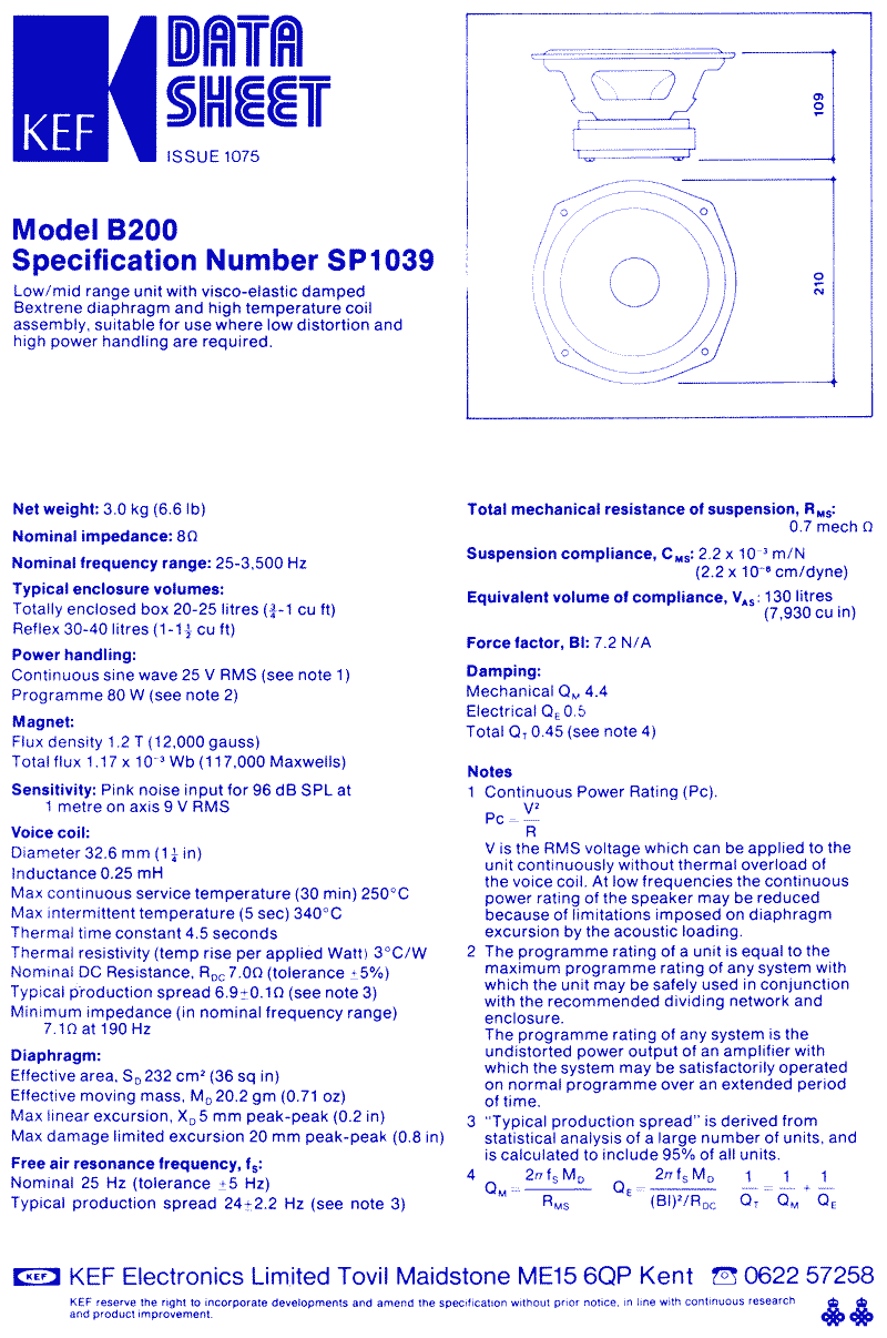

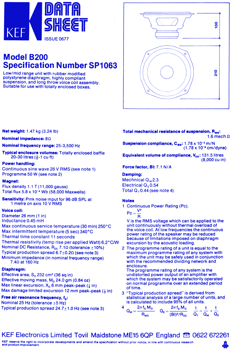

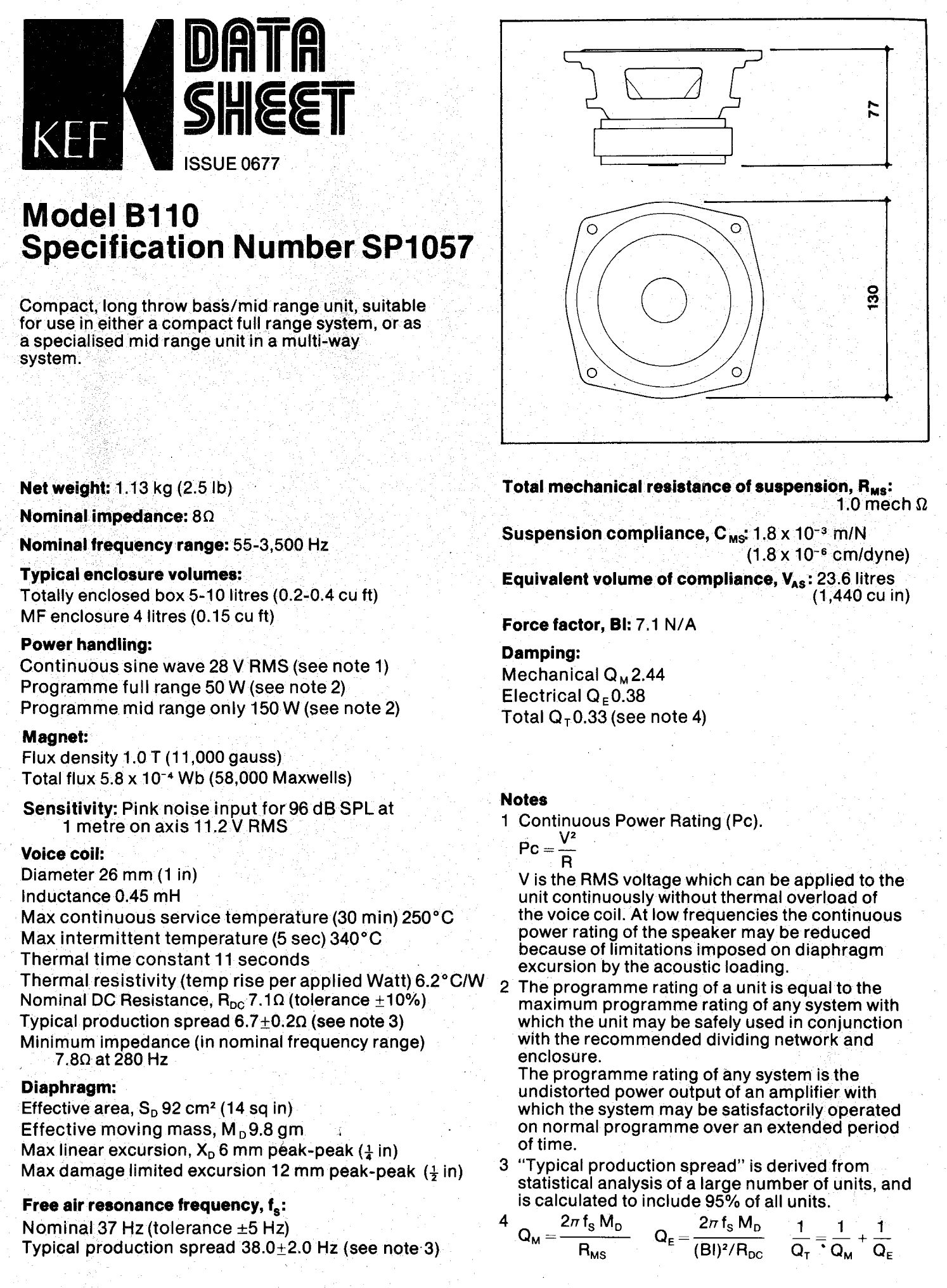

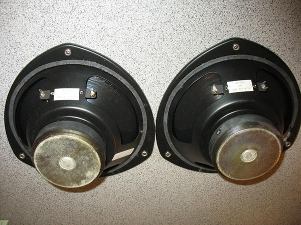

Various Questions arround the B200 Versions
1) What means the specification number "SP-10xx" (nomenclature of that number) ?
in the attachment some examples of various B200 versions
2) I have heard, there is a special company in UK, that is able to resurrect all B200 (and B110) versions with damaged voice coil (i. e. overpass in the genuine and new condition).
I want to know this company.
Thank you for advices.
