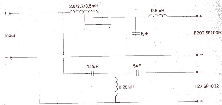

I own a pair of KEF SP1054. What do you think about its sound? And there is the crossover network of KEF Calinda speakers which mounted SP1054: Crossover for Calinda. What is this configuration? Why the 5uF cap doens't stay after the 3.29mH coil, in parallel with the woofer to make a 2nd order low pass filter?

The low-pass filter for the B200 in the schematic is a modified version of a 3rd-order 'T' type network, so there will be an inductor between the 5uf cap and the drive unit. The modification to the 'T' network is the added damped parallel-resonant trap in the input arm of the 'T'.

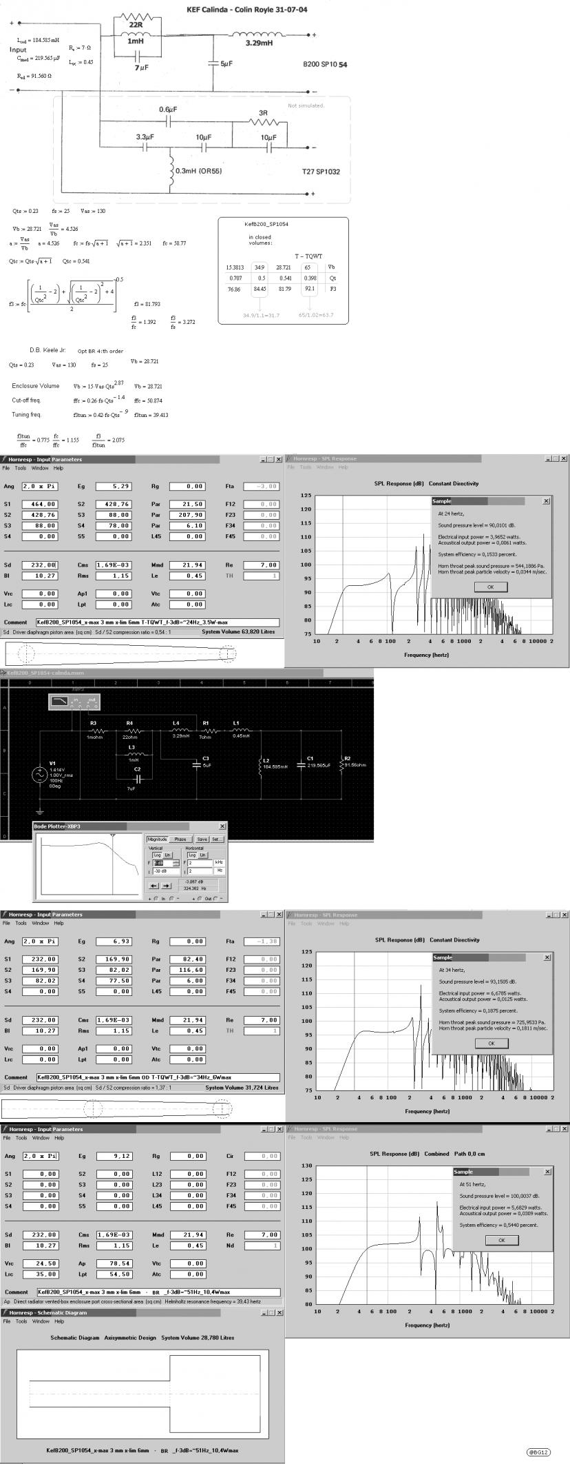

So... I've just re-simulated the calinda xover but I've found 250Hz @ -3db ... What's wrong? See the picture http://s17.postimage.org/xyvdf8qr3/sim_calinda.jpg .

Looks to me like that crossover schematic is plain wrong. Try L2 = 0.6mH in your simulation and see where -3dB goes. We're looking for about 3KHz crossover here. 😕
I made the B200 Zobel: Capacitor C = 5.88 uF Resistor Rc = 8.75 Ohms
You knew that already. 🙂

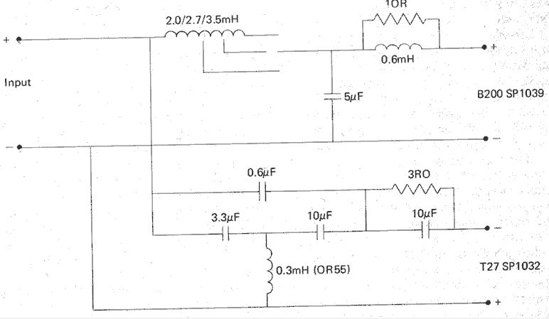

Dug up a couple of crossovers from the KEF 104 and KEF 104ab (later acoustic butterworth) speakers which had that ABR thingie. Here with the B200 SP 1039 which is 0.25mH Le and a bit higher Qts @ 0.4 or so. The tapped inductor is an acoustic contour switch with three positions. Gives +/_ 2dB @ 1.5 kHz.
KEF seemed to do some quite odd things with those B200 units. I expect the rising impedance makes the lowpass crossover point quite vague. The T27 seems to get a more exact treatment. The Calinda seems to exactly inherit the KEF 104ab highpass which is very near 3.5 kHz on 8 ohms when I checked it.

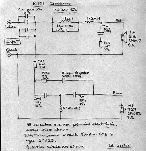

The lower half of the Xover for the T27. A 18 db/octave highpass filer and then some EQ filter on top seem pretty standard KEF style.

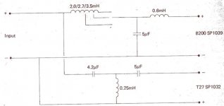

The LCR filter for the B200 might be OK my problem is that 5MicroFarad cap in front of the inducer? The large coil is not impossible the Calinda had a narrow baffle and to correct the 6 dB baffle step it is quite common to have about twise as large coil as classical calculations would predict. As there is not RC link across the B200 terminal the effect of the coil will be affected by the rising impedance of the B 200. But what the heck is the cap doing in front of the coil??
Yes, DrBoar, it may just be in the wrong place. I saw a photo of the Calinda crossover, and there WAS a large ferrite-core inductor there.
I was looking at the little KEF R101, which had the B110 unit in a BBC LS3/5A monitor type arrangement.
LO, the inductor is in front of the capacitor with a similar LCR trap! Don't have modelling software to look at that though...FWIW, KEF were kinda rough and ready with bass rolloff on the B200. Often nearer 2.5 kHz on the component values into 8 ohm.

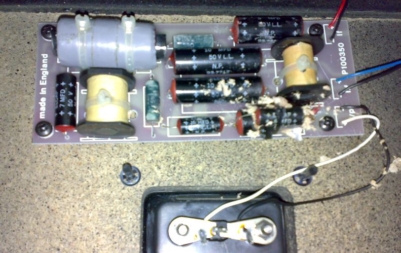

As it goes, I reckon 1.5-3mH and 5uF 2nd. order, with or without the trap, can't be very far wrong for that B200. I do think the coils go before the capacitor in the crossover, and looking at it confirms it. Red is woofer hot. Blue is tweeter hot and white is hot of input. Black is earth. The capacitor top right is the 5uF. 🙂
Enjoy the pictures of your B200 in it's youth! 😉
