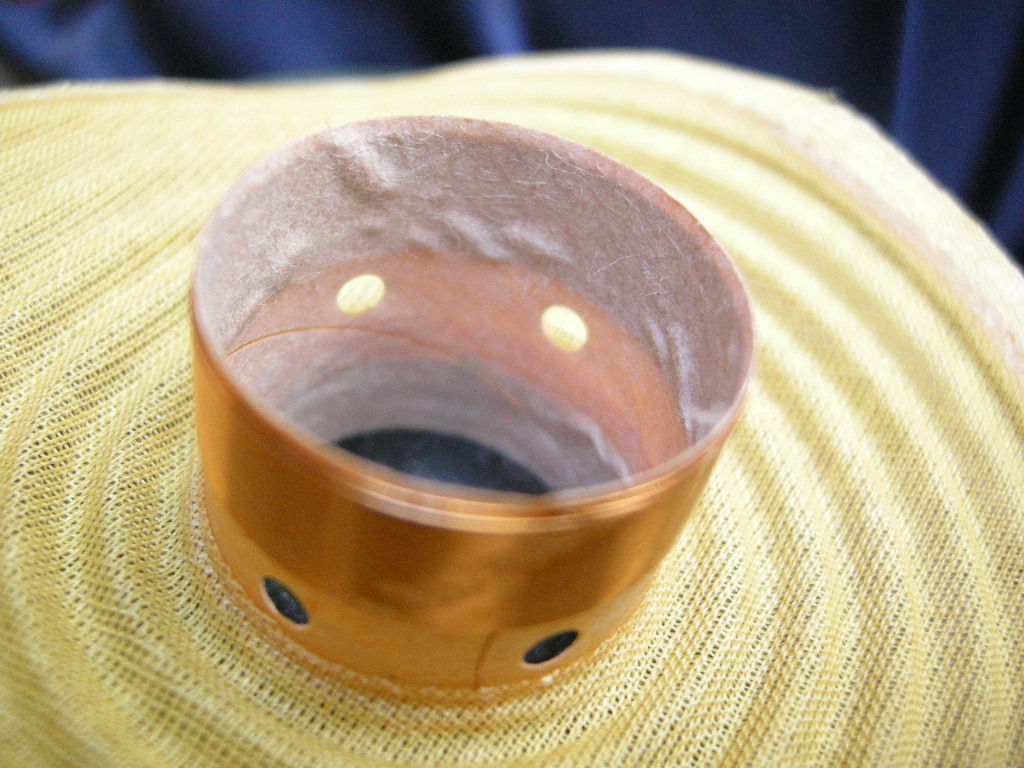

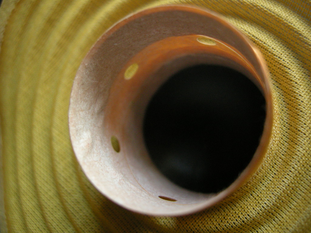

In my experience with Audax tweeters, particularly the TWO25A1 (A TWO25A0 with added ferrofluid), then after 15 years or so the fluid has dried out a lot. I've converted more than one old TWO25A1 to the A0 version by laboriously cleaning the remains of the ferrofluid off the coil, and then using blotting paper and a fine needle to remove the rest out of the pole piece gap.

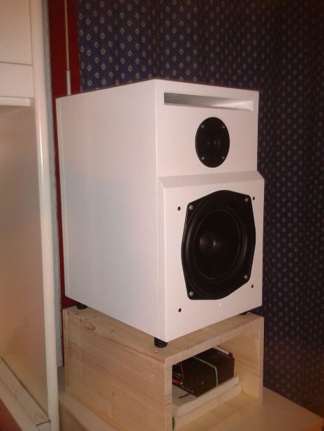

I'm back with some news.... 🙂
http://s13.postimage.org/8ohg4ubyv/2012_03_14_00_23_57.jpg
In few words, the sound is now far better than before: the xt19 is an awesome tweeter and with the BSC there is more punch from the SP1054. More detail, realism, better soundstage, flatter response and more natural sound than my previous setup.
I had no time to tweak crossovers up to now. This is the actual circuit:
The only thing I have done is to cut the port to have a tuning freq. of 45-50Hz.

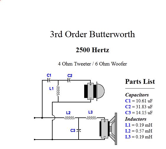

Effective 3rd. order crossover around 2.5kHz, because he's using the 0.45mH woofer inductance as the second crossover coil element and the bafflestep resistance modifies the coil and capacitor values as below. 😎
LC Filter Design
The KEF takes advantage of better modern tweeters and a lower crossover point! Plus some time delay compensation...the icing on the cake! Very well done, my friend. A minor masterpiece. 😀

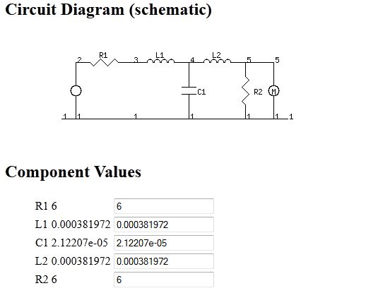

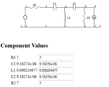

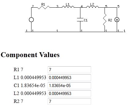

It's the lowpass circuit which is, IMO, clever. It uses a RL Bafflestep Compensation Circuit as an input resistance.
This gives you a 3rd. order 2500Hz Butterworth on the bass/mid in effect, but the component values get modified so the coils are the same size:
LC Filter Design
This is different from the standard calculation:
2-Way Crossover Designer / Calculator
[URL="
Butterworth filters have a pleasingly flat impedance, and the input resistance should give a valvey sound and an easy load.

But, I'm not so expert so tell me... what did I do of so special? I've played with LSPCAD and then realized the design... The high pass is a Butterworth filter @2,8kHz, the lowpass even a butterworth but with the BSC.... Then 20mm of buffle thickness and that is 🙂 ...
Ok, I've undestood. That's a trick in that LC filter calculation you suggested... but I've not undestood what is that trick 🙂 ... are there some more infos on the web?

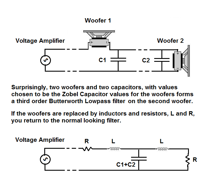

Good afternoon, my friend. Christ has risen a little later in Portsmouth. 🙂
What you've done is apply an elegant result which fits a filter exactly to a particular bass unit. Here, a B200 SP1054 with a Re of 7 ohms, Le 0.45mH.
Applying Le/Cz=49 (Re squared), we get a Zobel capacitor of 9.187uF. This in series with 7 ohms will theoretically flatten the impedance of the bass unit, but we're not doing that. It just remains to calculate the resonant frequency for those values of Le and Cz and 14 ohms as a series LCR circuit, which here is 2476 Hz.
Alan Yates' Laboratory - VK2ZAY's Engineering Calculators - LCR Resonance
It's my notion that it is a VERY GOOD THING to use matched source/load filters with transistor amplifiers, because they have very nice impedance which should give a warm sound equivalent to valve amplification.
LC Filter Design
You now can use the bass unit's voicecoil inductance as a filter component, the 7 ohm input resistor in parallel with a coil to do 6dB bafflestep correction, and it all works out well. To be fussy, you should do the same with the highpass tweeter filter, which will flatten overall impedance, but I'll forgive you here. 😉
To boost bass, you could modify your R1 value to 7 ohms. I would L-pad the tweeter too, to get it to roughly 7 ohms. The Vifa XT19 is an uncomfortably low 2.9 ohms Re, and that really needs raising. To consider for your next effort anyway! 😎

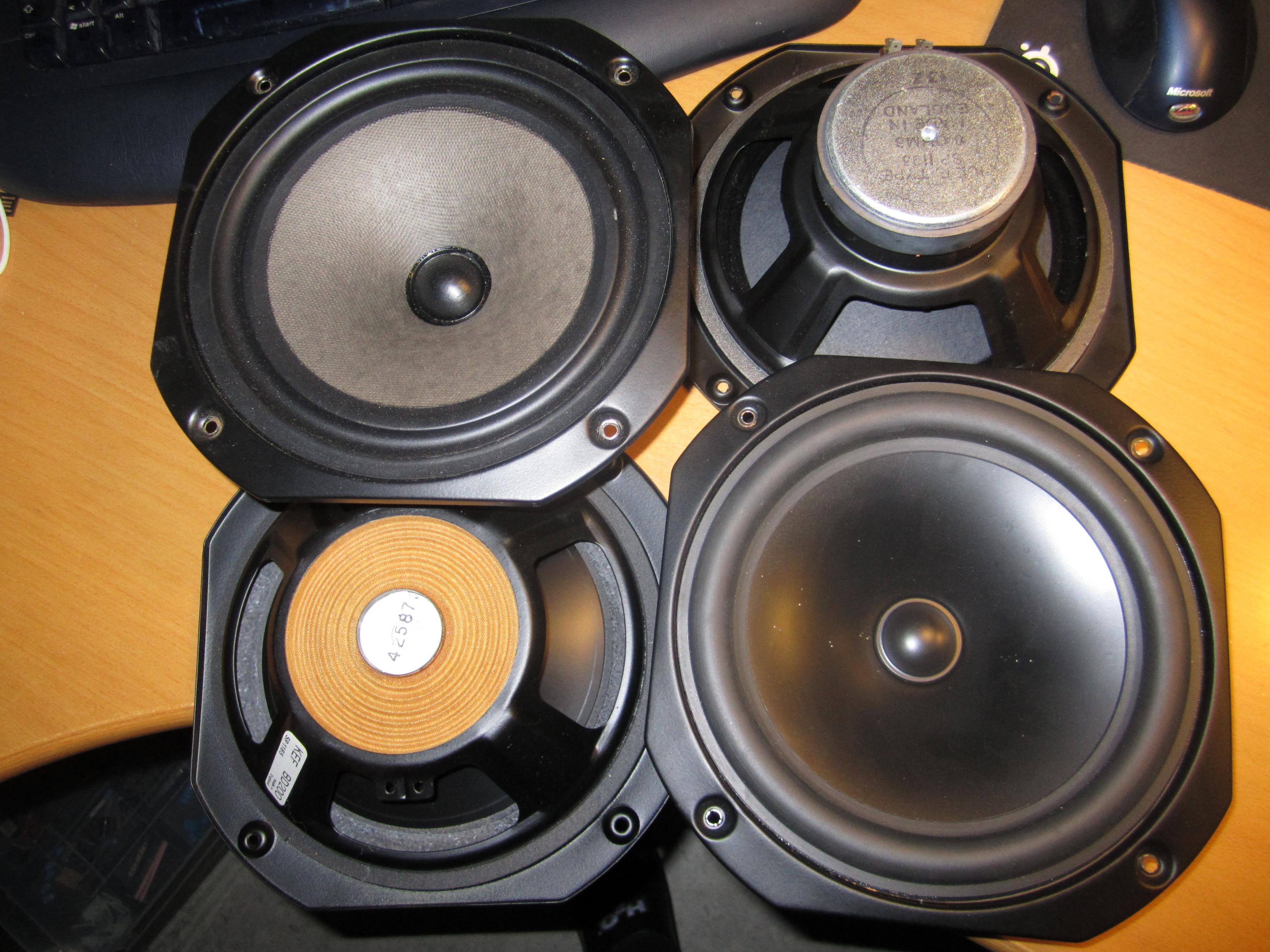

Just got myself the bass drivers from a Cara ... all 4 units for less than 15 Euro!!
Couldn´t resist the offer 😀
Does anyone have some Thiele Small parameters for these??
Bass SP-1193 and Passive SP-1185
Was thinking of making a small sub for my PC or something, maybe using the two active woofers in iso-baric and adding some weight to the passive to lower resonance ......
Thanks in advance Baldin 🙂
