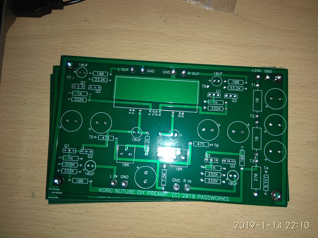

Christmas in January
The parts have arrived in Canada. Thank you Papa!
:cheers:
