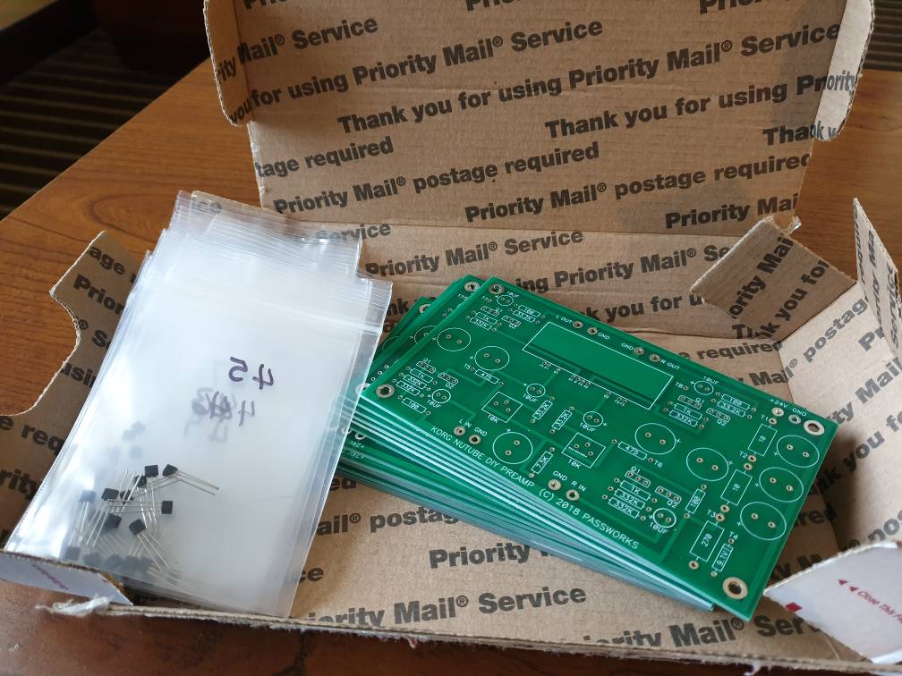

B1 with Korg Triode

Fired up the B1-Korg through a UCA202 using REW last night. Great, easy to use tool.
I put a 1K sine wave @ 1v into the B1 with T7, T8 biased at 9.4v. 2nd harmonic distortion in the left channel was ~1.08%; 2H in right channel was ~1.38%.
Forgive the extremely basic question, but what's more important? Balanced bias voltage between channels or balanced distortion measurements?
Obviously these measurements aren't scientific in the least, but I'm pretty happy how close these were to Papa's recommended 1% @ 1V 2H based just on my DMM alone.

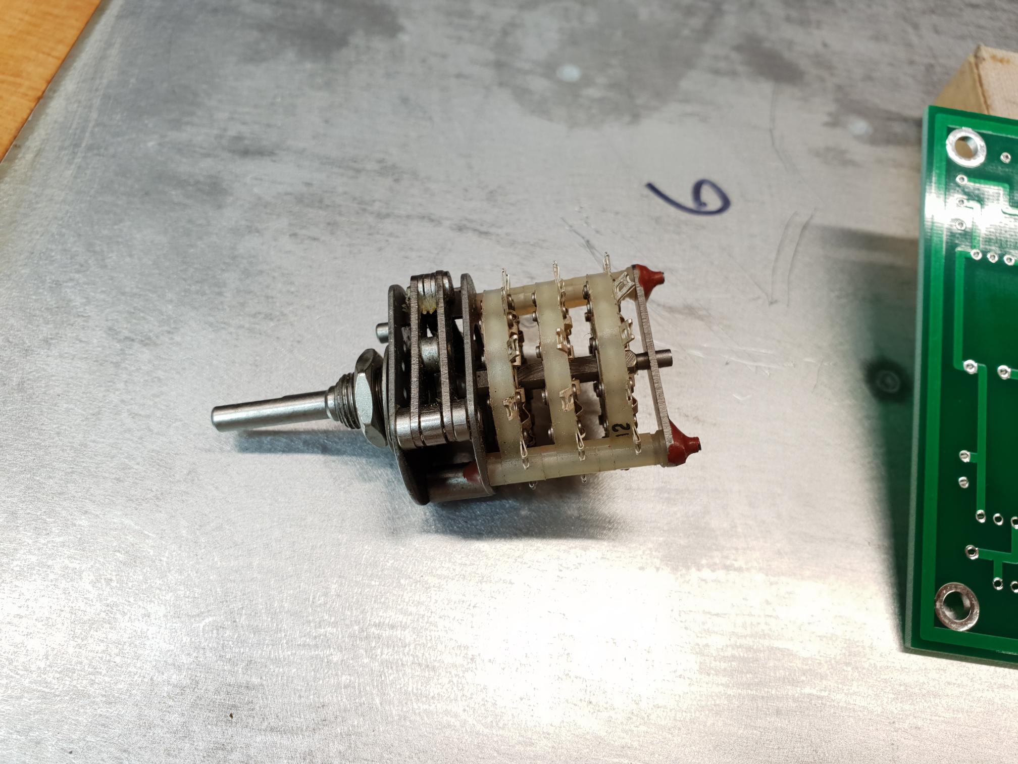

I was planning on using this selection switch as a stepped attenuator which will give me 11 postions with a single good quality resistor at each position.
On a separate project I swapped out an Alps 3 Channel 10k pot for one of these and it made a substantial improvement to the sound. Given my souce will be either a Sueezebox Touch or a Twisted Pear DAC I will be able to fine tune the volumne from there.
Would anybody know, or how to work out, what values I should use on the way up to 50k?
