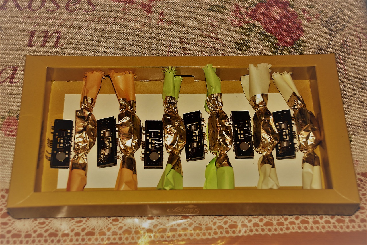

They arrived:

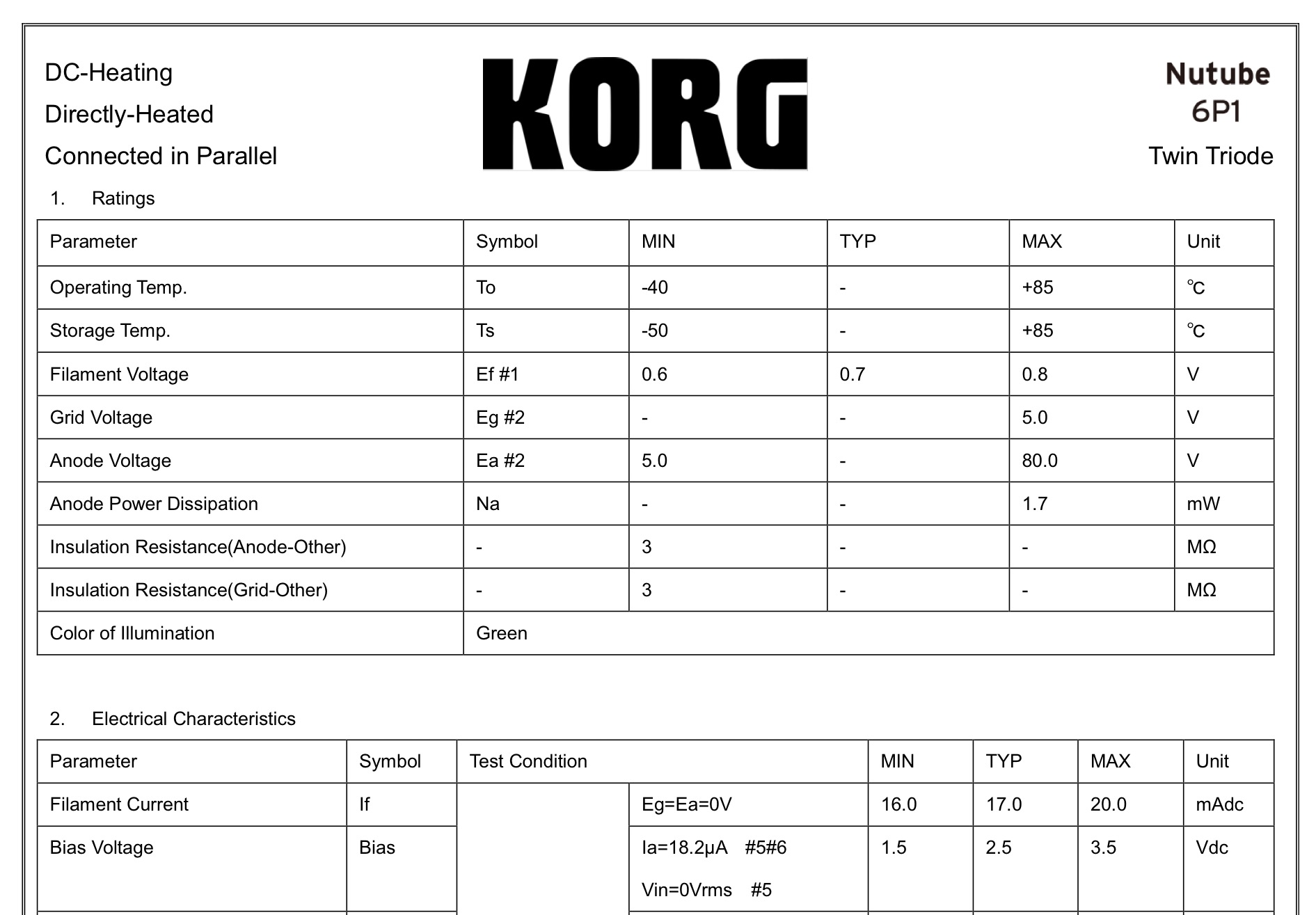

Datasheet show filament max voltage is 0.8V typical 0.7V,
max bias ~3.5V so I do need to verify what I get first time inside of my prototype.
Jfet's Idss is better ~ 7mA or 10 mA ? Need correction with add of the resistors ?
What's the principle logic is ?
Best to check the bias voltage. Korg warns that if the filament is red then
it's too high. This is regulated by the 9,1V zener, so check that as well.
I have been using Toshiba Jfets Idss 3 to 5 mA, work just fine. Fairchild
J113 parts about 8 mA Idss.
Source resistor for the DIY board current source is for setting high Idss
Jfets to lower value.
Plans are that the kit will have the Fairchilds with the appropriate
Source resistor values, typically 100 to 221 ohms.
People with matched parts and also Idss at 8 mA or less can short the
Source to Ground on the current source Jfet.
