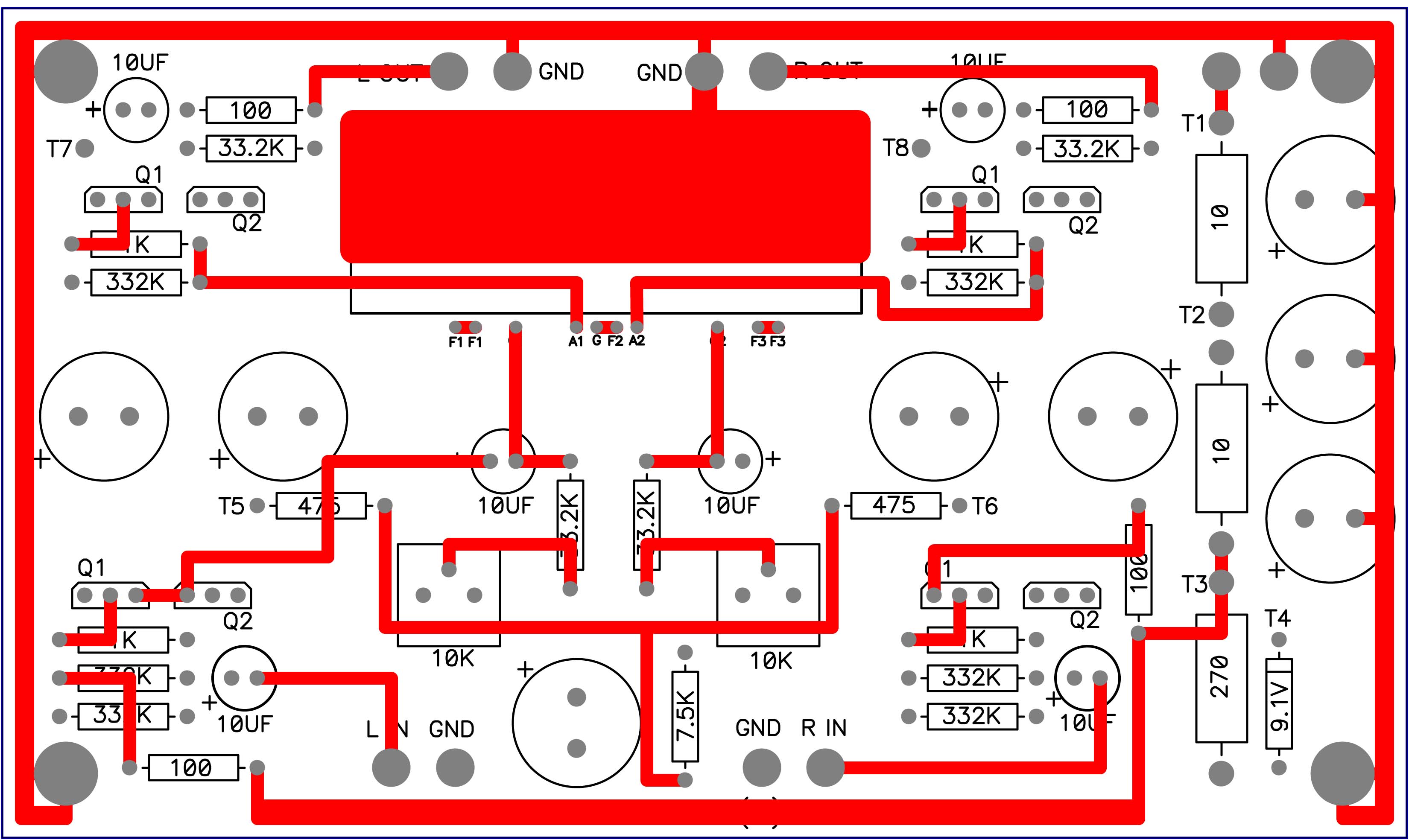

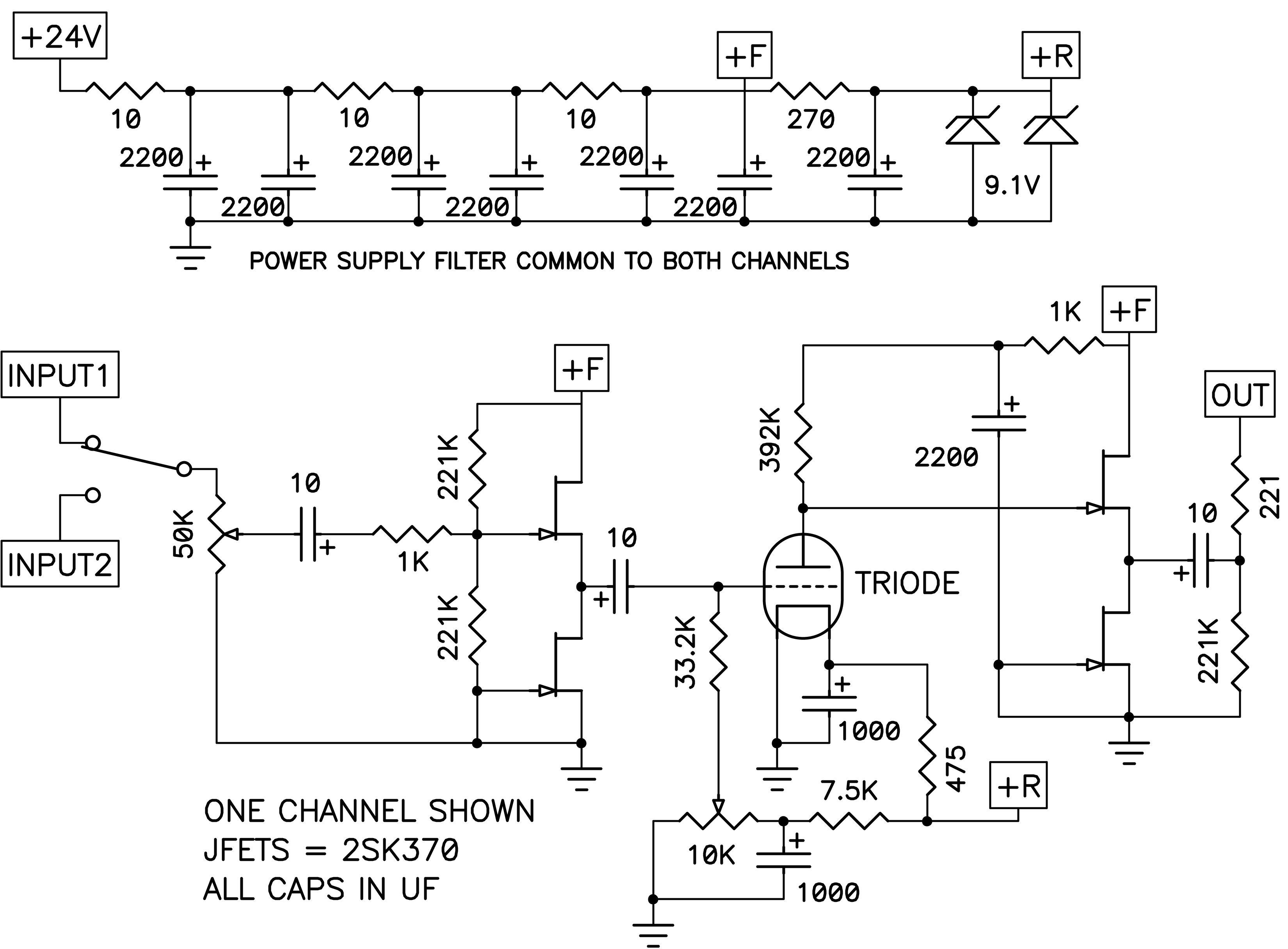

Here's another preliminary BOM geared toward USA builders. This is based on the original schematic/article and the images of the actual PCB that Mr. Pass has posted. It appears that some of the values have changed and the PSU filter uses fewer components.
For reference, see the following info previously posted in this thread:
Schematic: https://www.diyaudio.com/forums/attachments/pass-labs/640693d1508259787-b1-korg-triode-b1-korg-gif

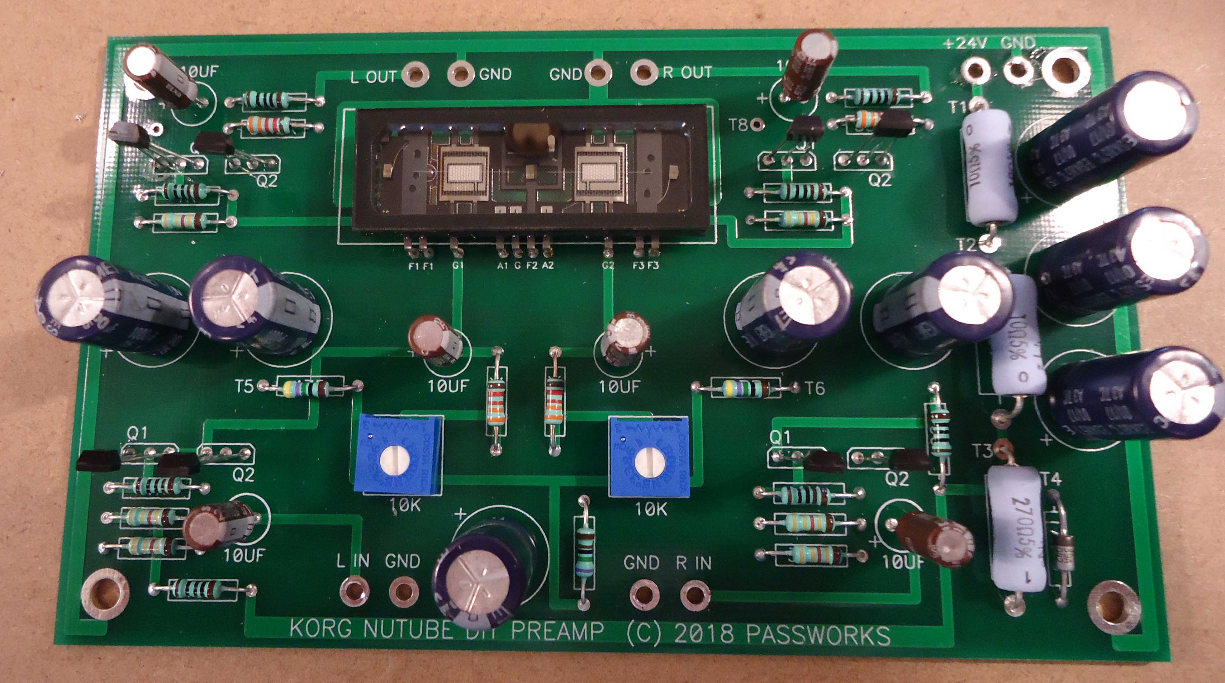

PCB Layout: https://www.diyaudio.com/forums/attachments/pass-labs/715558d1542221754-b1-korg-triode-tubetop-jpg
Stuffed Board: https://www.diyaudio.com/forums/attachments/pass-labs/720130d1544033001-b1-korg-triode-nutube-2-jpg
This is what I'm planning on using to put it together (assuming I haven't omitted anything or am incorrect in values/lead spacing). This is mainly because I already have some of the components on hand, so please feel free to pick, choose, update, and share. The manufacturer number column should include active links to US suppliers. Everything is in stock right now.
For this, ratings are 1/2 watt resistors other than the PSU filter; 1/2 watt Zener diode; 25v capacitors in the PSU (which I know is close, but it appears Mr. Pass used these 25v Kemet caps in his build).
Hopefully this helps get people moving forward.

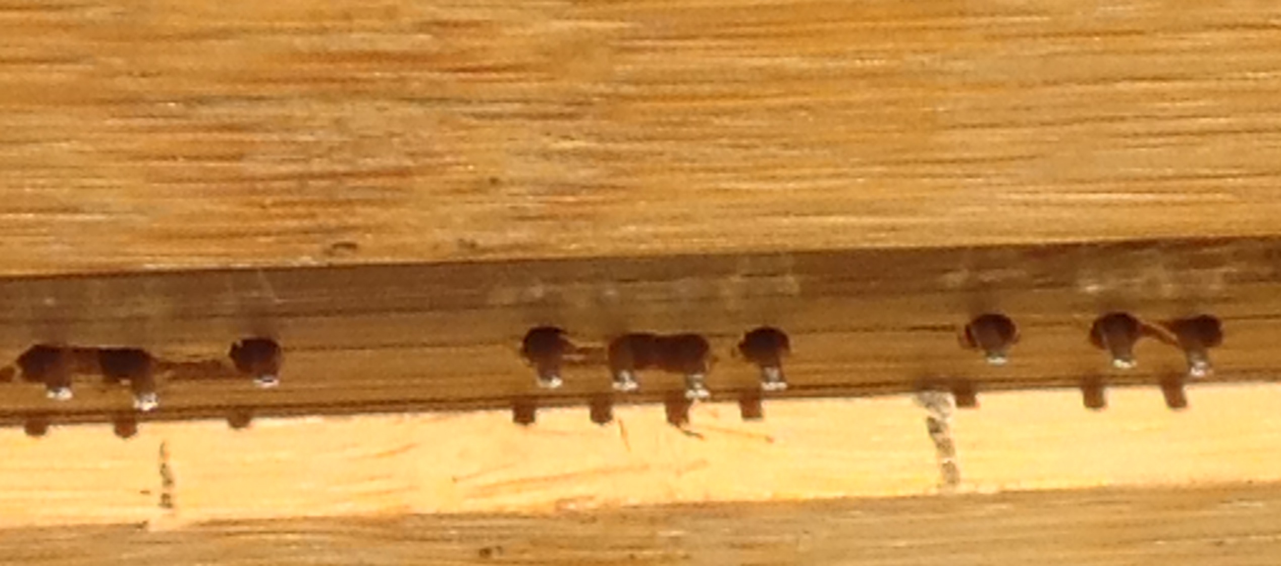

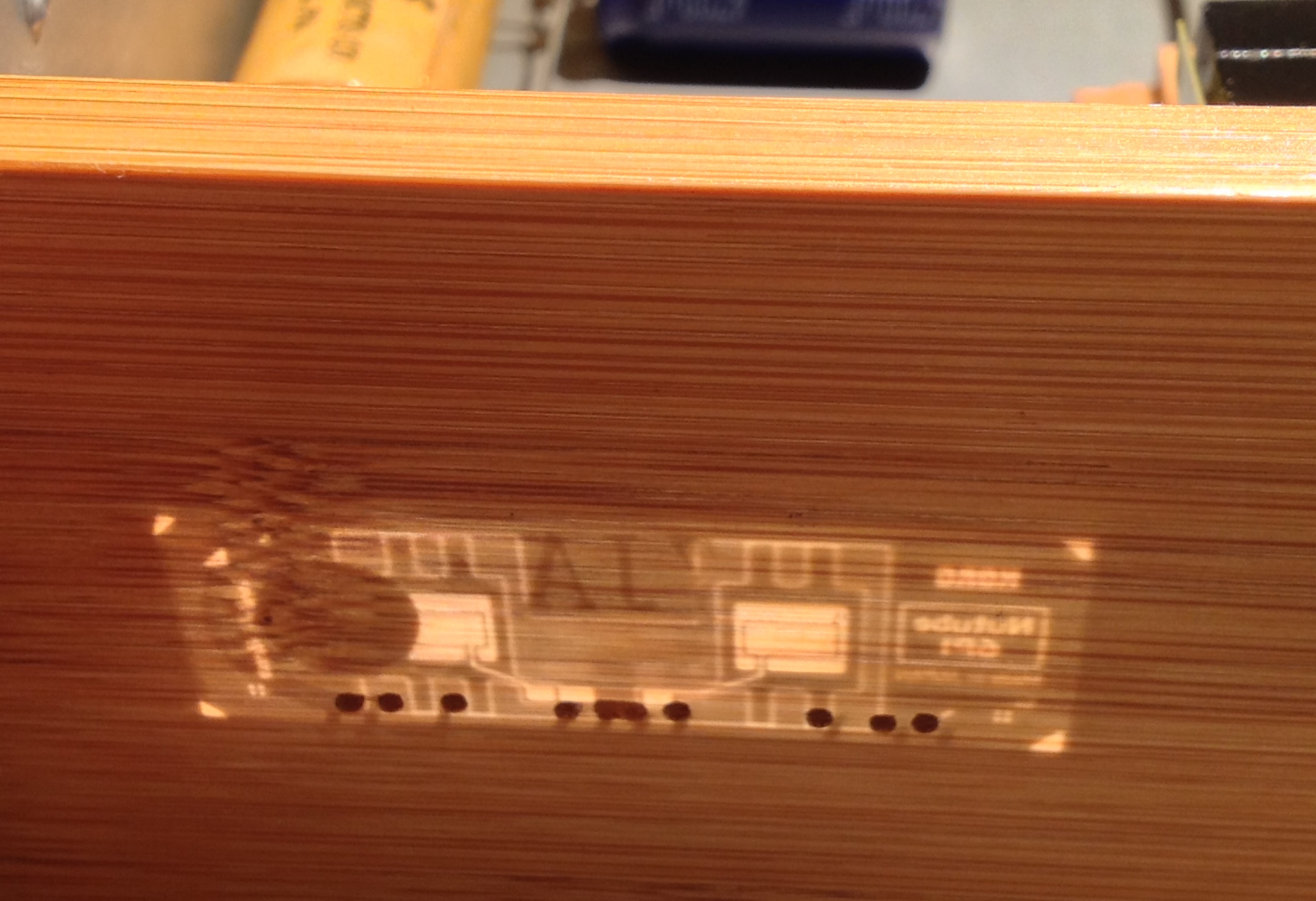

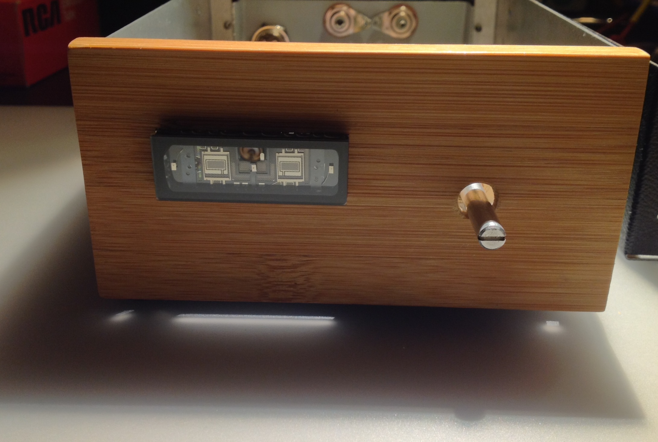

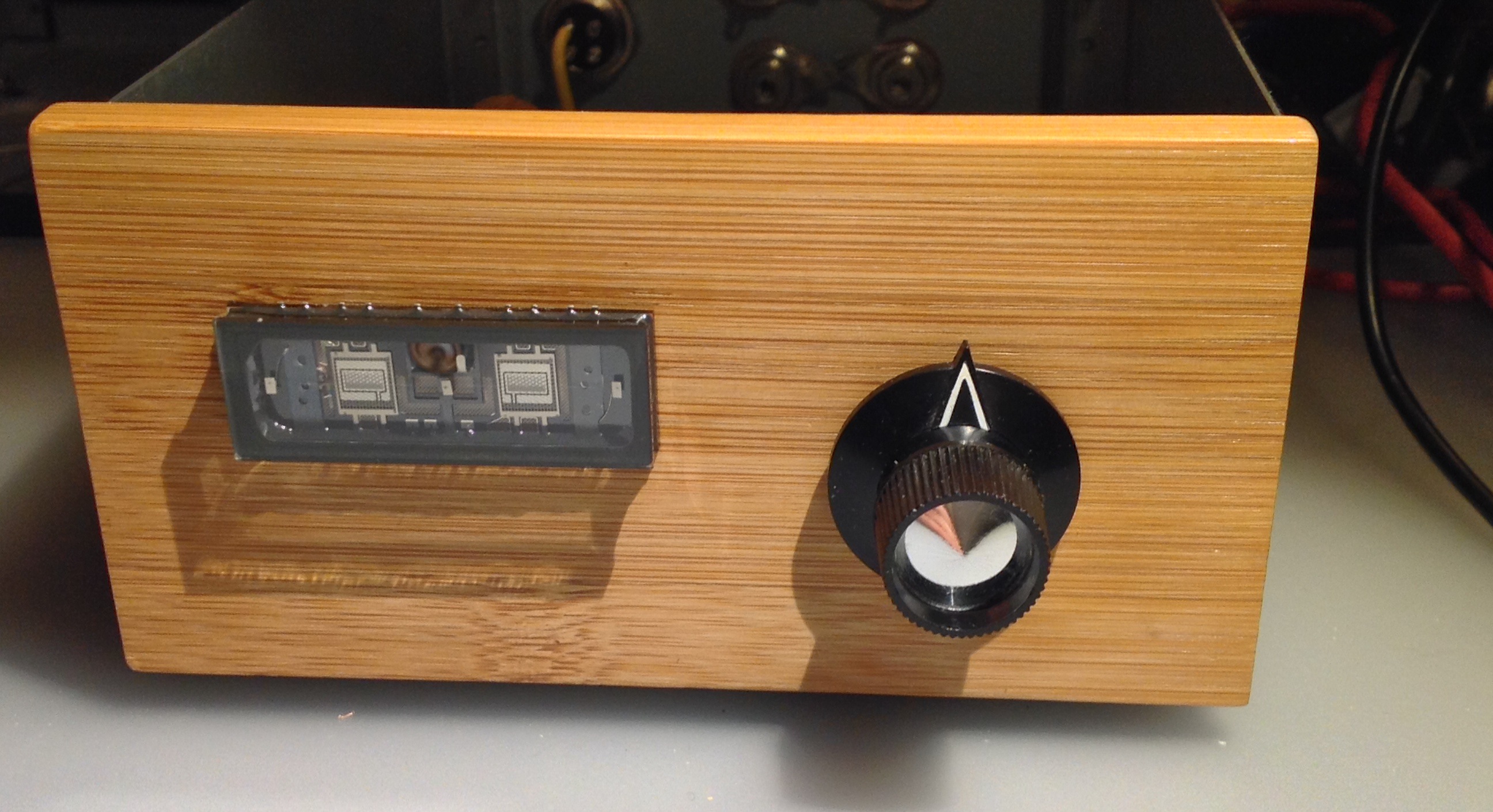

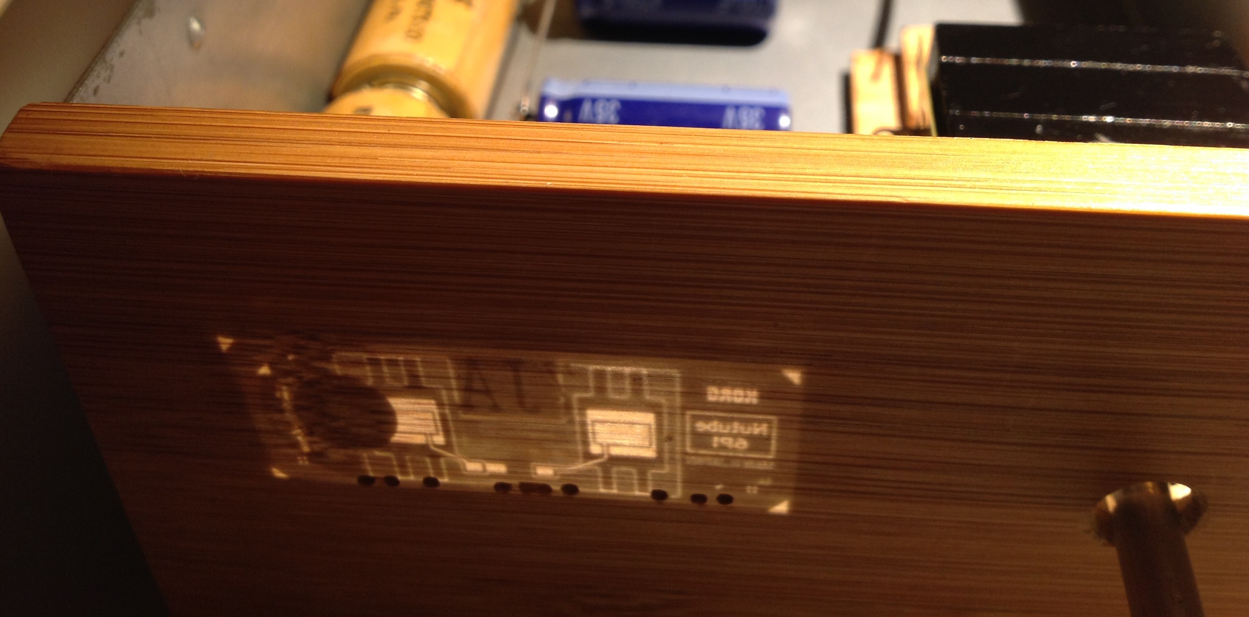

Today finished all mechanical work on the chassis: psu and rca connectors , potentiometer on the plate front.
Audio path is a work in progress....please what is the correct Nutube filament voltage ?
Wood was drilled on the kitchen table :D
Korg 10 pins are now accessible from the inside.
Wiring of the circuit on the perfboards look complex.
Papa pcb's show test points number T1 to T8.
Very interesting I do like verify first time sans triode
