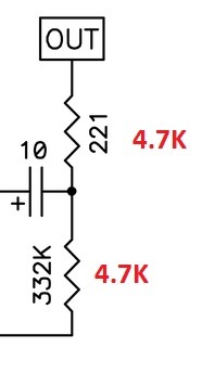

Papa Nelson,

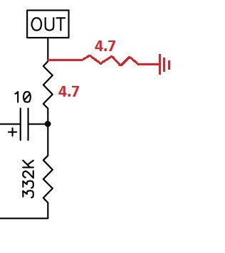

I don'tknow what is the maximum output impedance I can accept. I am using different power amps with input impedance from 10k to 22k. (Heed Canopus 10K, Heed Obelisk 22K). I am thinking about building two ACA (bridged monos).
How much gain i want to lose ? If -3dB will be not enough, than -6dB.
  • Thank You
Reactions: Ixnay
Like this ?
Papa Nelson and Zen Mod thank you so much for your help 🙂
Yes, of course Kiloohms, not Ohms 🙂

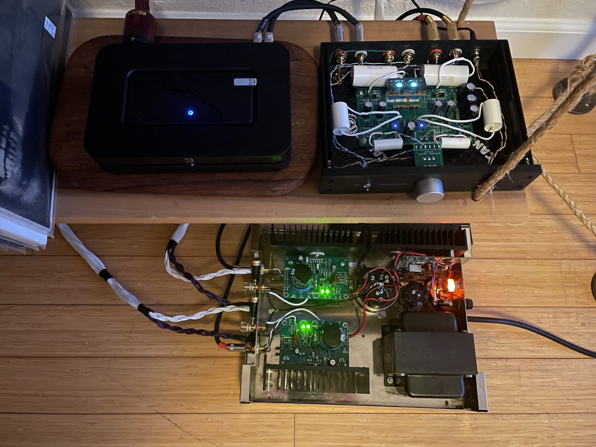

Success!
Sounds great and loving how it plays with my setup. Thank you for the @Ben Mah for the help identifying my issue with the JFET. Also, thank you @ClaudeG for the details on your build. This was my first and won't be my last. I'm organizing leftover parts to put another one together for a second system. Fun Stuff!

Success!
Is there a reason you placed different sized caps at the locations they are at or just randomly picked one of three "10uF" marked sites?

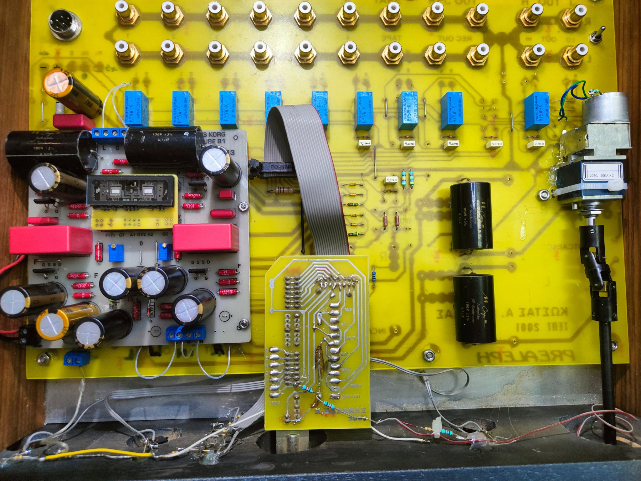

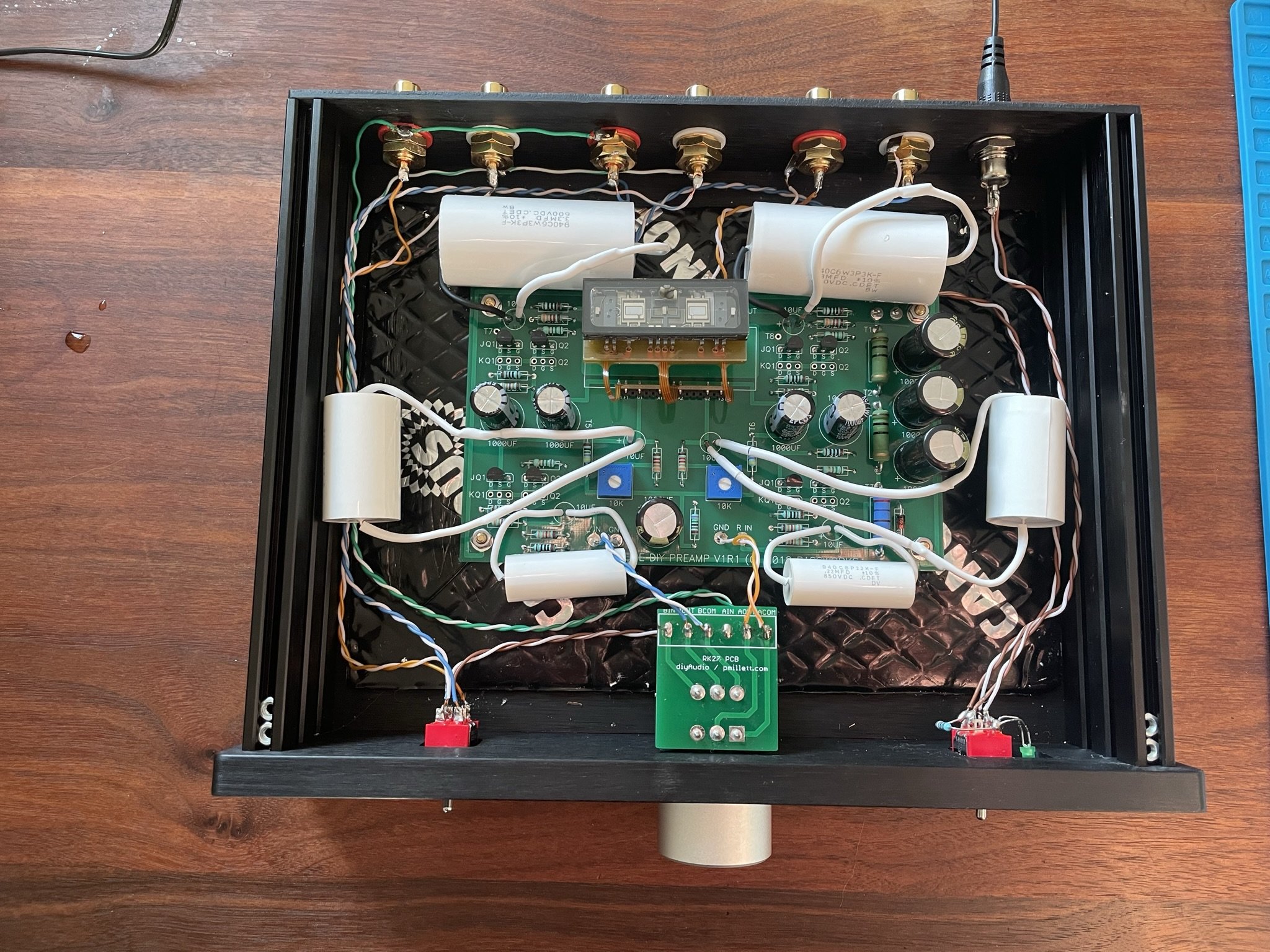

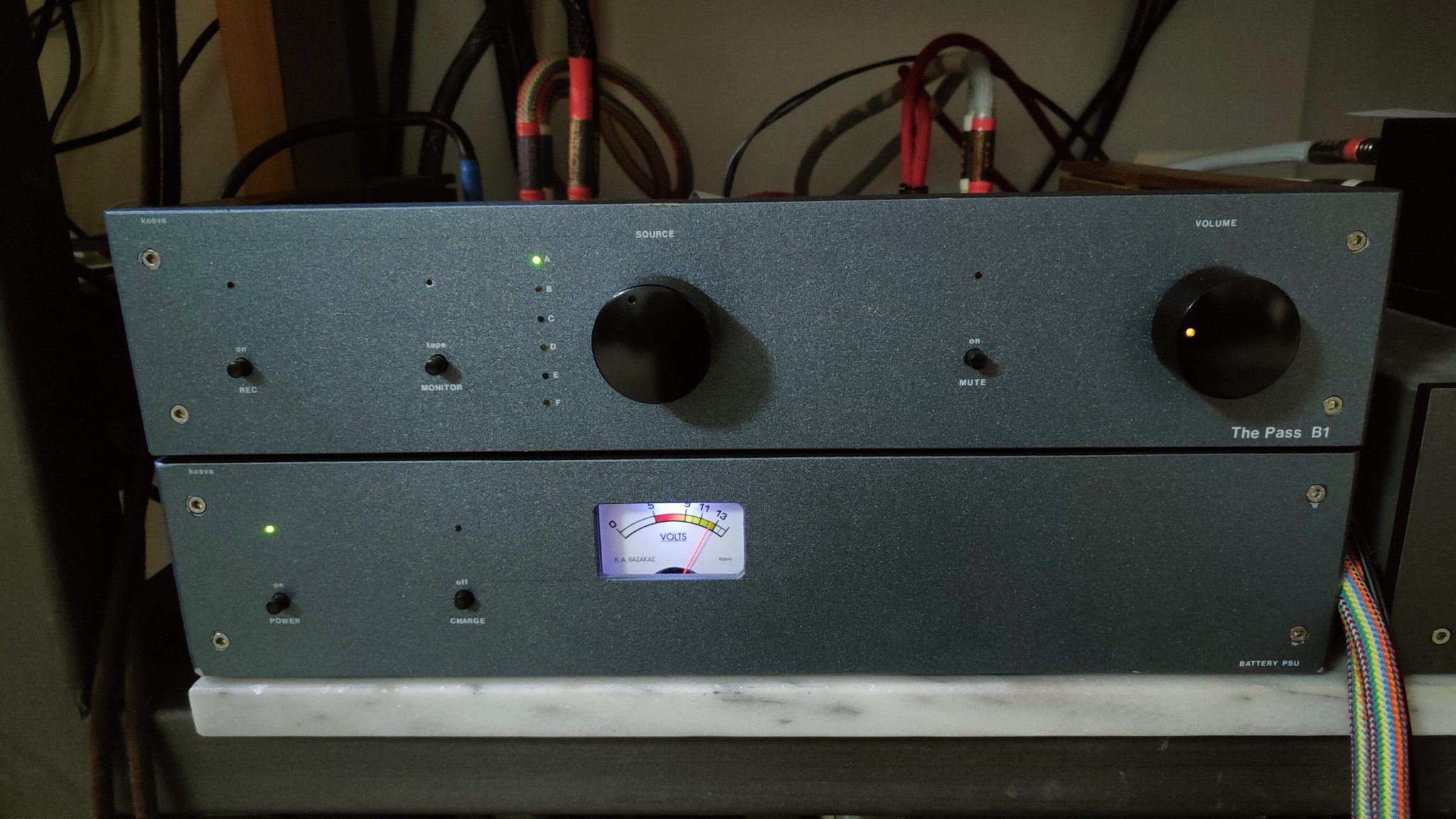

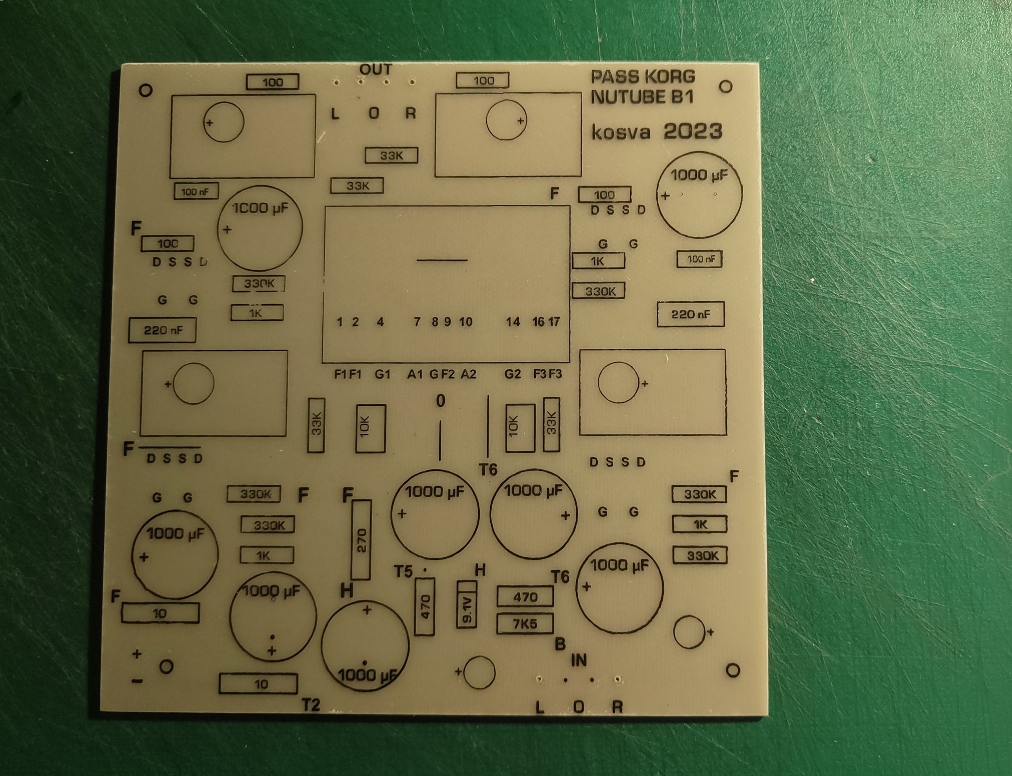

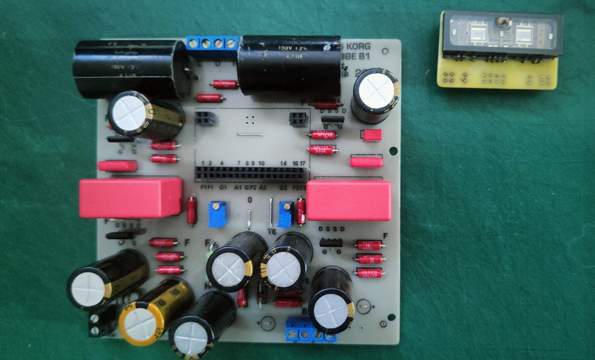

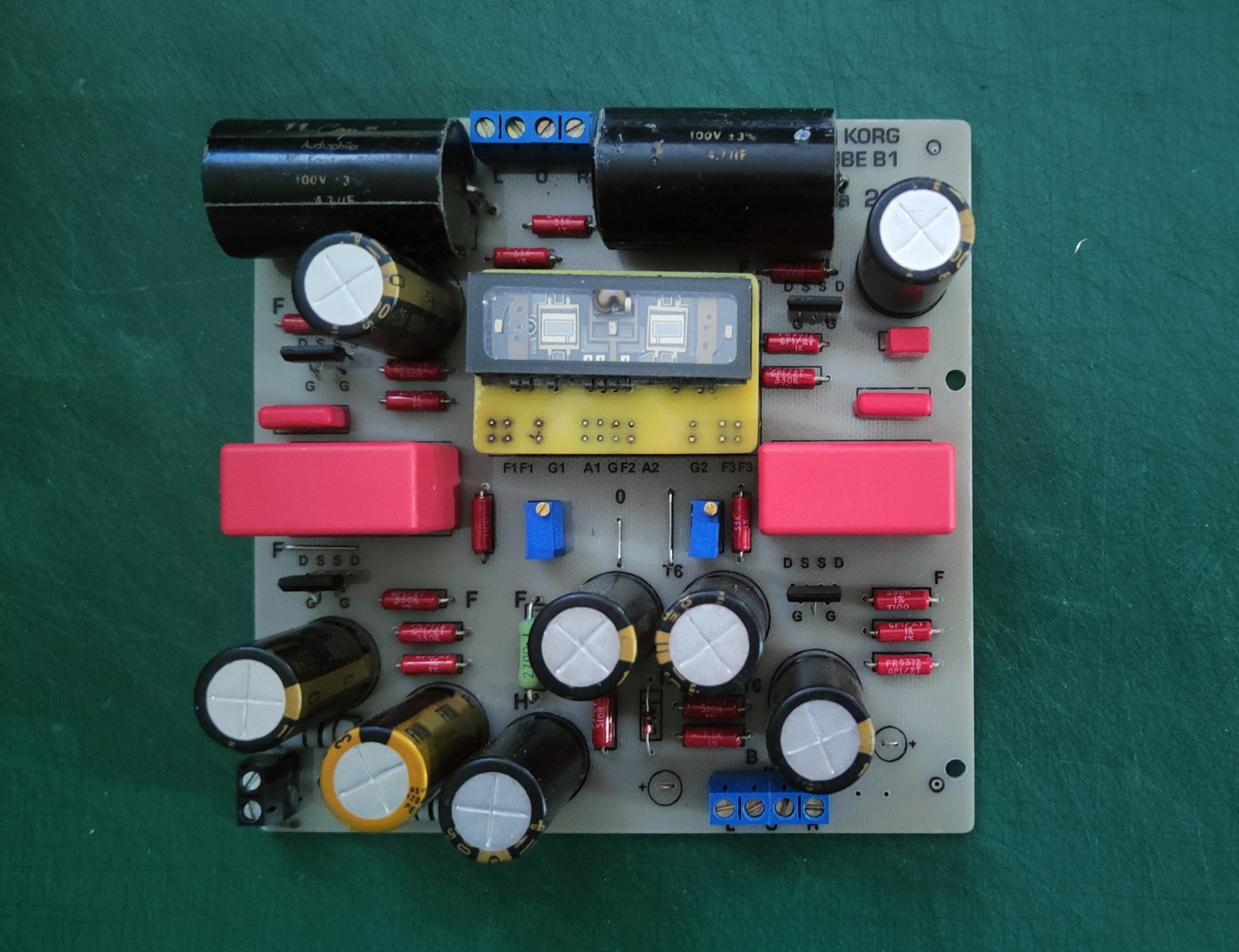

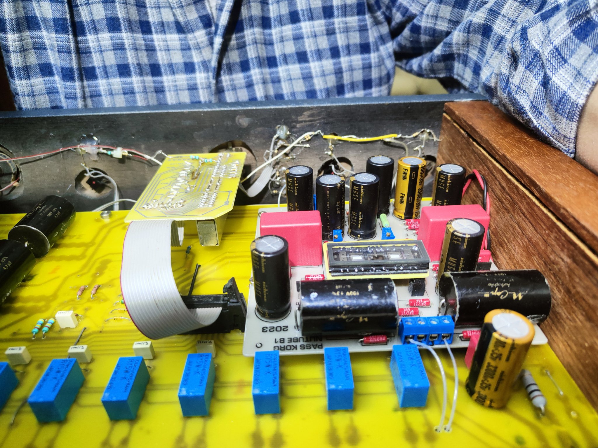

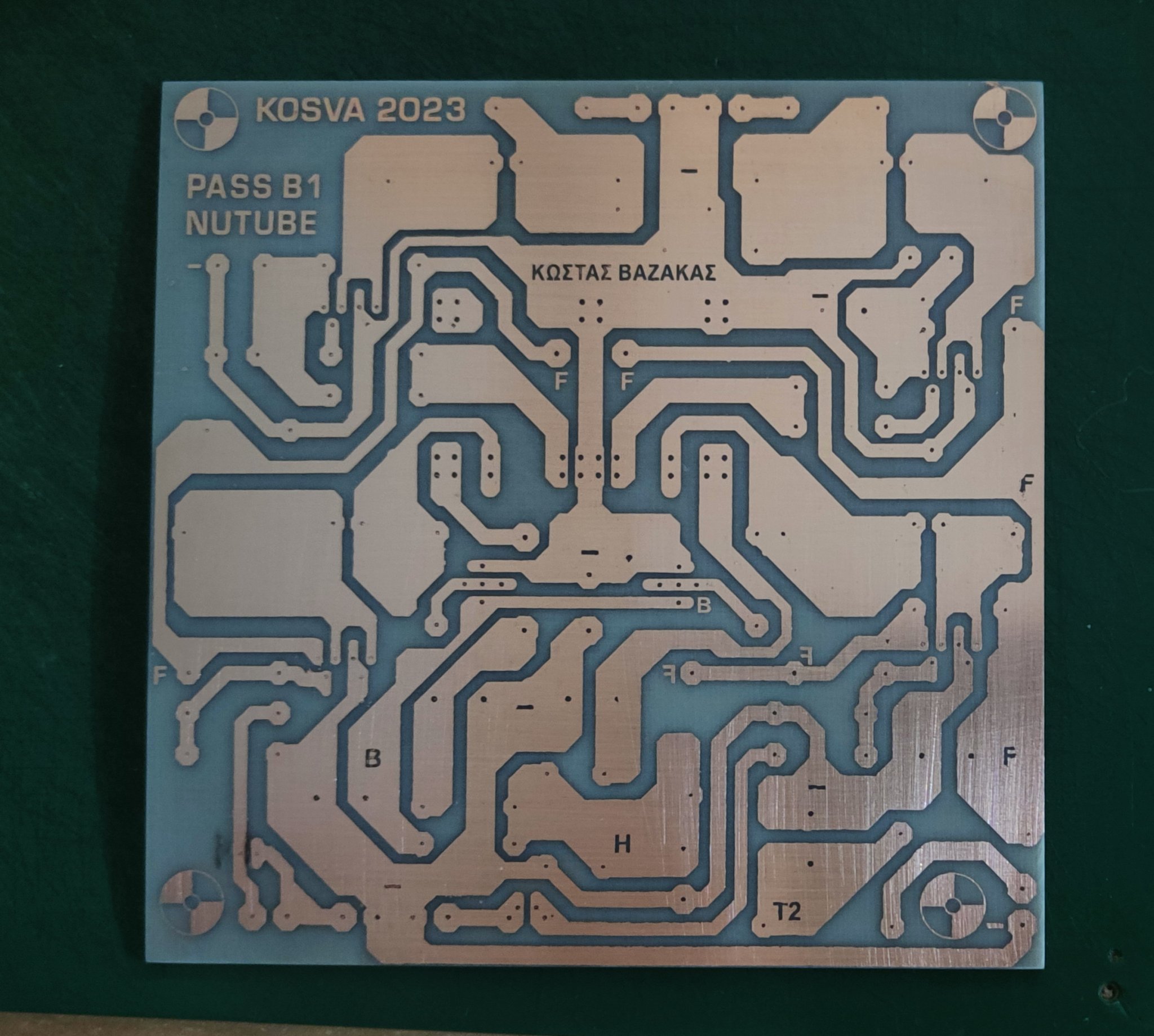

Hi
I am sending a few pics of my new NUTUBE B1. It is build on a PCB which was desighned by COREL DRAW.
Excellent sound, full of music, with very pleasand listening and much better than the DC B1 or my Grounded Grid tube preamplifiers. The power amps are two DIY Pass Aleph 30 monoblocks.
I placed the PCB on the mother board of my old AlephL and DCB1 enclosure and is powered by two (in series) 12v acid lead batteries .
I have a lot of 2SK389 on my shelf so as I made the pcbs for them and I also use MUNDORF 4.7 uF capacitors and WIMA MKP 2.2 uF parallel with
ELNA Silmic 10uF.
The T7,8 voltages was finally adjusted at 9.5V. After playing for more than 100 hours the voltages are remaining at 9.55-9.57 V .
Because of the 2SK389 I didn't use the R1 resistors.
I want to thank Nelson again for sharing his designs with the DIYAUDIO community all these years.
Kostas A. Vazakas
Egio, Greece
