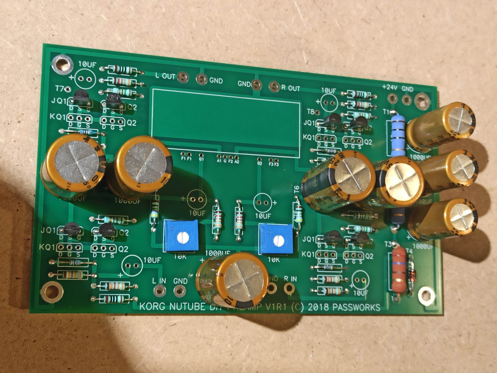

Finished my build today. Everything was straightforward; all test points as described in Nelson's document showed correct values.
First listening test wasn't successful as the preamp has too much gain for the set I connected it to.
I run a Raspberry/Hifiberry DAC HD and a Quad 66 preamp, connected to a Quad 306 poweramp in my office room: replacing the 66 preamp with the NuTube didn't work well, as the signal level to the poweramp was way to high, the signal itself completely saturated, even at the lowest possible level of the NuTube's volume pot.
I guess that's my own fault as the Quad stuff runs on lower signal level. I will put a test bed in place and check the input level vs. the output signal just before clipping. The I need to adjust source output and poweramp input levels to fit the NuTube.

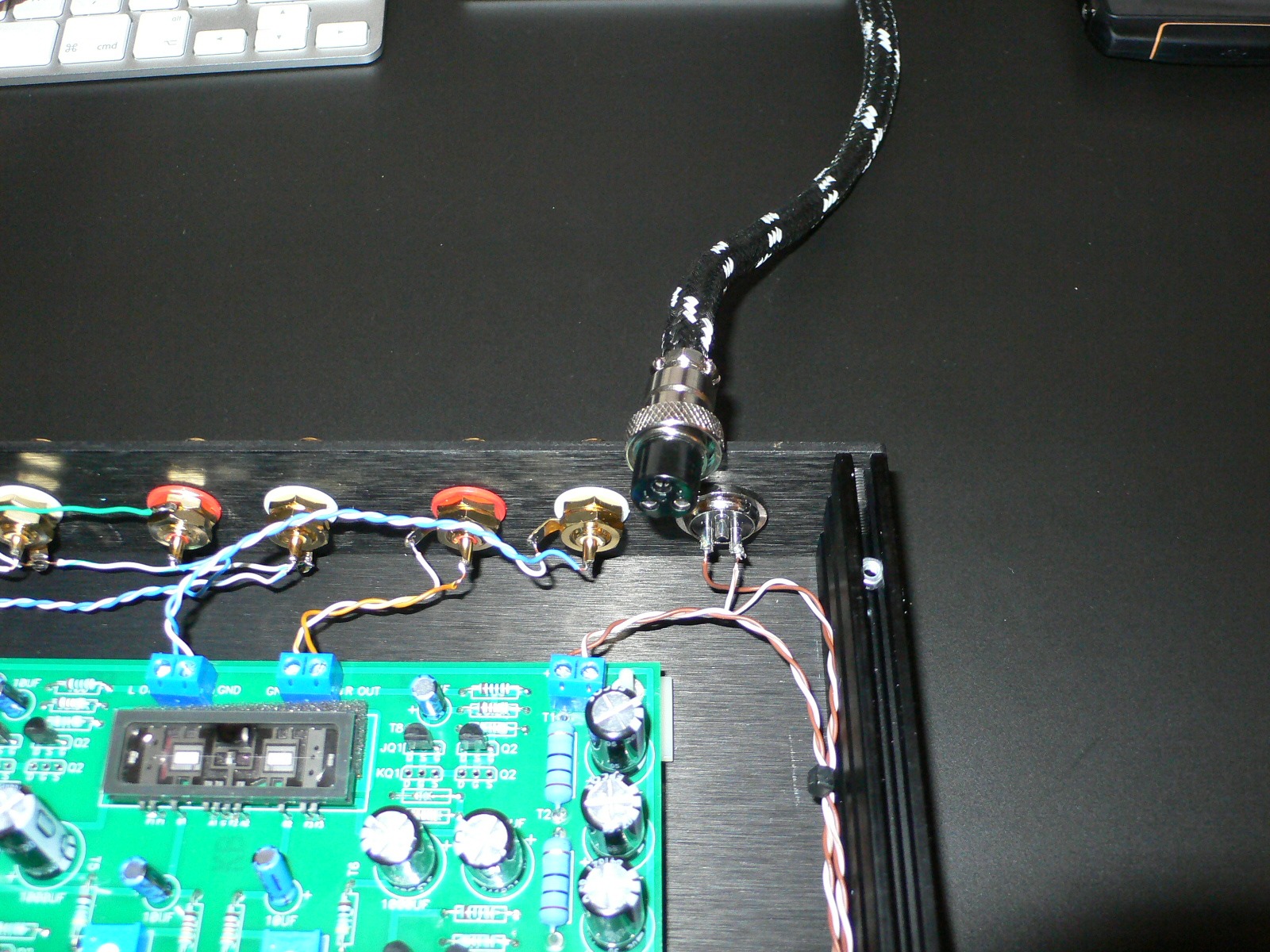

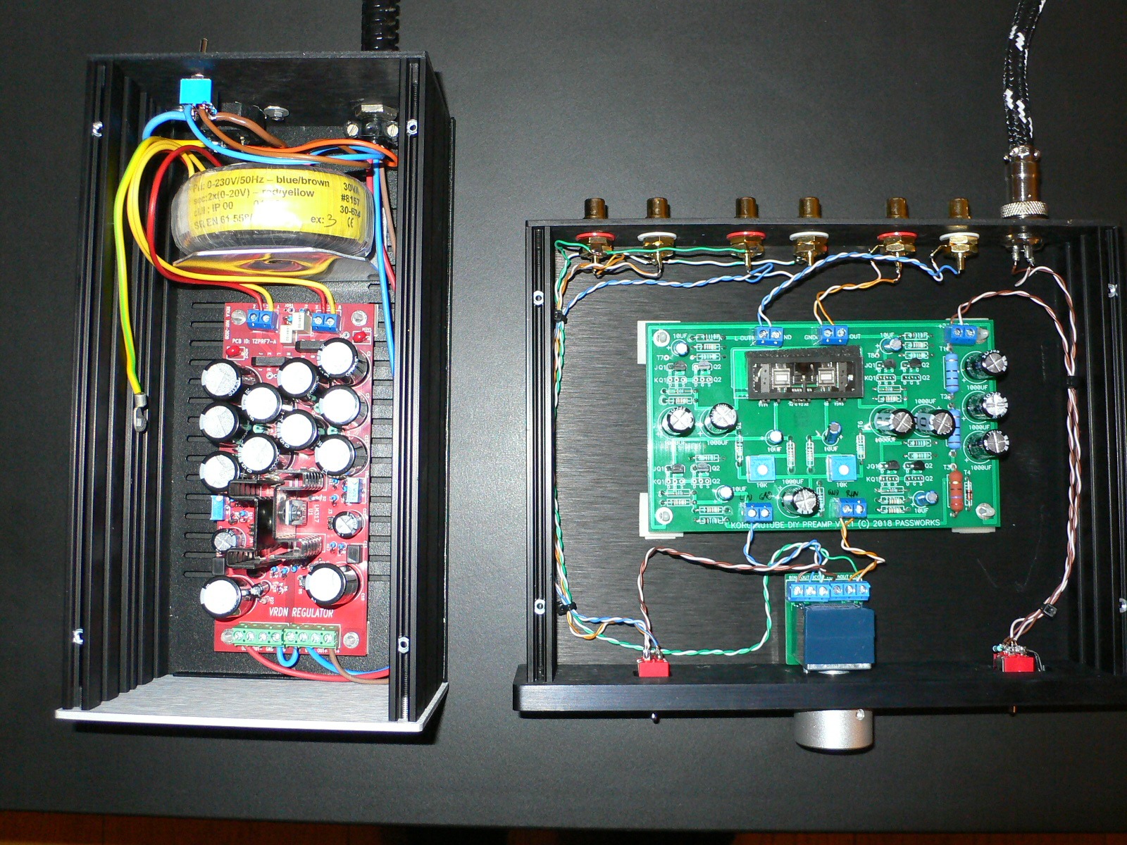

I built a VRDN-based external power supply (designed by Mark Johnson for the DIYAudio forum) for the NuTube, in order to provide it a low noise and stable 24VDC power (stable at least until 1.5A)
The PSU's output is +12V ,0V, and -12V; the connector is grounded, so that the NuTube's case is grounded as well.The NuTube's PCB is isolated from the case. For the NuTube, I only use the +12V and -12V connections of the PSU.
The test point T1 shows 24.1V, and is stable until 1.5 Amps ( I didn't test higher loads).
T5 shows 0.594V, and T6 shows 0.615V.
T7 was adjusted to 9.505V, and T8 to 9.51V.
I will report my findings on the test bed: next listening test maybe with the Q17 poweramp from Tibi Vical from the DIYAudio forum; I don't want change my Quad setup, as it works like a charm.

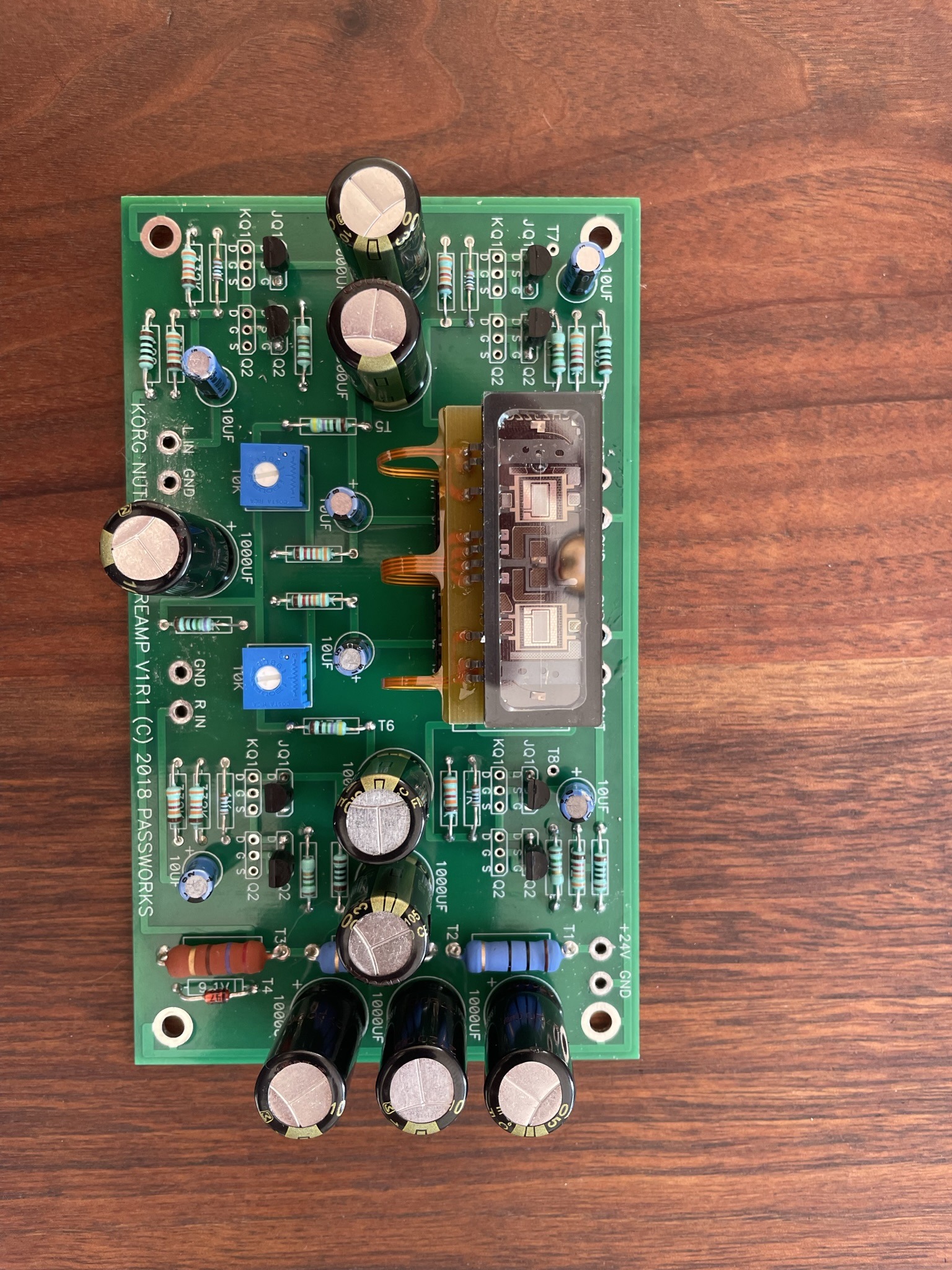

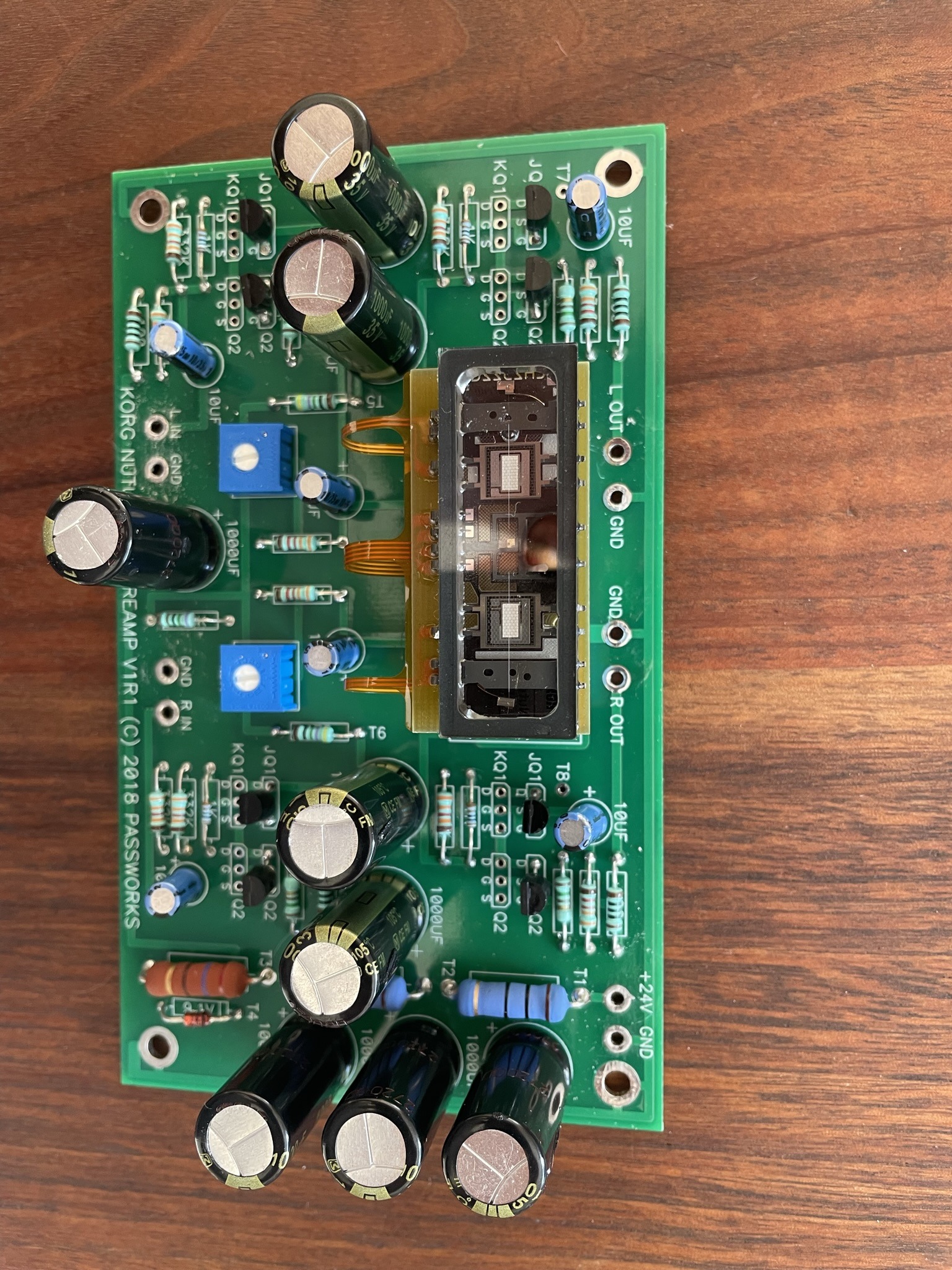

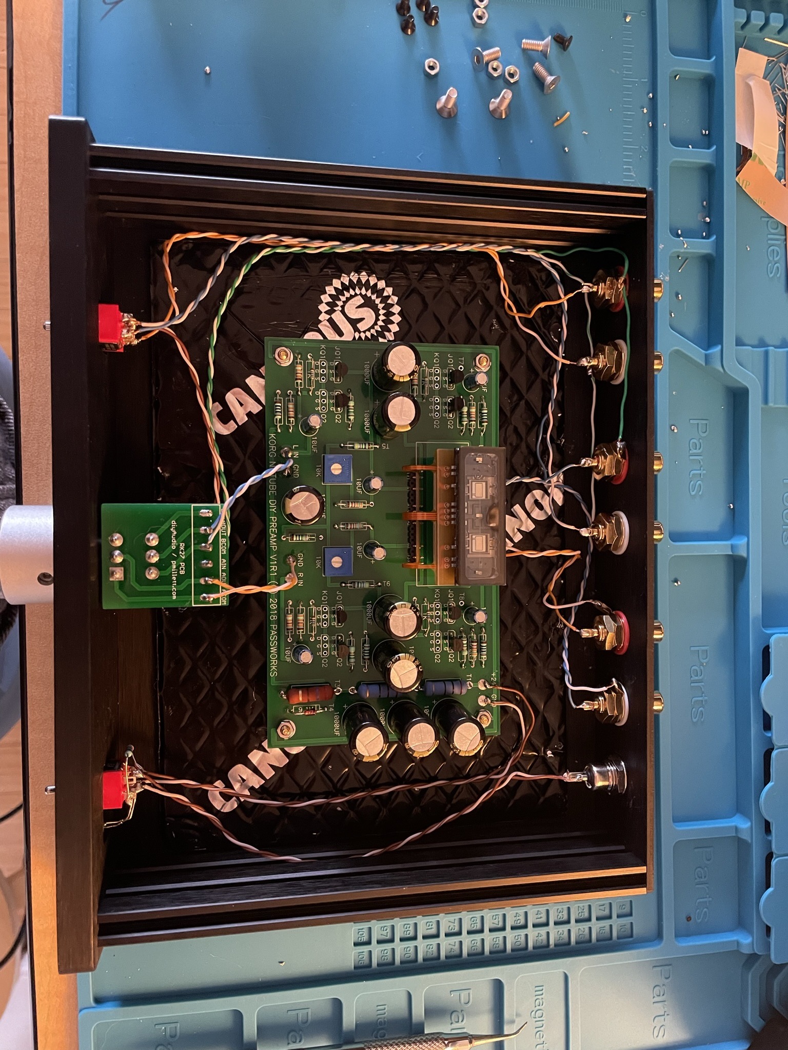

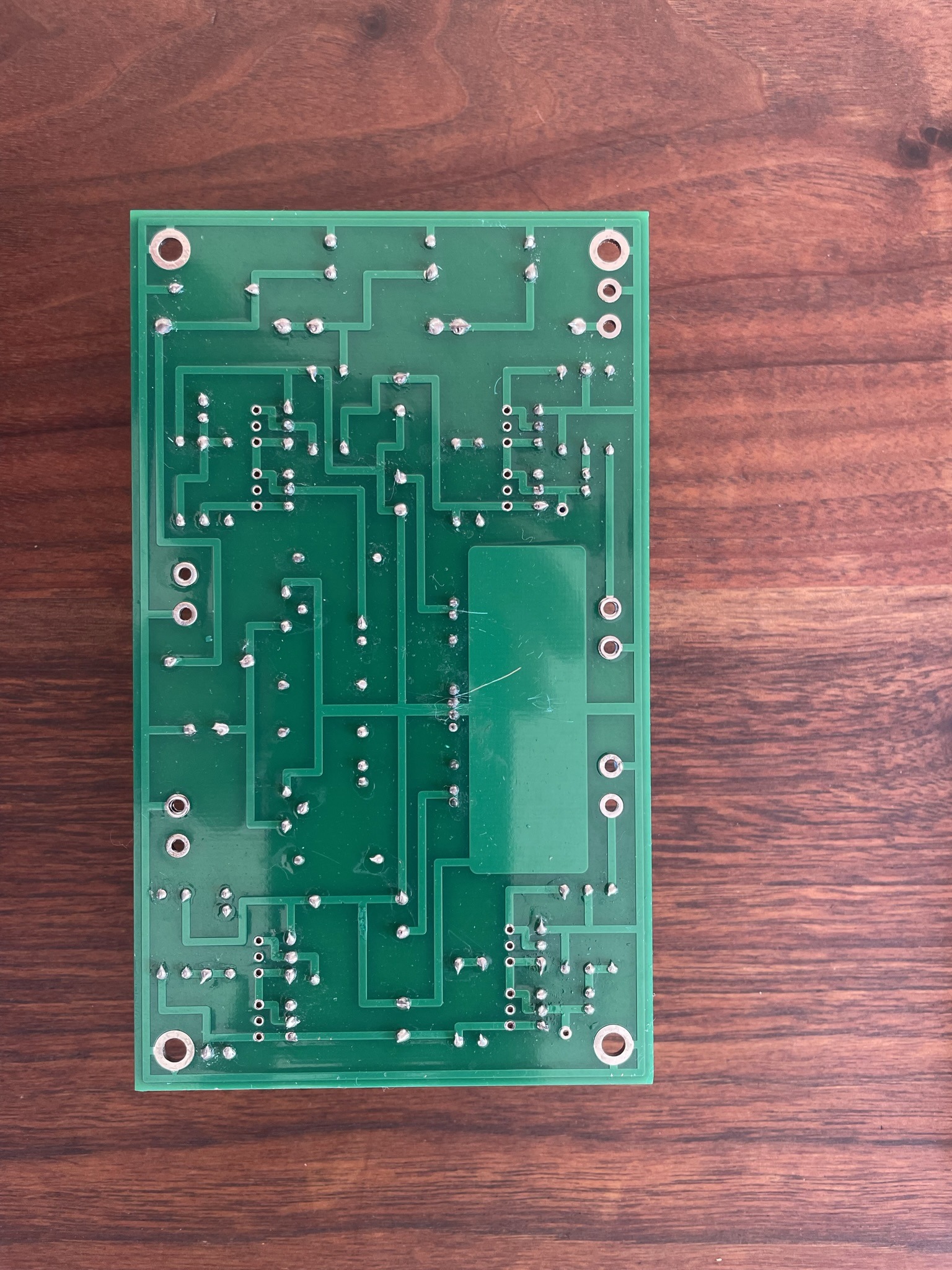

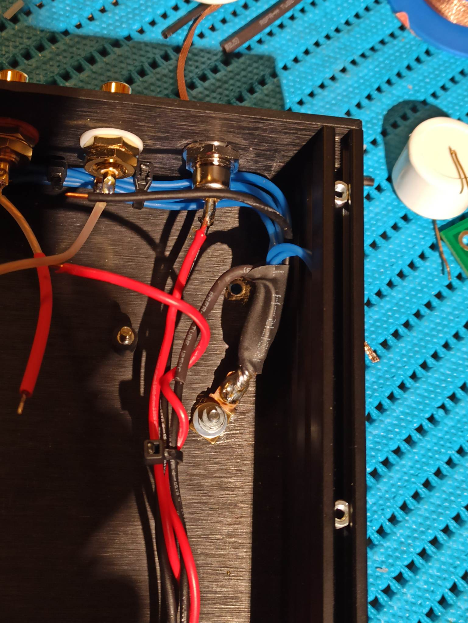

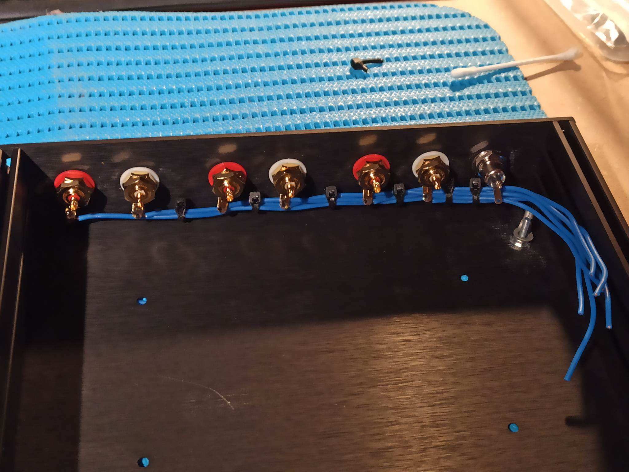

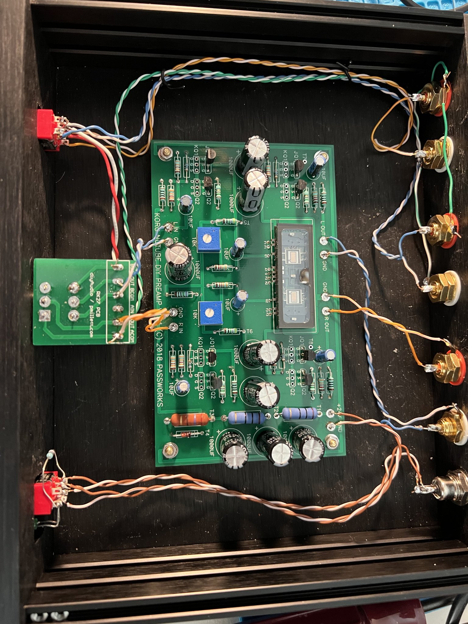

In need of some help to save my build.
Just built a Korg Nutube B1 preamplifier. Hooked it up and it played great! Not bad for my first build, and really cool that Mr. Nelson provides this to us all to build. Then things went sideways.
I swapped another amplifier in to test it before starting a rebuild on the amplifier, it apparently had a bad channel (probably shouldn't have done that). Took that amplifier out, put the other amplifier back in, and after a few minutes of listening I heard a small pop..... then the right channel went pretty much silent. Checked all my connector cables and the music plays fine with the cables with out the Korg Nutube B1 Preamplifier. Hmm... What did I do?
Now, I've read through this thread to figure out how to work through a process of elimination. Read post #1 of this thread for Nelson's article and all the test points for both channels are measuring fine. I hadn't properly adjusted the 10K resistors to get the 10V at T7 and T8. So I adjusted those and both test points are now just below 10V. The Nutube turns on and is glowing blue, appears to still have the filament, and the Left channel sounds great. Read the post about a volume pot problem. Swapped the right channel wires from the volume pot to the left and everything sounds great. Swap the left to the right and the music plays at an extremely low volume and also sounds a bit off.
I then tried resoldering the right output wires and the RCA connectors. Cleaned the bottom of the board and checked all my soldering joints. Still no music from the right channel.
Thoughts? Did I kill the Nutube? Seems to glow and work. What else do I need to check? I've only got a multimeter so no fancy equipment to investigate this with.
Here are some photos of my Nutube B1. Let me know if you have any thoughts on how to solve this conundrum. Also, thank you for your time, I think my laddy is getting pretty tired of me staring into this black box. Appreciate your guidance.
......... Swapped the right channel wires from the volume pot to the left and everything sounds great. ........
I am confused - which wires did you swap? Did you connect the volume pot right channel output to the Nutube board left channel input?
"...everything sounds great..." One channel only or both channels sounds great?
......Swap the left to the right and the music plays at an extremely low volume and also sounds a bit off........
Same question - exactly what wires did you swap, and which Nutube channel had low volume, and what did the other channel sound like?
After much thought, it seems to me that you connected the volume pot right channel output to the Nutube board left channel and that worked. Then you connected the volume pot left channel output to the Nutube board right channel and the output was low. I suppose I am a bit slow so it would have helped me if you were more precise in your description. Trouble shooting over the internet is tough as it is.
Since the Nutube voltages measured within specifications, the Nutube is probably ok. But the JFETs may have been damaged.
Please measure the voltage drop across all four R1 resistors.

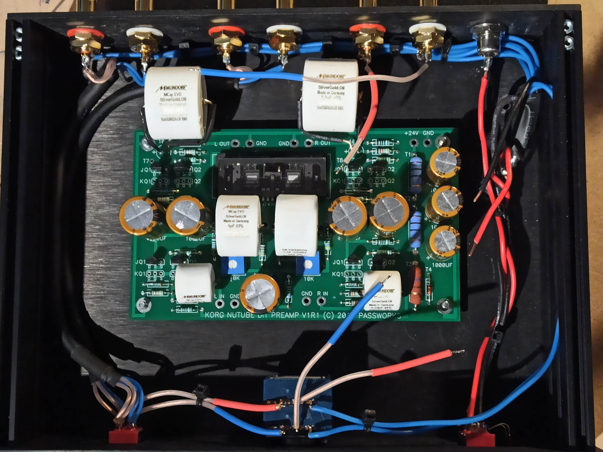

I have build my B1 Nutube. The sound is very good, i used some good Mundorf Silver Gold Oil (0,22uF, 1uF, 3.3uF) from old speaker projects, all cables are Mogami (from 2534 and 2349), star grounding, ps are are 3x 2200 Nichicons, the rest are 1000uF gold Nichicons.
I measured those voltages, tried three different 24V ps.
t1 23,94
t2 23,18
t3 22,4
t4 8,65
t5 0,58
t6 0,6
t7 10,5 - it is minimal possible voltage, i can't go lower
t8 9,25 - it is minimal possible voltage, i can't go lower
My questions:
1. t4 8,6V ? is it OK ?
2. t7 10,5V ? why i can't go lower ?
Now i am listening with t7/8 13.5V and reversed absolute phase at the dac.
Thank you Papa Nelson for this great sounding project 🙂
