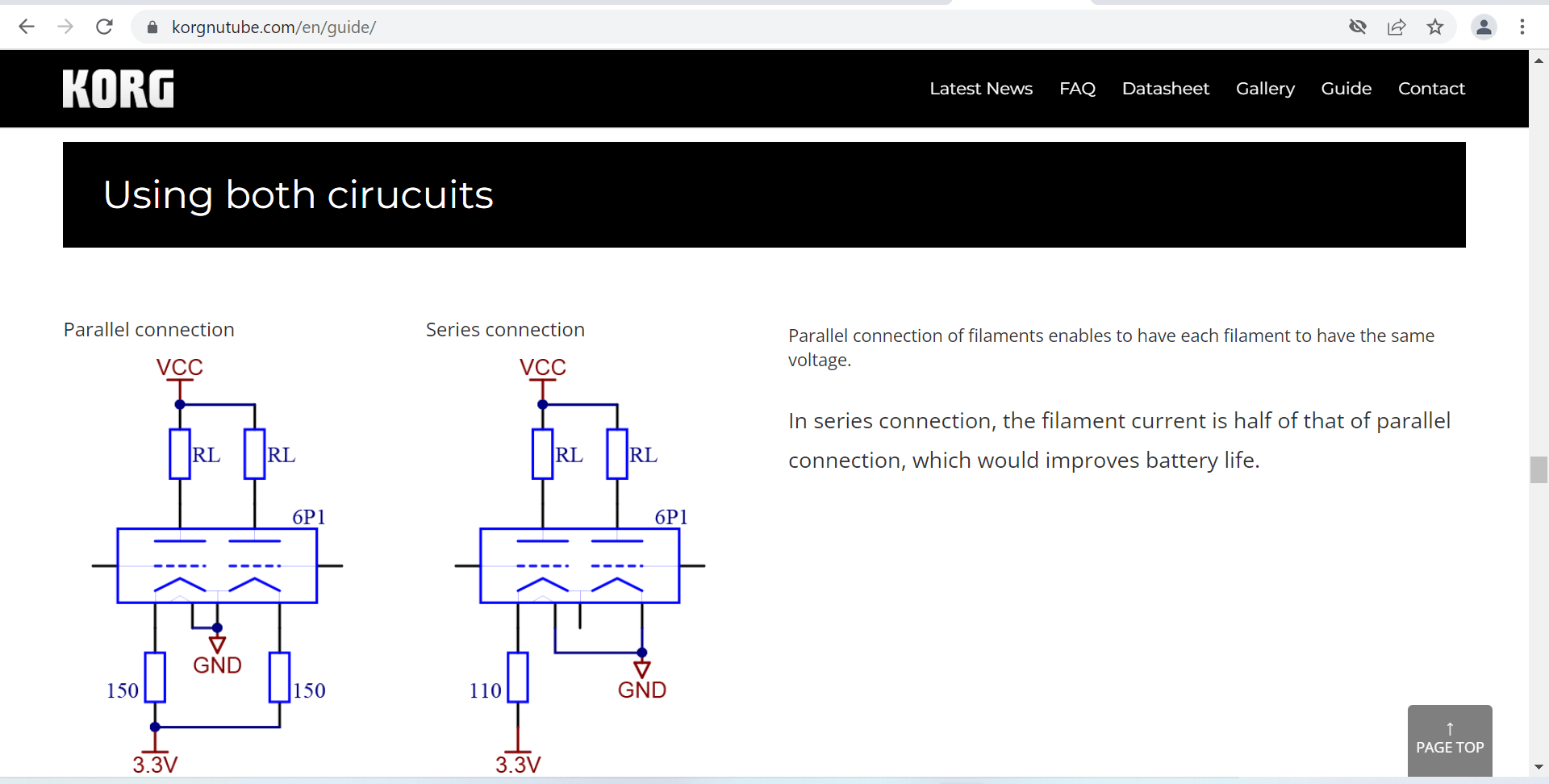

i don't know whether the NuTube filament has polarity, but regular tube filaments have no polarity, and can take AC or DC.
Looking at the spec sheet it looks like the NuTube filament does not have polarity:
https://korgnutube.com/en/guide/

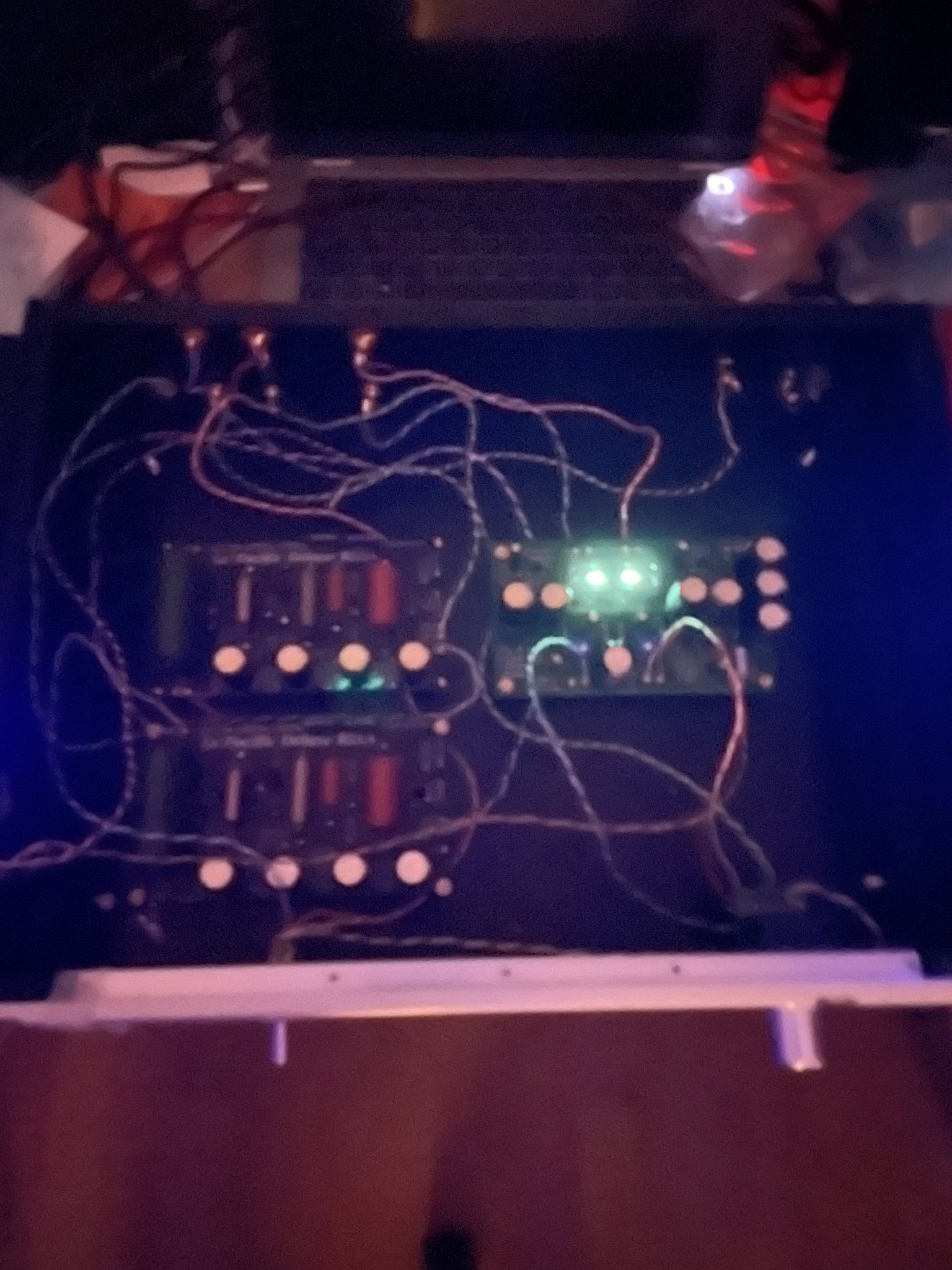

When you have polenta of dollars nice hardware swapping leads feel iffy but the test card volunteered and guess what, sometimes we only need to let go of pride and stubbornness."......barrel jacks......."
Sounds like wrong polarity.
It was magic, it runs with reversed polarity or as some refer to it “correct polarity”
thankfully for the soldering inspection, it is the sad side story that landed me in this, the real build was ready for trial run when I realised that my mirrored powers switch looked over engineered, flicked the switch and lit up the amp and fried the diod.
progressively did the re-soldering go from bad to worse, realised that the soldering iron was packing in, so correctly spotted some components have been hammered there with a cold iron. 🙂
so I cloud have save 2 days of hardship if I would have spotted the bad soldering iron and accepted that amps that glow do not need fixing, as the actual works.
So that is how you don’t build a amp.
That was only to reference the bulge, it is not mounted 🙂One of your caps is reversed, here is the pic you supplied, check out the center cap.
Akshually...So that is how you don’t build a amp.
I know I've made similar mistakes and will make them again. So maybe this really is how one builds an amp? 🙂
Glad you got it sorted!

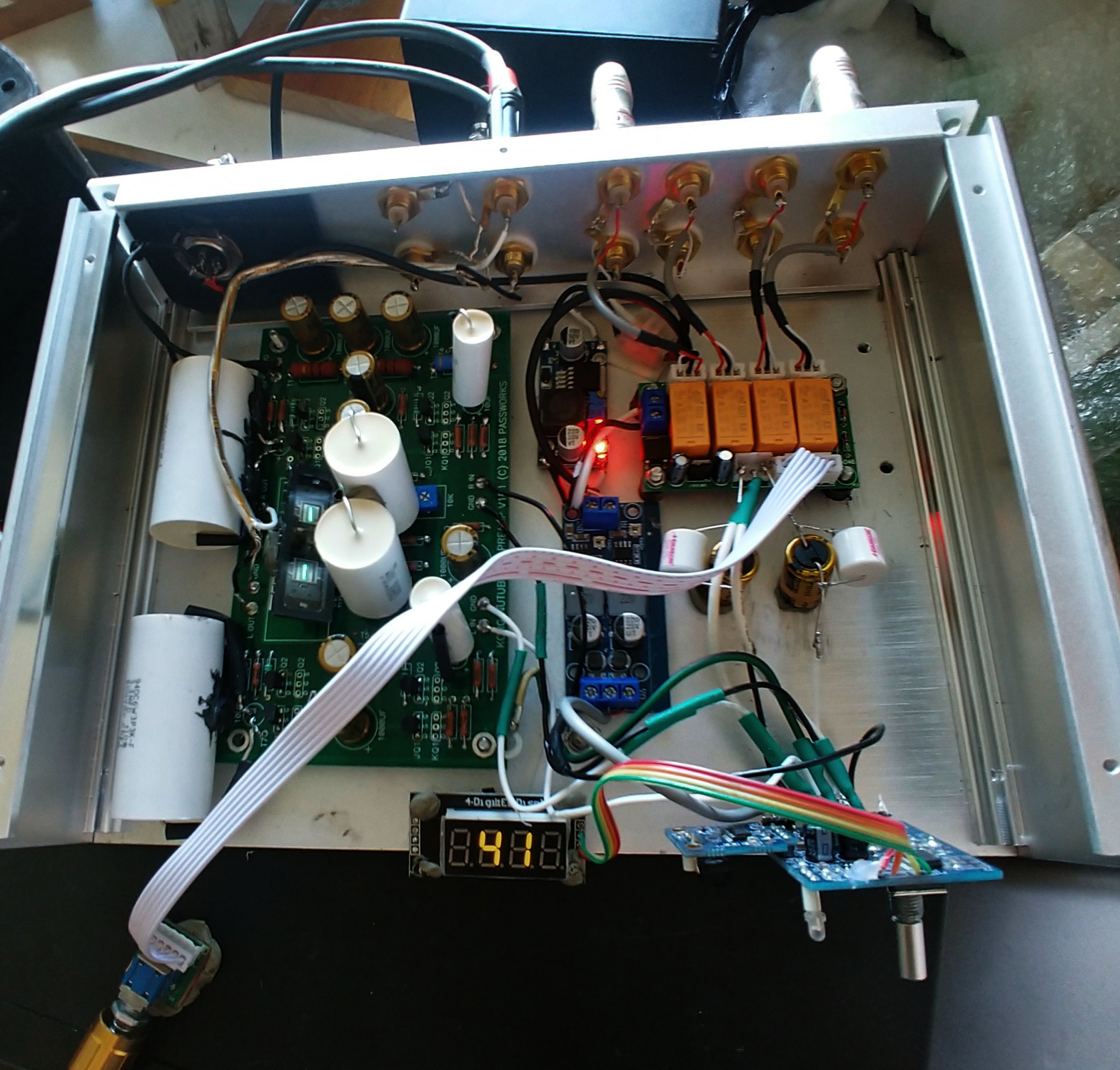

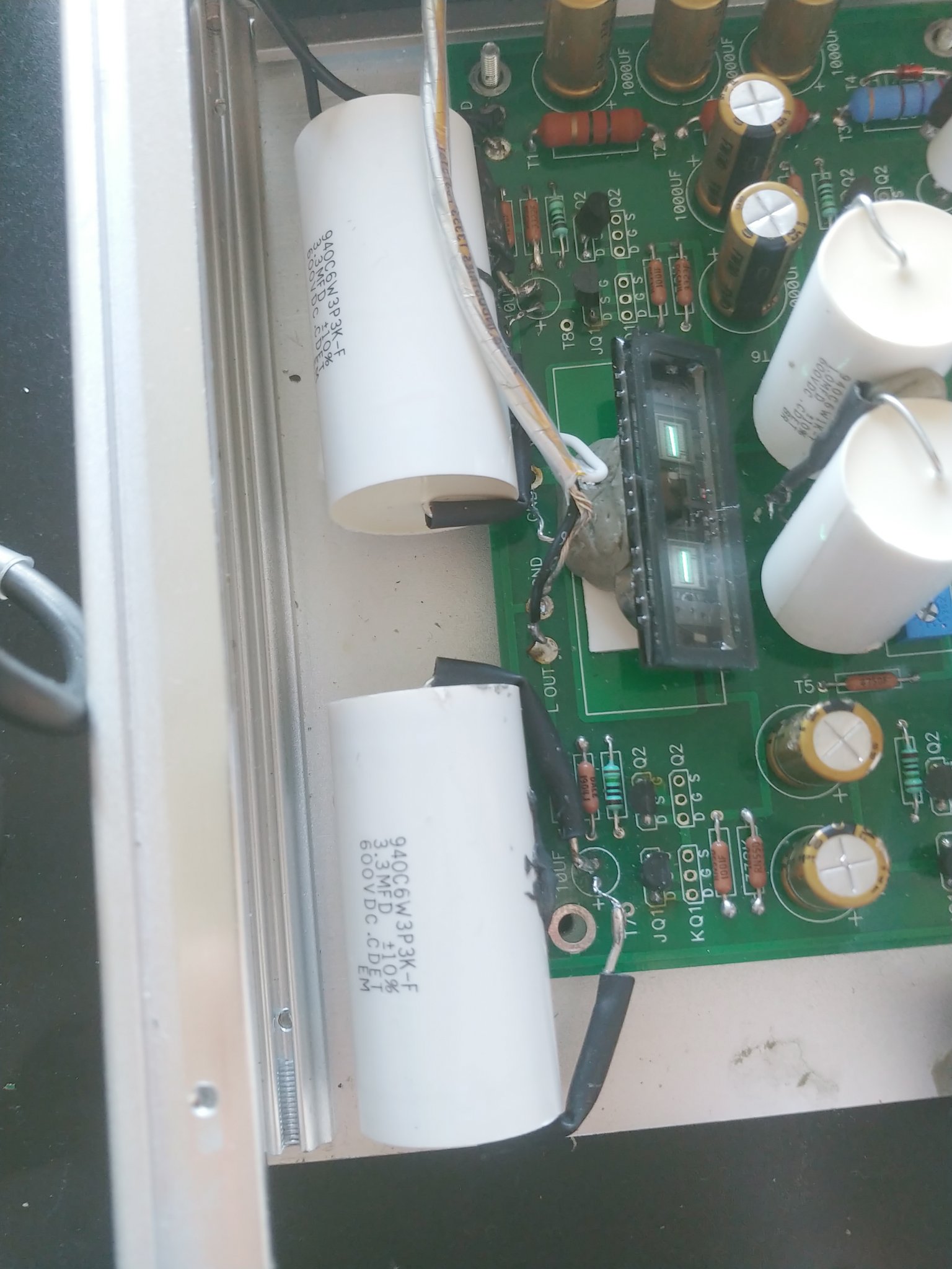

Hi guys, There was some chat the other week about how to fit the Cornell D caps as per Claud's suggestion onto the board, especially the large cap. Well just finished my soldering of my input selector, so I could complete the thing fully wired, so i though I would show befor I fully case it up.
Yes the large caps are a difficult fit & I had adhered them to the board with JB Weld (very strong but messy, messy adhesive. Under the caps are two foam pad to prevent vibration.
V/C is a Muses by Audio Academy, which has of course vol, but more importantly balance as well. Seems to work smoothly & does not upset the Korgs.
How does it sound well great on my 2nd workshop rig, but the test is when I get it into my main system & compare it so my 1st B1-K, which I have rigged up with a Khomo 64 click passive pre to control the vol. Will report more later
The 3rd photo is of my Studer 900 dual supply P/S, really great quiet supply I am surprised more people do not use, cheap as chips from F/bay.

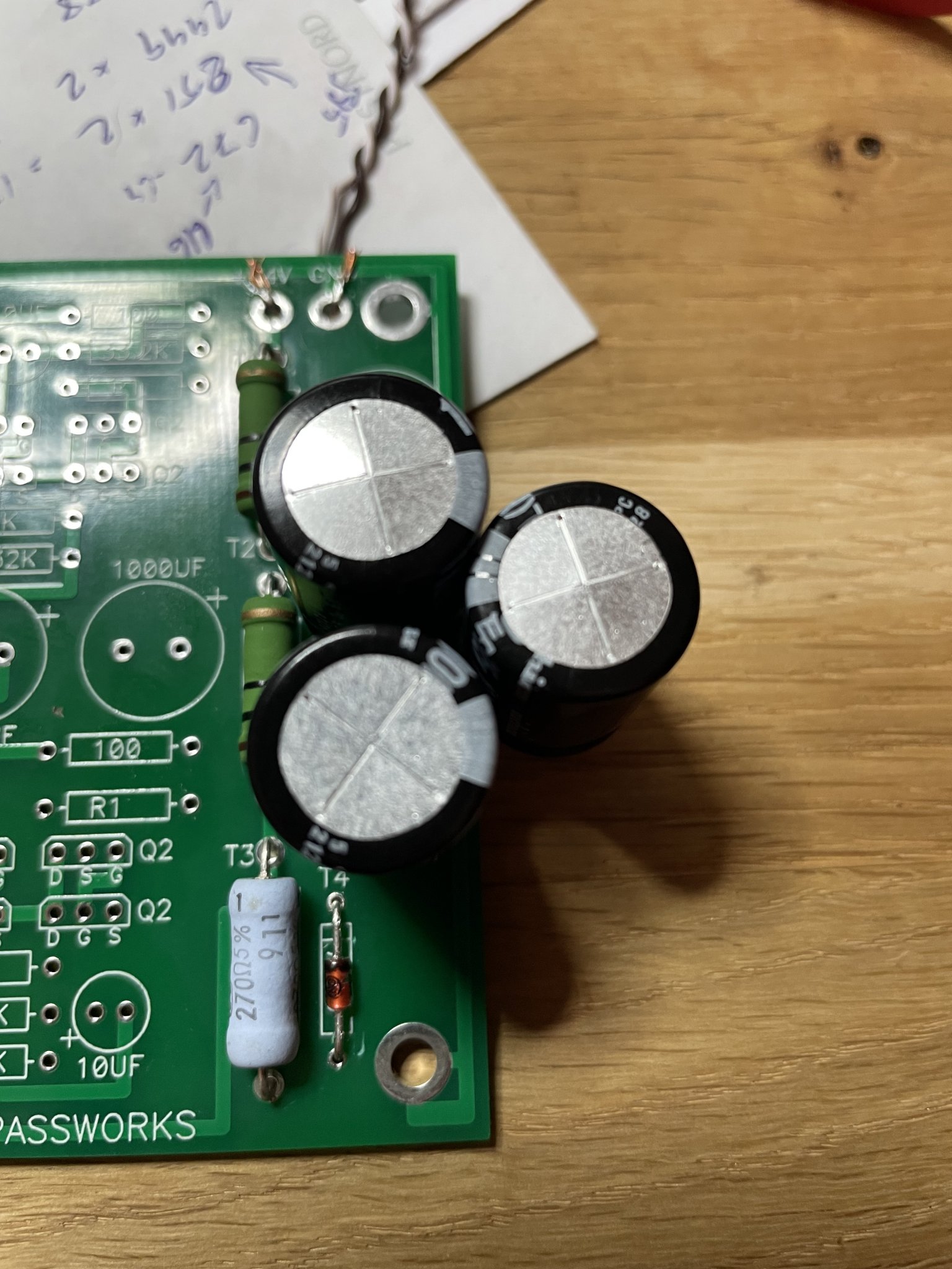

Got my kit today, a few questions...
1. In regards to the x8 1000uF 25V caps, have people been increasing the capacitance on these for more filtering? I don't see how this would hurt, especially if one can select a part with the same PCB form factor. Also 25V also seems rather low, more so on that first cap that sees 24V directly from the PSU...
2. I notice the supplied DC jack is not isolated from the chassis meaning the - (ground) connects right to the chassis. I now realize this serves as the chassis ground connection for the circuit. Has anyone tried using an isolated PSU jack and floating the circuit?

Yes, a lot of people have increased the size of the filter caps. Here is an example. Good luck!
https://www.diyaudio.com/community/threads/b1-with-korg-triode.313612/page-127#post-5826133
The marked locations seem to allow for a 14mm cap with 7mm lead spacing. I wouldn't worry about increasing the voltage of the caps. Just use good caps otherwise the size will get out of hand.
I am going to give these guys a shot on the three filter caps coming right off of the power supply.
UKT1E332MHD
https://www.mouser.com/ProductDetail/647-UKT1E332MHD

That post talks about upgrading 3 PI filter caps, isn't there 4? I see four looking at the PS rail in the schematic.
There are 4 but as posted back then given 3 made little difference I didn't bother about the last one downstream, eventhough Fc is indeed different... but for HF I have the SMPS filter anyway, so I addressed this in another way .
Mostly, that was ages ago and I wasn't sure (no one was really if I remember) at that time that the SMPS would start on a regular basis with the already massively increased C value!
There is more to gain elsewhere IMHO...
