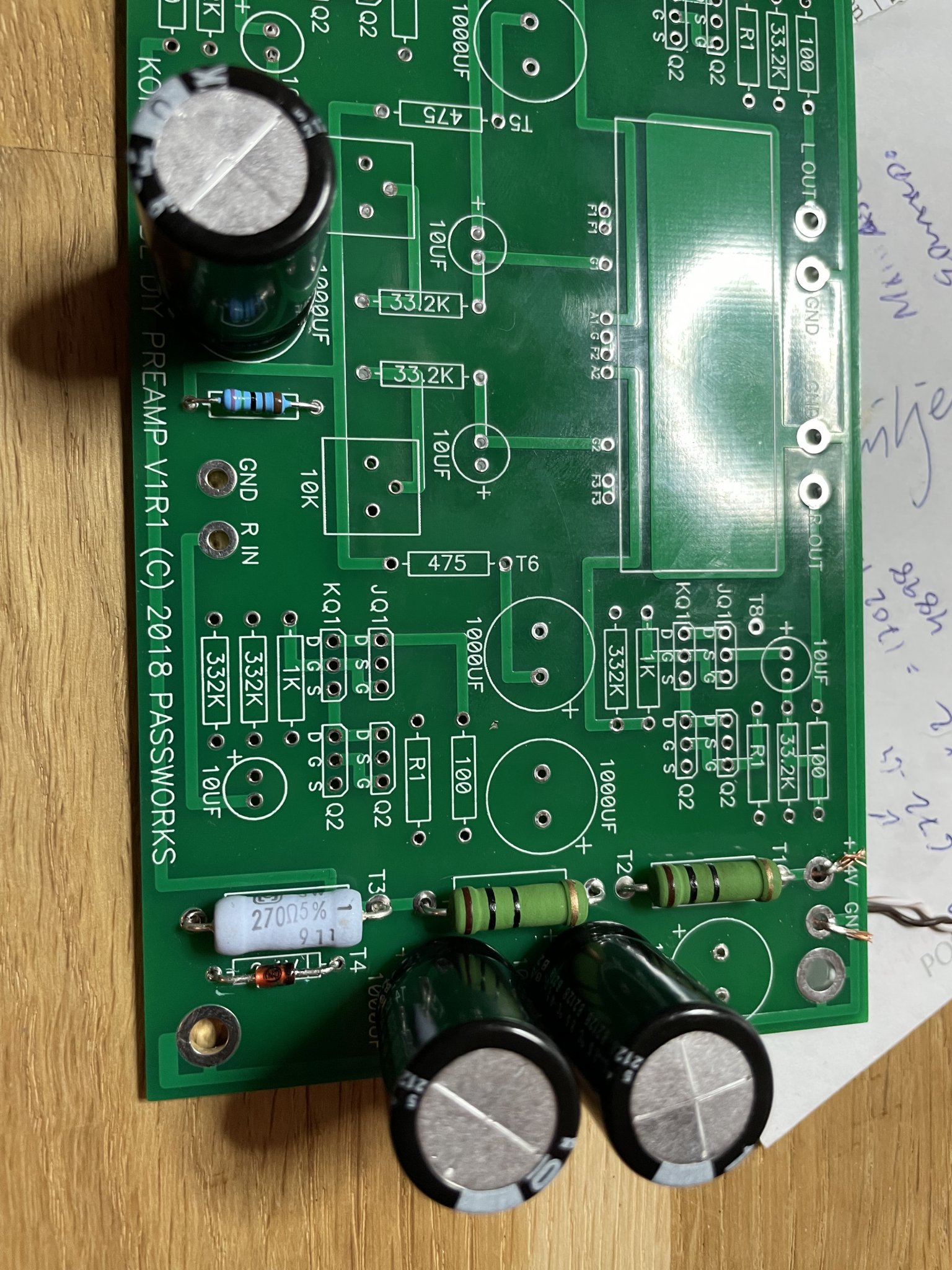

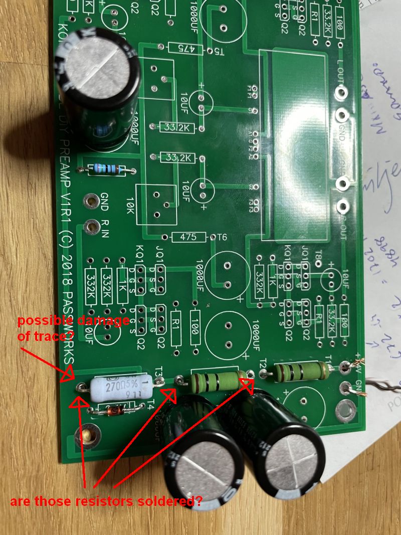

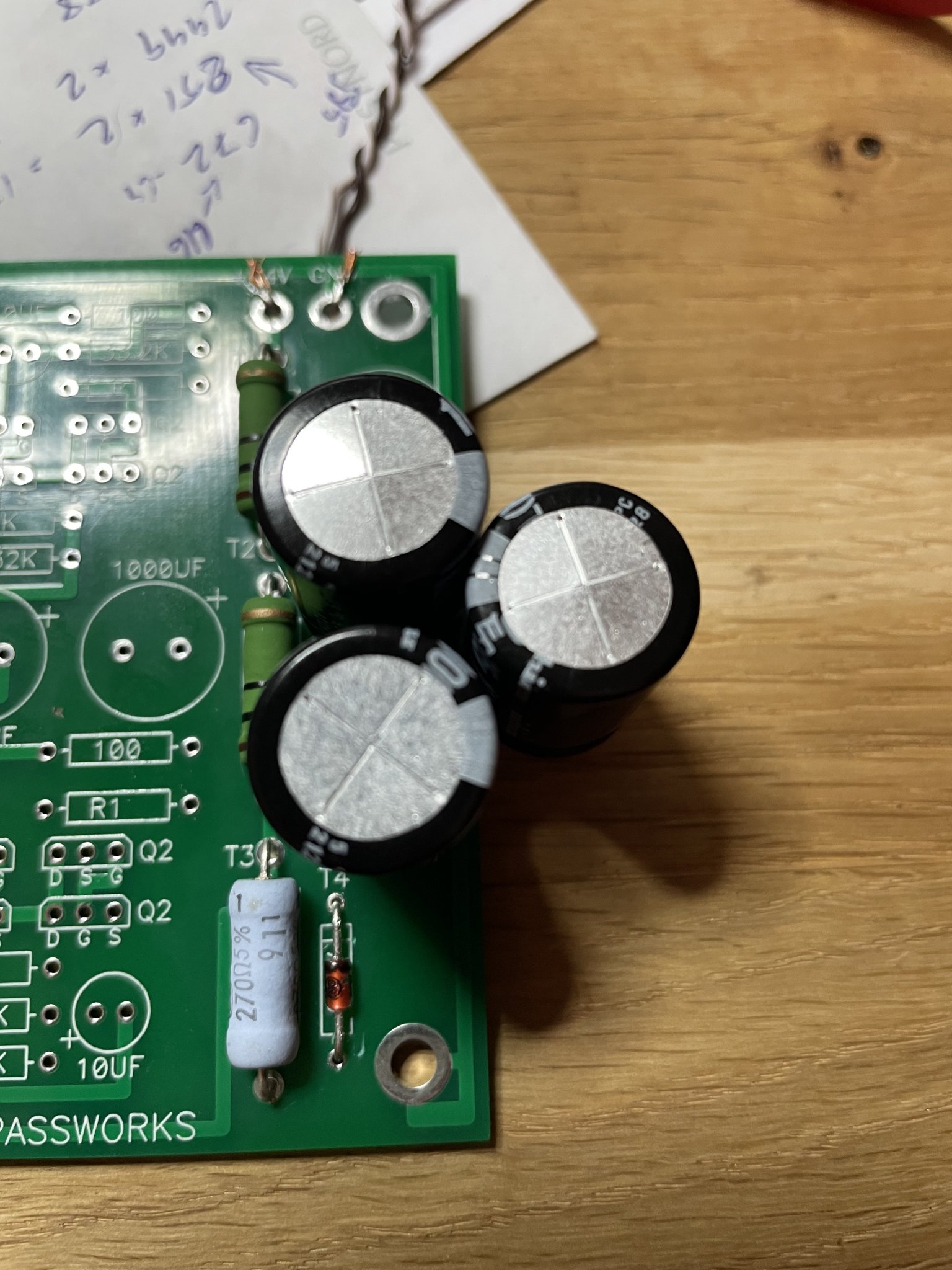

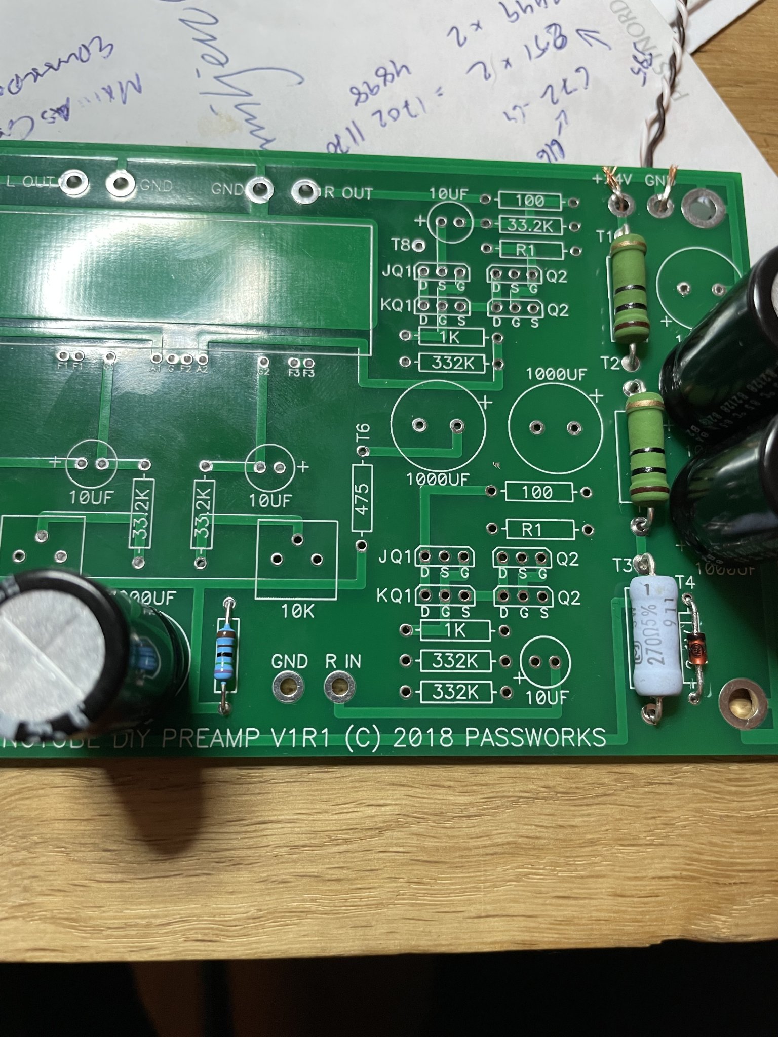

Major brain hemorrhage here, hit a snag with my build and thought I should be smarter a second time so to card nr2 and actually followed the instructions and built up the PSU filter part to conduct a test and see if this A-B approach would help with my fault tracing in the original build.
Read, followed and failed, read again twice, measured and failed, checked every component measured and failed,
Get 24v T1-T4, but the fist capacitior and the resistor take a huge hit, with all caps in place the voltage start to drop after 10 sek and become heat, if I skip cap 1 the voltage stays steady but the heat problem follows down stream.
It is so sever that it smells and the cap start to bulge, I only have 0.9 volt over the diod.
Please help me before i run out of mood stabilizers 🙂

I see you put them properly polarized on pcb, but - what about PSU polarity?
you didn't twisted wires ?
cap voltage?
cap voltage?
Caps. are 35V and 24V is the measured voltage and what the PSU give.
Polarity should be correct to the eye and the multimeter.
All cables are twisted by nature, but I can't very well have made two many misstakes with only 2 cables, but let me change and see when the protection circuit stops that attempt.
Don't know if I should send a massive thanks or a pic of me in my dunce cap 🙂
Note for the future, the guy that invited the barrel jacks should be struck from the Christmas list forever.
When instruments could be fools by a $1 peace of metal junk and steal 5 hours of my life.
Will update with the sad remains of the build and my shiny hat tomorrow, thanks for the lifeline.

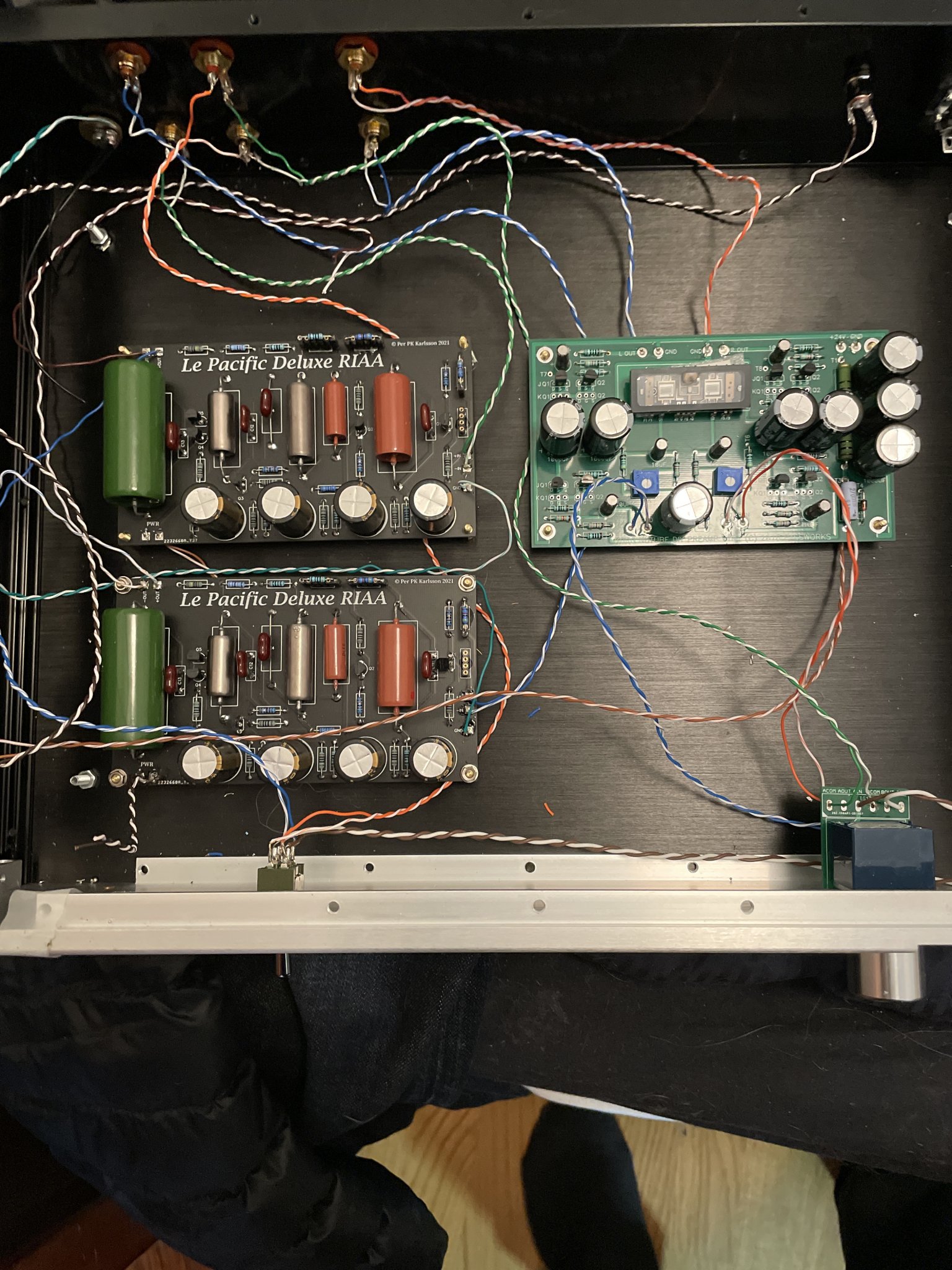

Here is the real build that acted up but actually had a nice glow, hence the second atempt."......barrel jacks......." Sounds like wrong polarity.
- B1 with Korg Triode
