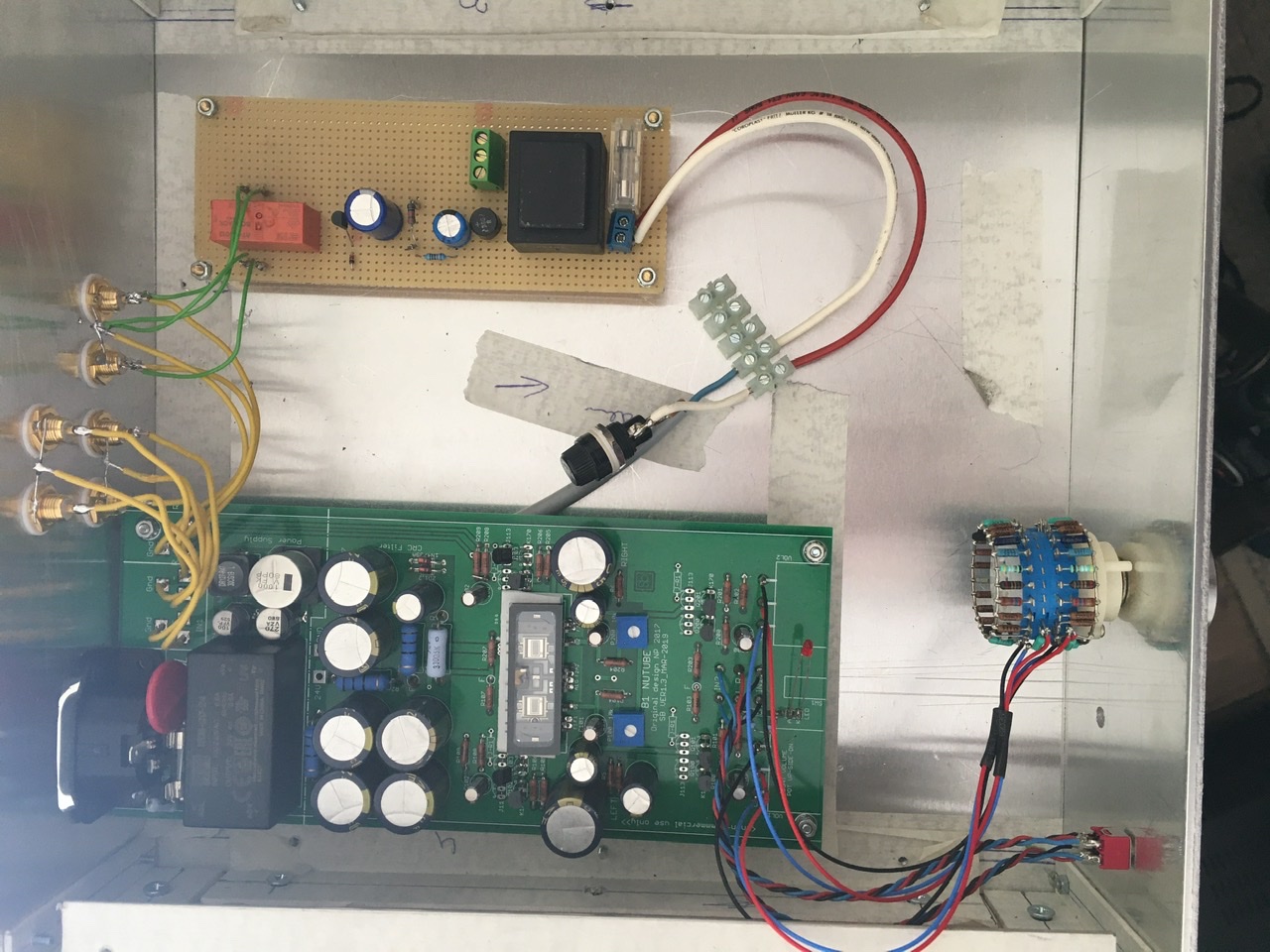

It's a hiss, and a very light hummm. It is there with the rest of my set up off (Brooklyn + dac and Auralic Aries G1 streamer). I also noticed I can't get the bias of the left channel below 10,5 VDC (pot is at the end of it's travel). I use a pcb from a groupbuy here on diyaudio. I will try to make a picture later.

Are you sure you have solid continuity? I had some of my return path wires come loose in the kit as they are quite stiff and slipped out a little of the euro block connectors I have. You also need to ensure solid continuity between the chassis panels.

Picture... this is a test chassis.

I don't know this board, perhaps best to ask the one who created it?
Hence no clue on the bias prob, regarding the noise yes check continuity, SMPS, and mass connections - possibly at wires connections (RCA, board, pot...) especialy if the noise varies when you touch with fingers casing or connectors...

Checked everything. It seems alright.
SMPS is mentioned most so I ordered a new, medical, one. Should arrive tomorrow.

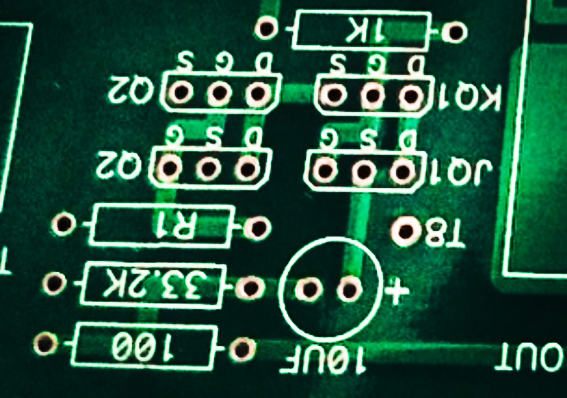

The PCB was a group buy here at DIYAudio. There is no need for a wire at the JR1 position when using Thosiba's.
Ok so without R1 Toshiba Q2 have source to gate loop and work correctly ?
