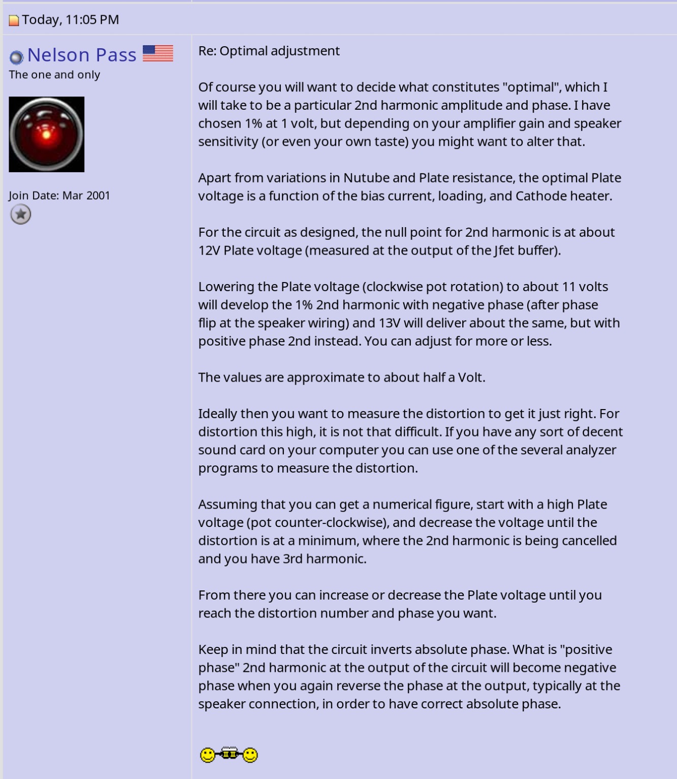

Re: Optimal adjustment
Of course you will want to decide what constitutes "optimal", which I
will take to be a particular 2nd harmonic amplitude and phase. I have
chosen 1% at 1 volt, but depending on your amplifier gain and speaker
sensitivity (or even your own taste) you might want to alter that.
Apart from variations in Nutube and Plate resistance, the optimal Plate
voltage is a function of the bias current, loading, and Cathode heater.
For the circuit as designed, the null point for 2nd harmonic is at about
12V Plate voltage (measured at the output of the Jfet buffer).
Lowering the Plate voltage (clockwise pot rotation) to about 11 volts
will develop the 1% 2nd harmonic with negative phase (after phase
flip at the speaker wiring) and 13V will deliver about the same, but with
positive phase 2nd instead. You can adjust for more or less.
The values are approximate to about half a Volt.
Ideally then you want to measure the distortion to get it just right. For
distortion this high, it is not that difficult. If you have any sort of decent
sound card on your computer you can use one of the several analyzer
programs to measure the distortion.
Assuming that you can get a numerical figure, start with a high Plate
voltage (pot counter-clockwise), and decrease the voltage until the
distortion is at a minimum, where the 2nd harmonic is being cancelled
and you have 3rd harmonic.
From there you can increase or decrease the Plate voltage until you
reach the distortion number and phase you want.
Keep in mind that the circuit inverts absolute phase. What is "positive
phase" 2nd harmonic at the output of the circuit will become negative
phase when you again reverse the phase at the output, typically at the
speaker connection, in order to have correct absolute phase.
:cheers:

Thanks very much Mr Pass for all instructive explanations now it's
been more precise and easy to play with B1 Triode shape of sound and his phase's.
I do screen capture save of this highly useful post 😉
Kindest regards
