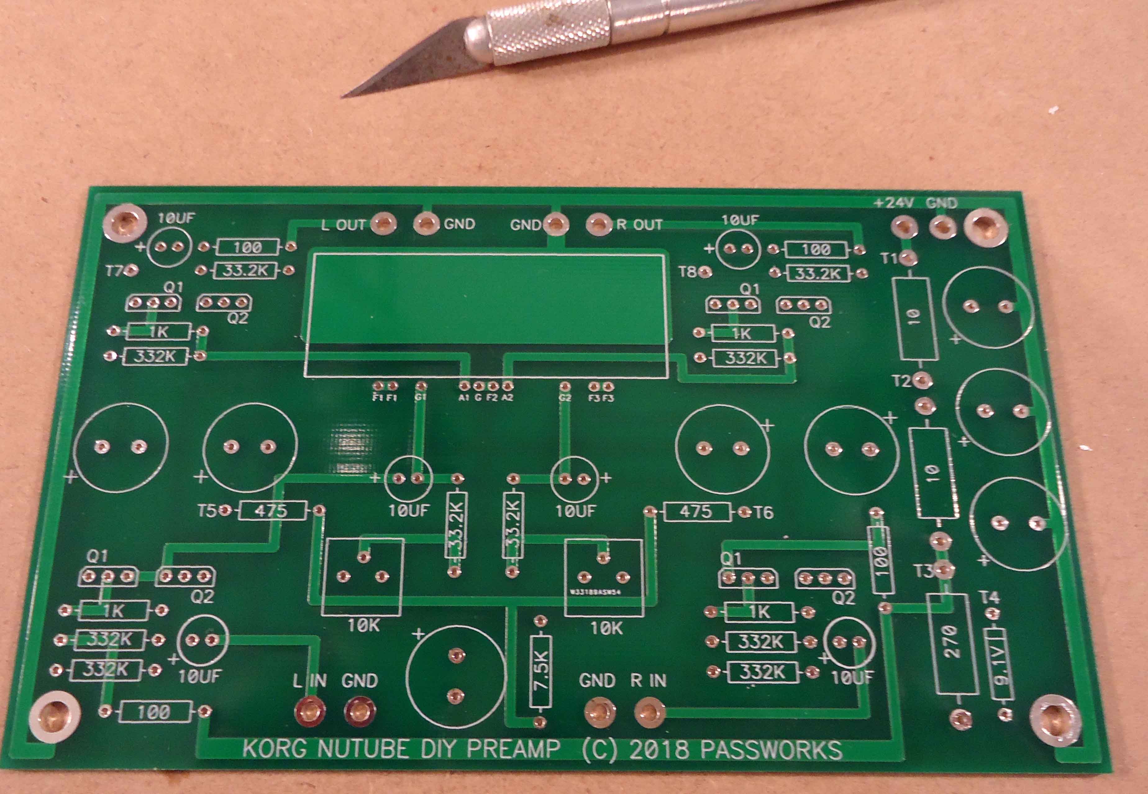

I am making 24V power supplies in the moment to be used for both BA3-pre and Korg. I assume that it is ok to use an external 24 VDC regulated PSU even that some additional filtering is on the PCB. It will just be extra filtering and can only make things better.

I'm also working on a BOM also. I am wondering about the JFETs. The Pass B1 board had an option of purchase with matched JFETs. I wonder if the Korg B1 board will also have this option. What do you think? Also are the Bourns 10K trimmers which I assume from the silk-screened board single turn or multi turn?
I am examining two options for the Jfets, one with 2SK370 followers
(same as 2SK170 w/ package difference) and the other with the Fairchild
J113's. Both require selected parts, and the Toshiba parts are a lot more
expensive.
Single turn pots.
