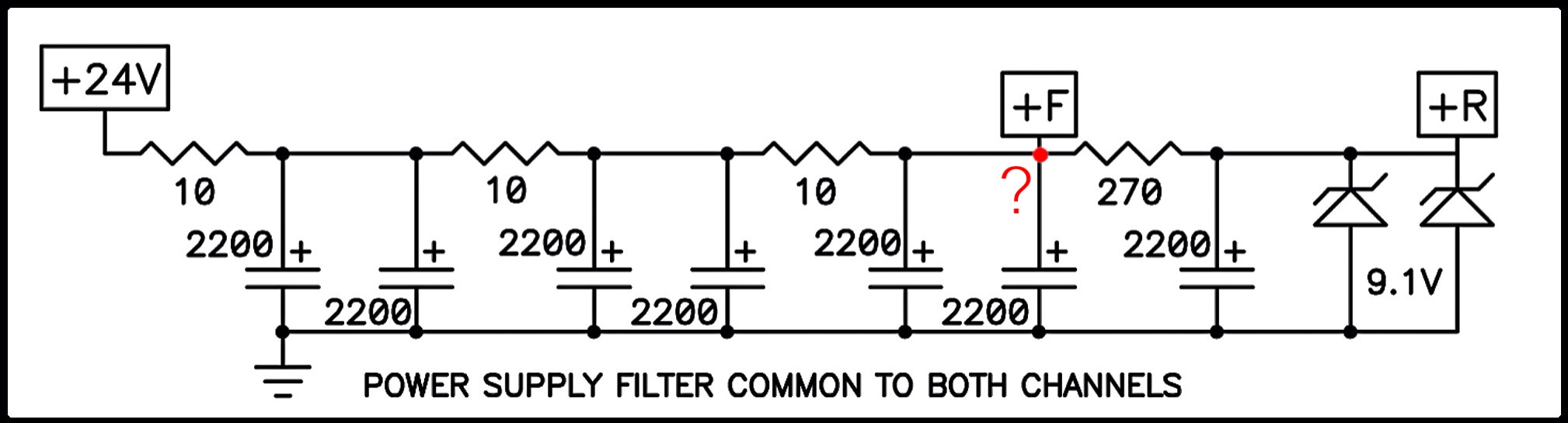

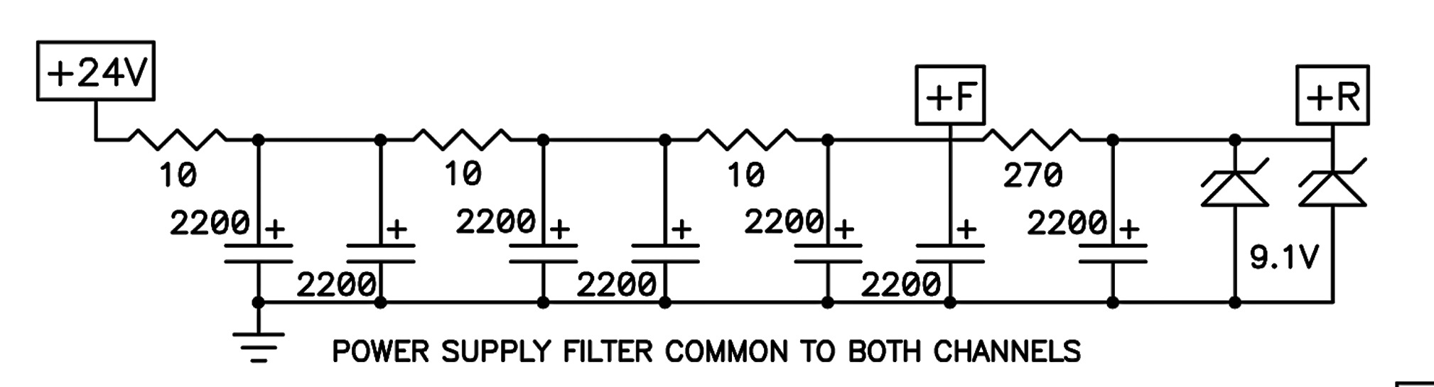

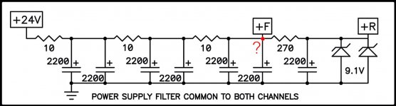

Let's build B1 Triode quick prototype before use of superb Papa boards.
Bigins with PSU filtering now and have one question :
do +F is connected to 270R or not ?
No dot connection point on the first schematic version
SMPS 24VDC + filtering : +R = 9.2V and +F = 22.5V
it's without anything else connected. All OK ? 🙂
