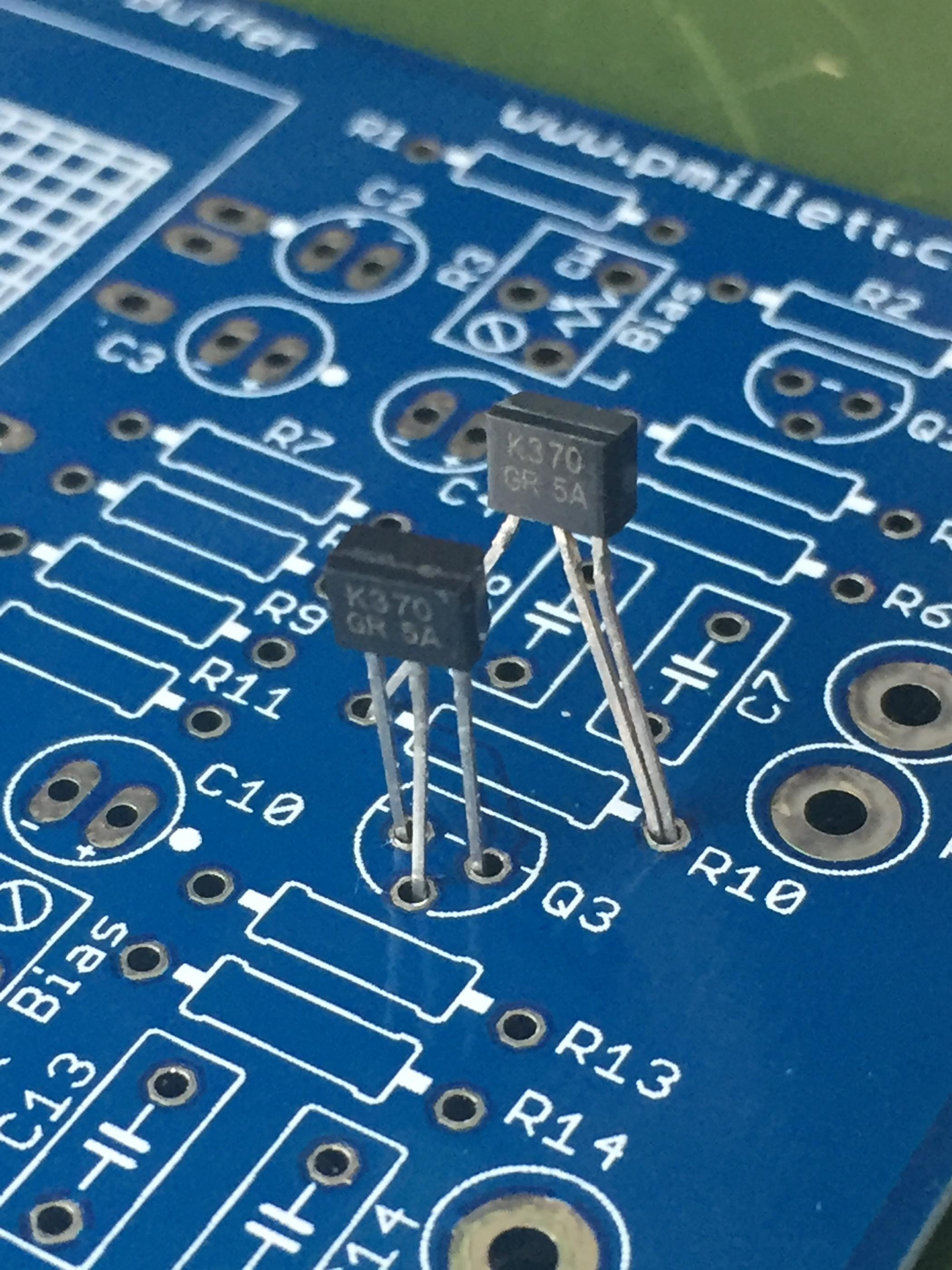

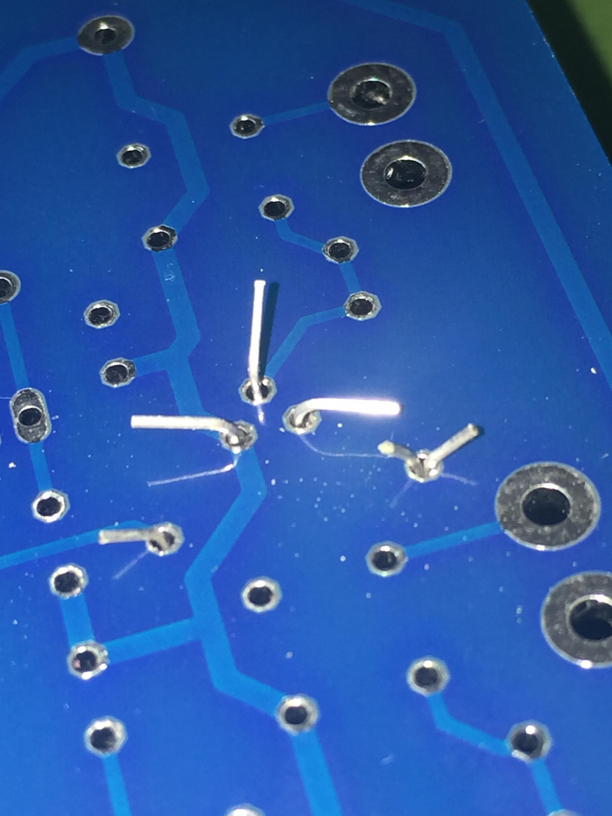

Pass B1 Korg pre with Pete Millet PCB
As you may already know, it is possible to apply Nelson circuit to that PCB.
2SK370 legs are thin enough to go into the holes of the follower resistor.
I did it and it worked fine. :)
Other parts are ... almost the same or you can change easily, except for the heater circuit which I think is not the day and night difference.
