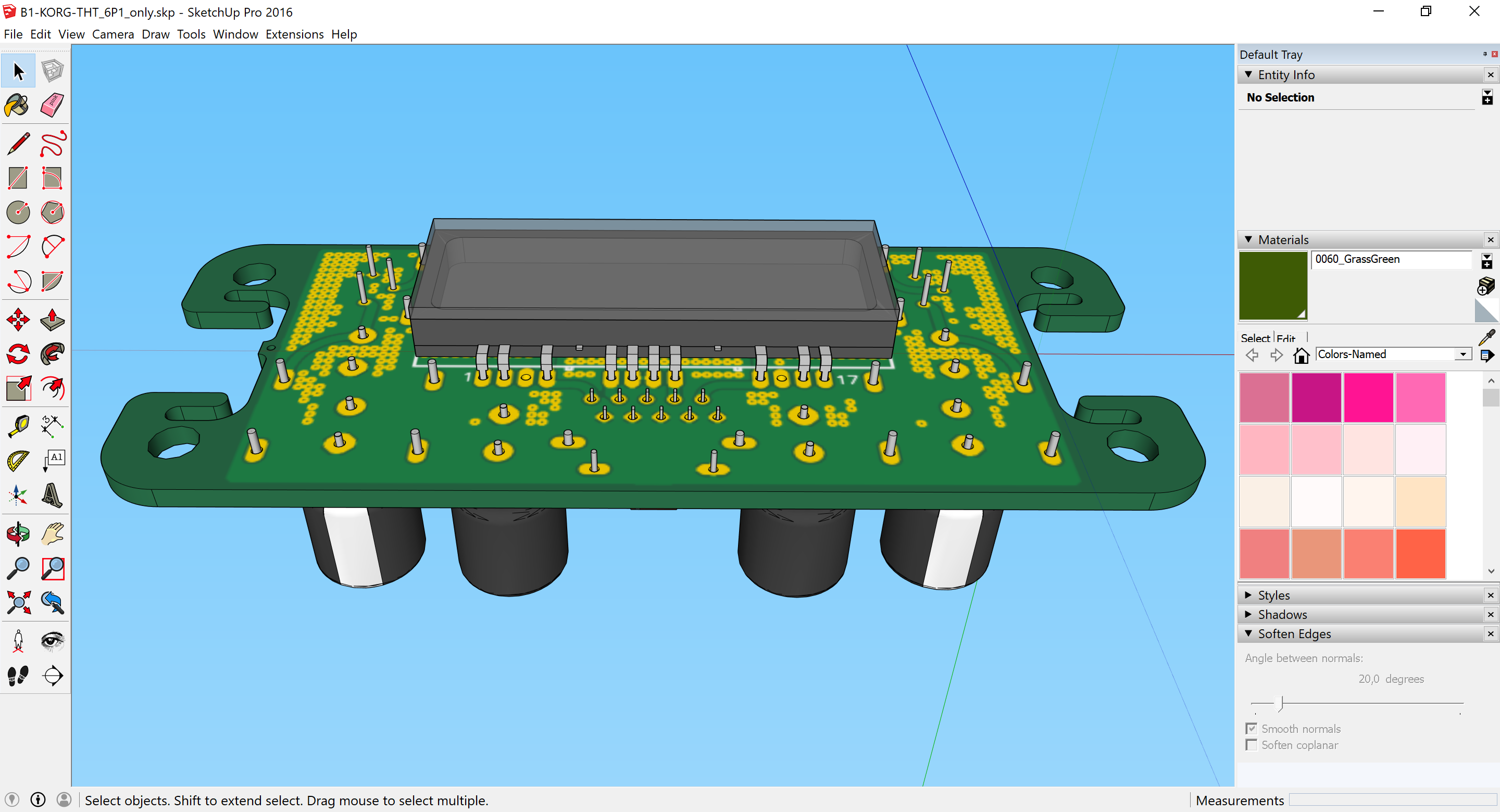

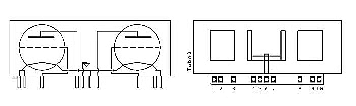

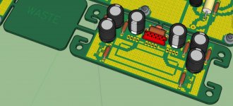

Got that, thanks! I meant that if the MicroMatch were to be mounted on the back of the PCB it would allow for the Nutube to be the only thing showing on the front of the PCB. If you solder all other components from the back, of course.
Would the LSK389's need to be matched in any way?

Usually you match to avoid 2nd harmonic. The Nutube is 2nd harmonic
generator deluxe - might not be very necessary.

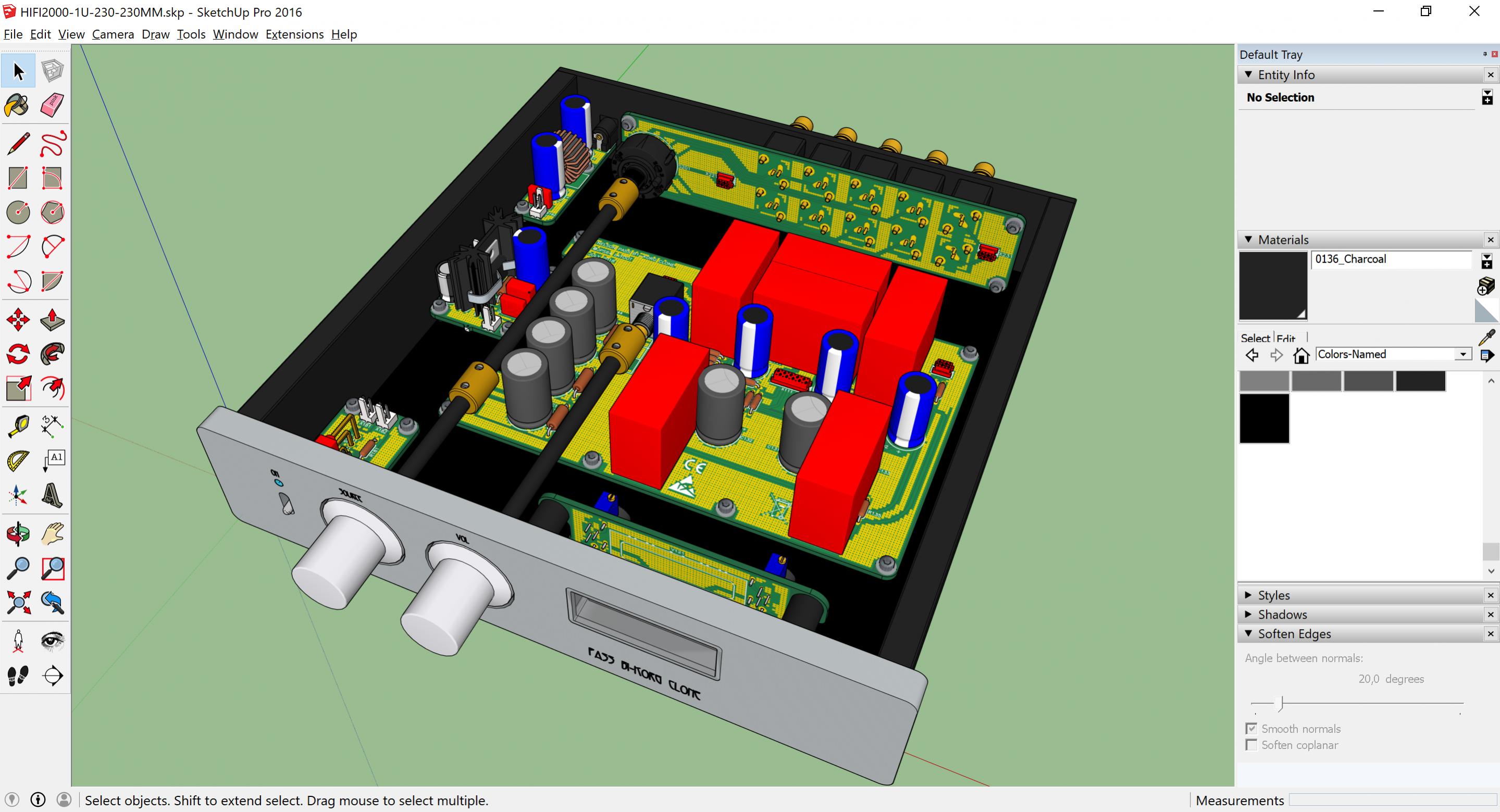

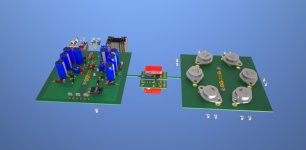

Here the part list.

Why not made some good working verified prototypes first and show Your checked design after that ?
I remember in the past You don't do this and Diyer who use your schematic get fire and damaged components.

I´ve supplied some M2, ACA, F6 PCB´s without any problems neither damaged components after building.
My MoFo PCB is under test (waiting for mechanical parts).
I´ve supplied successfully the PCB fabrication datas for the DIY´ers the AKSA/LENDER Preamplifier, the AKSA ALPHA20, AKSA BB 50W and others.
A lot of DIY´ers ask me to give them the B1-KORG SMD design: ask me if I could supply PCB´s. I´ve answered that they´ve to wait for Mr. Pass B1-KORG availability.

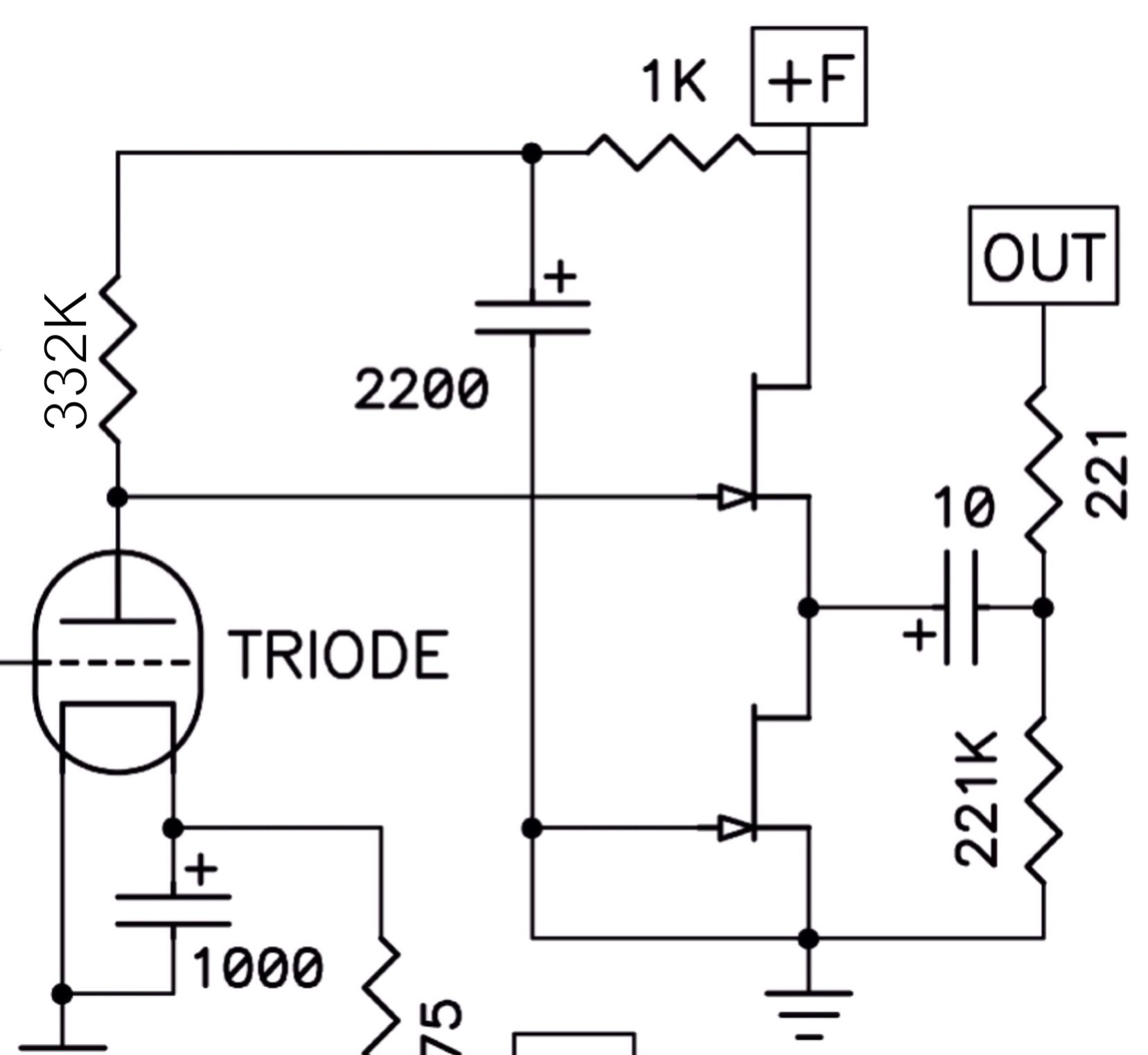

I´ve published schematics so that experienced and interested builders could check it. ZM ask me to put gate stopper on each JFET. Today no more feedback about schematics although it was viewing 21 times. I need this feeback before ordering PCB´s to reduce the layouting errors to minima, but your right, nobody is perfect and errors occurs.
One piece of this PCB (panel) costs over 200 EUR and everybody would try to reduce one shot costs. But I don´t remember that I´ve ask to start a GB. I´ll do it at my cost then I want to know how its sounds.
I know that a lot of DIY´ers waiting for Mr. Pass B1-KORG Preamplifier in the DIYAUDIO store.
My plan was ordering, testing and verifying the B1-KORG Preamplifier Clone before giving the fabrication datas to the community.

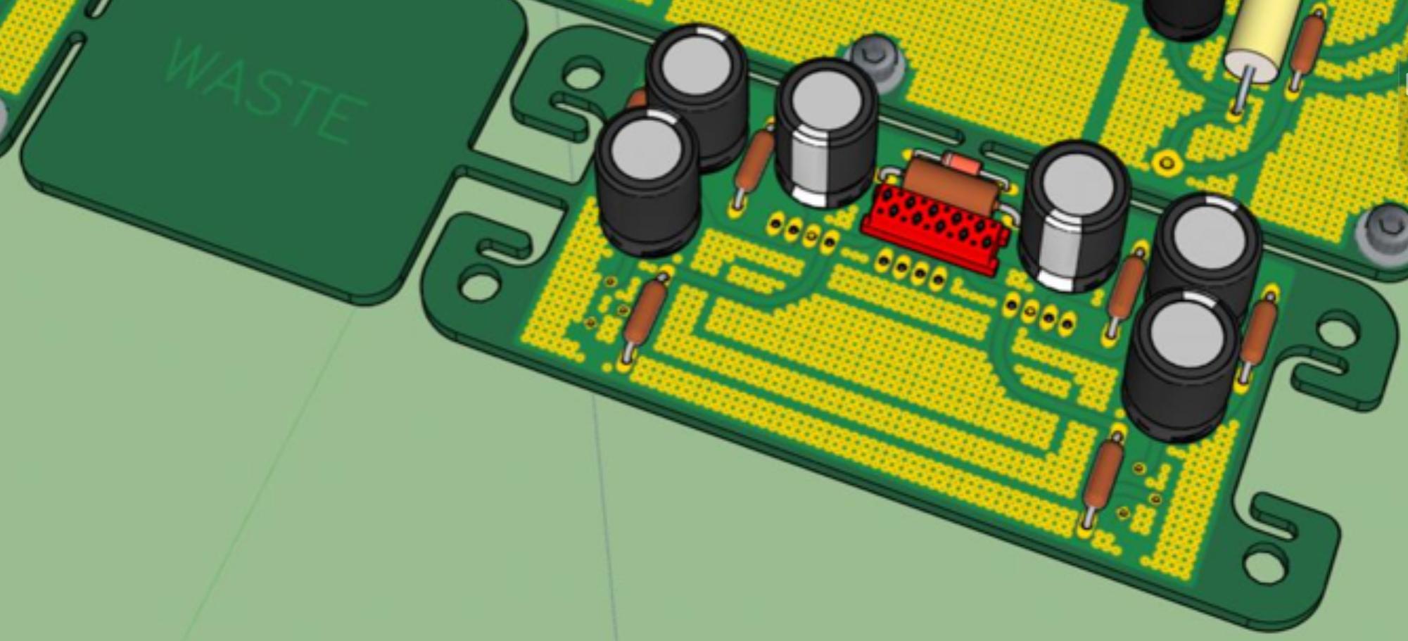

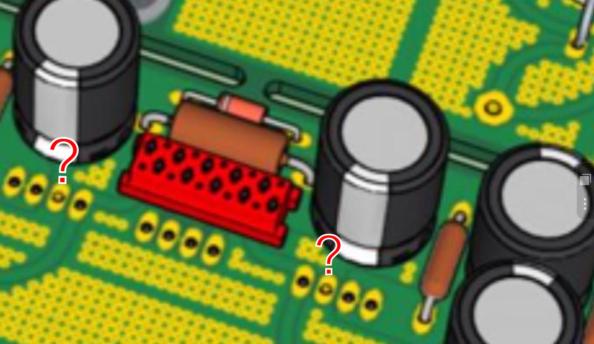

Four pins socket's so why 3 thru holes are drilled not 4 on the left and right PCB side?
