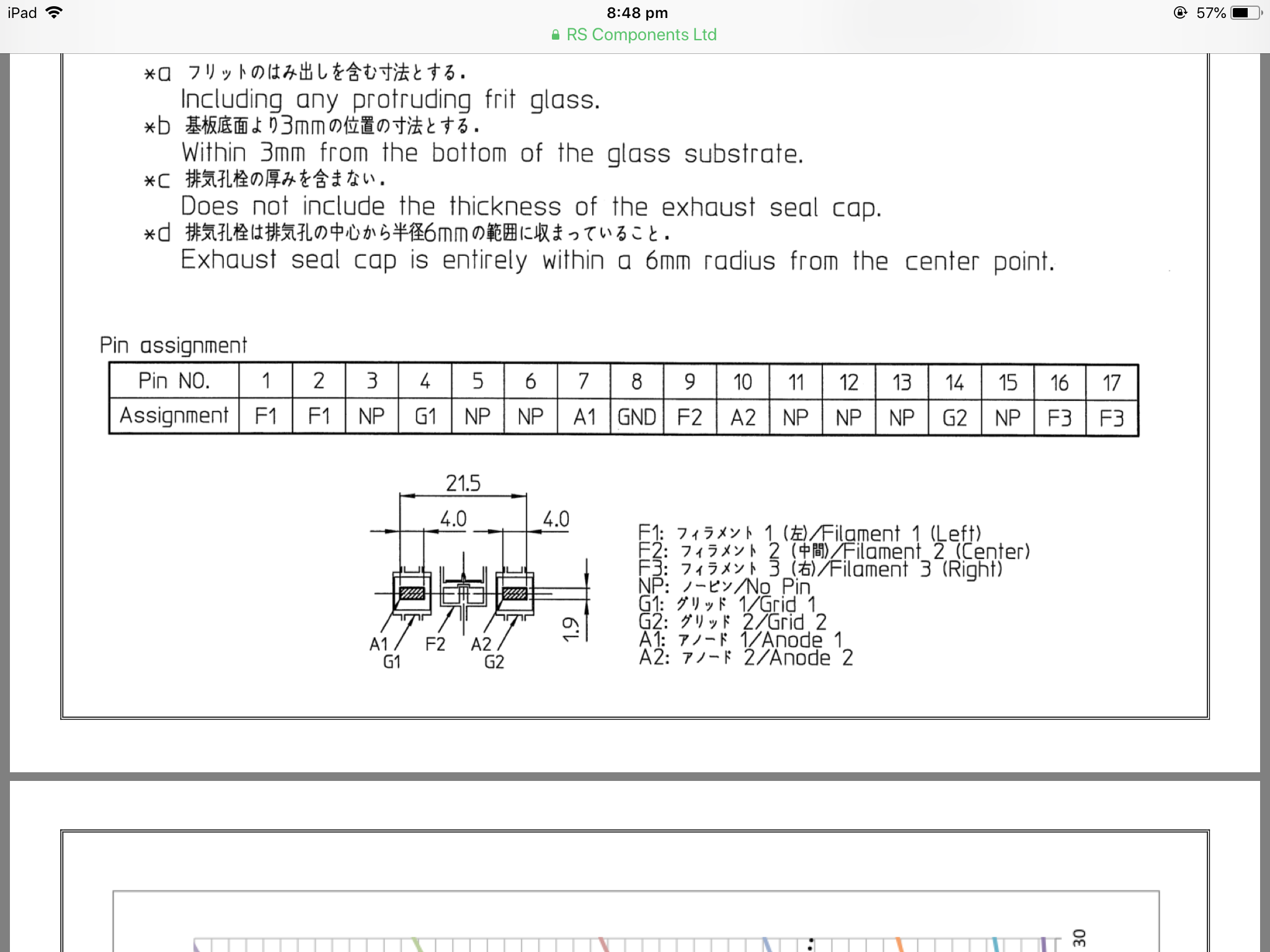

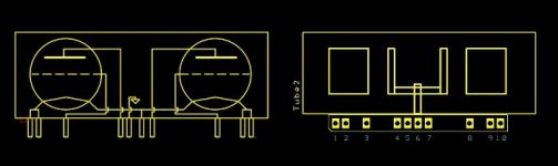

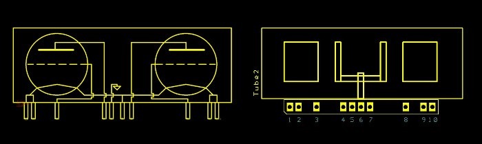

6P1 question:
Dear all,
According to the spec, 6P1 has a common cathode formed by 2 filaments and connected As F1 - F2 (common) - F3
It means that the Korg can’t be used as separate triodes.
If you do have a specimen, please have a look, is there any bridging in between ?
Pin 1-2
Pin 16-17
Such as small metal tab between those pins.
If it does, may be if those links been cut, we may have two separate triodes.
Pascal

Here is the pin diagram, reference triode #1 and #2
1 filament 1
2 filament 1
4 grid 1
7 anode 1
8 ground (not attached to triode circuits)
9 filament center - common to both triodes
10 anode 2
14 grid 2
16 filament 2
17 filament 2
The one pin in common to both triodes attaches to both filaments.
The rest of the pins are named after me.

Thank you Mr Pass,
Definitely must have two 6P1 for an SRPP circuit.
All neutered by Korg, poor Nelson

I see better now.
Direct heated triode filament 1&2 = cathode 1&2

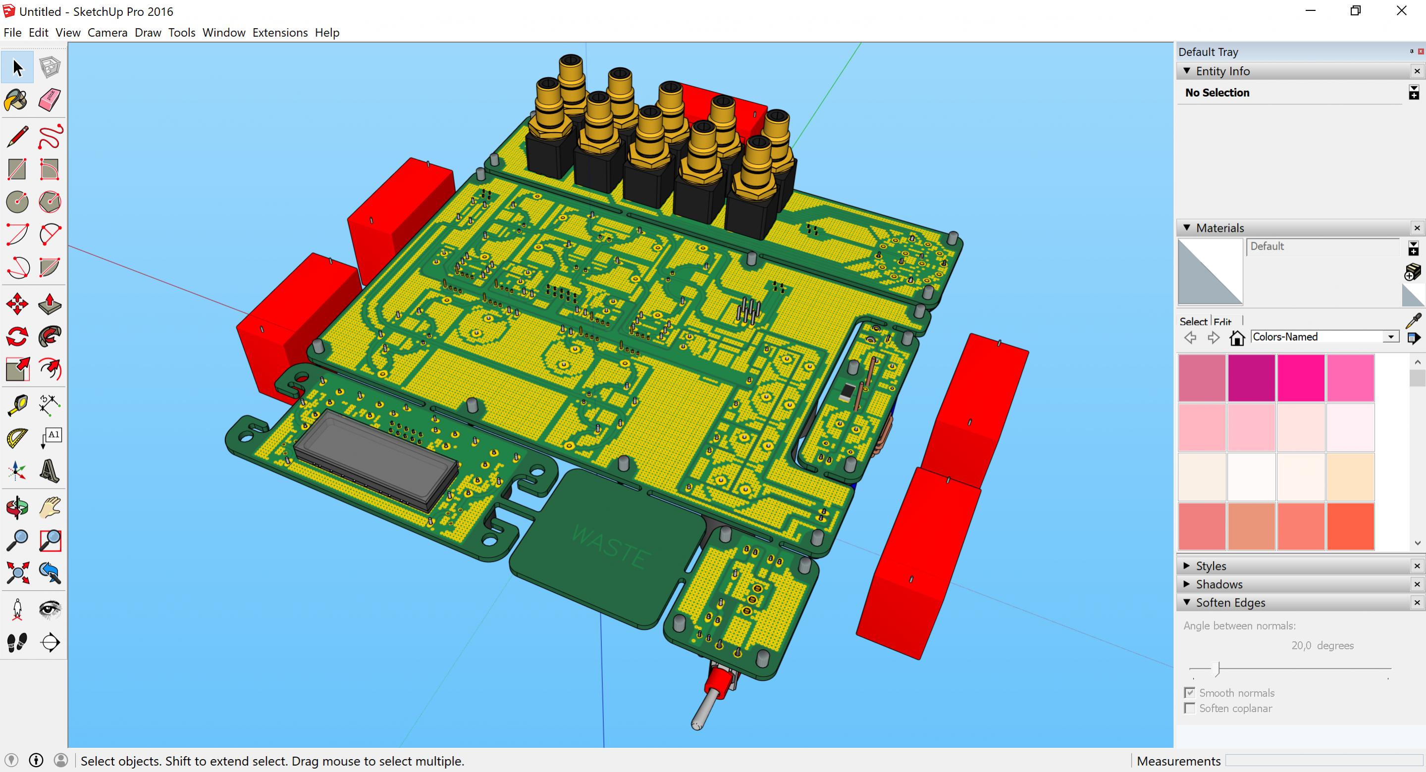

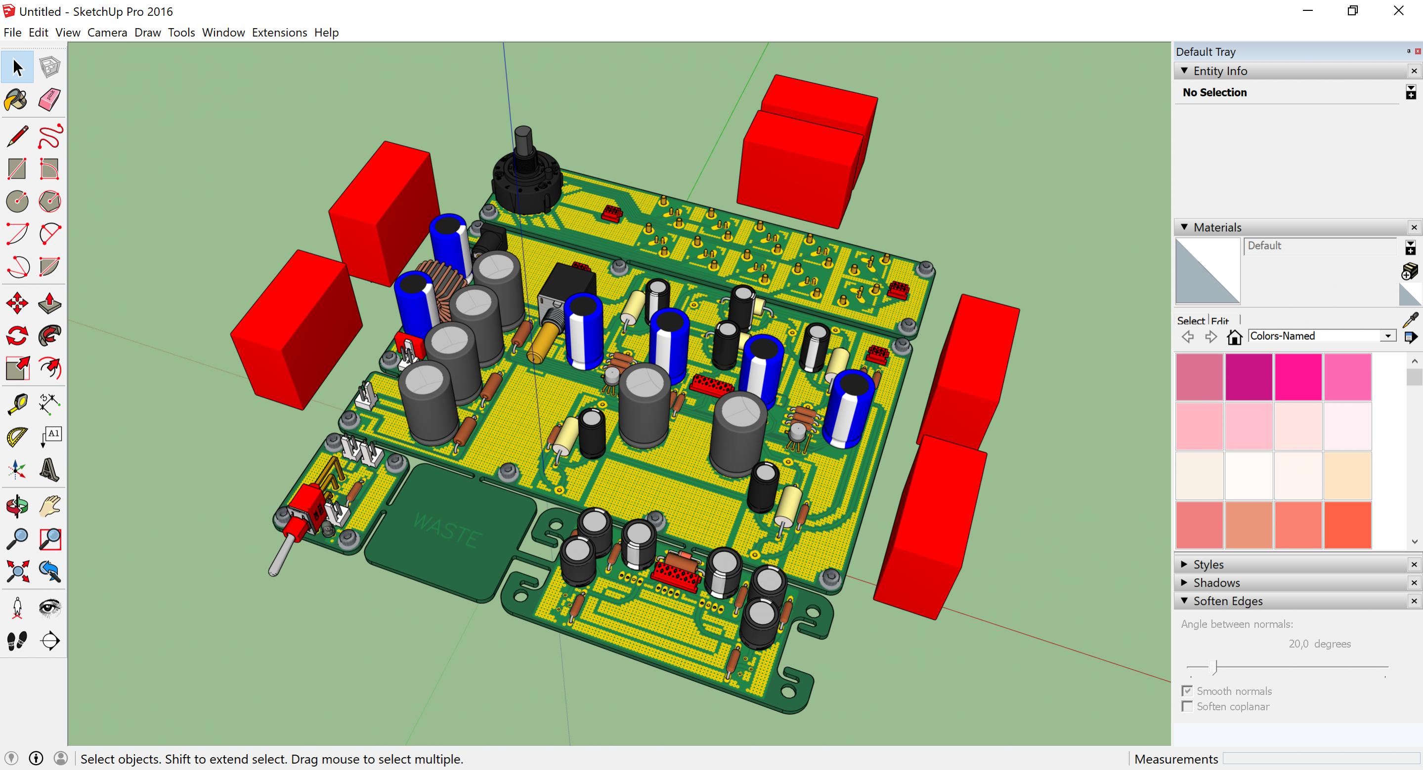

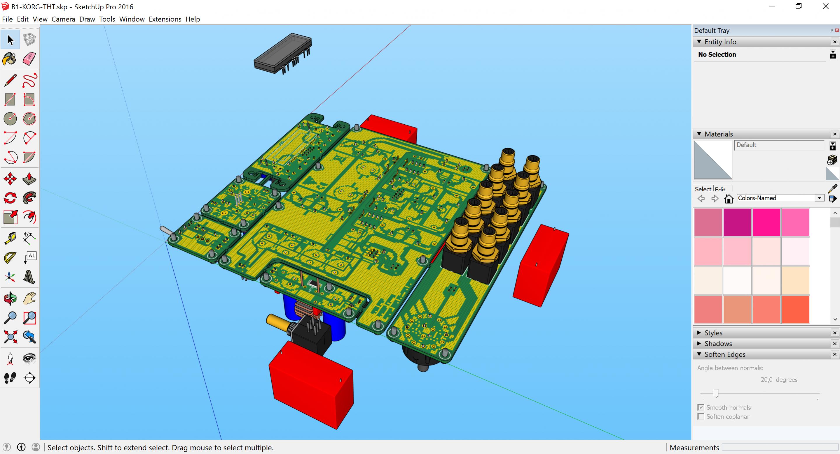

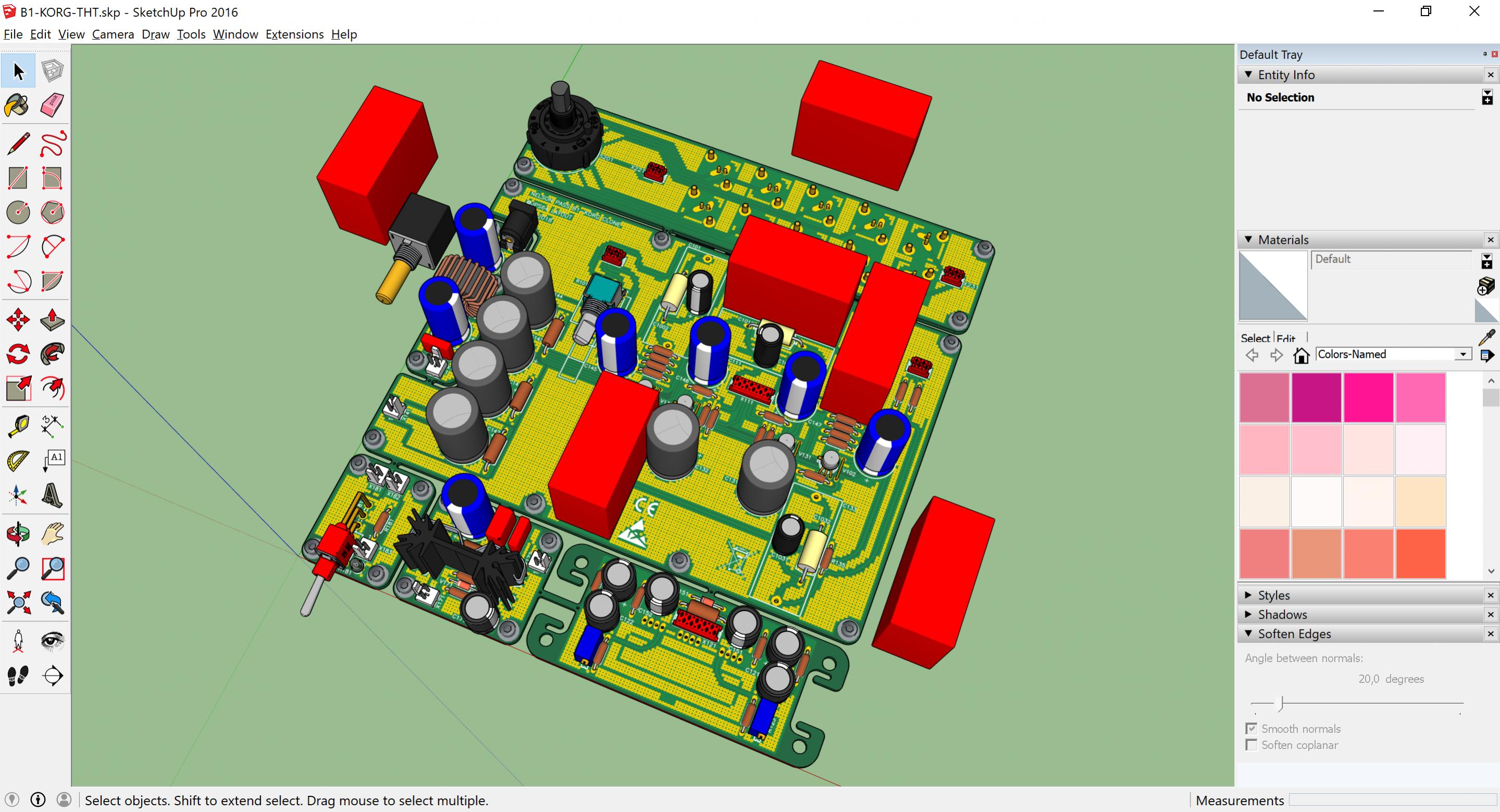

Modifications done.
TKD 2CP601 or ALPS RK09 potentiometer.
Added capacitor multiplier.
I´m working on the part list.
JP
JP
It might be too late, but since you mounted the Nutube in a daughter board, you could have the flatcable connector on the bottom of the board so one could mount the board showing the tube in a window on the case.
- B1 with Korg Triode
