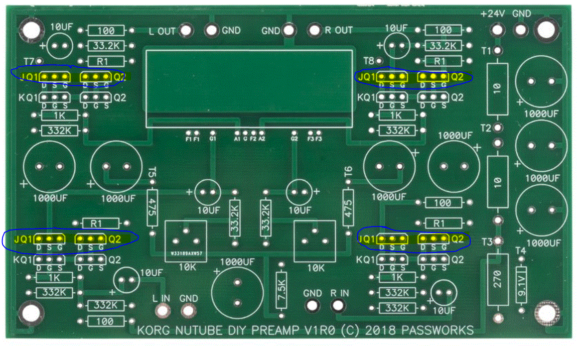

Yes, you need to find out if you put the Fets in the right holes...…..
I took the fets out. I am not sure if they are good... but the holes are ok!
Ok.....but I think Nelson wanted to know which set of holes you used for the JFETs?
One set is for Fairchild and other Toshiba. The PIN configuration is not the same.
Yes Nelson, I understand. I'm sorry, I am not helping you helping me...
I cleaned the board before that post. To much in a hurry.

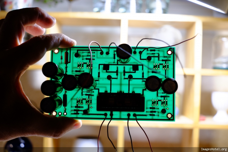

Ok. I have the board in front of me. Nutubes are up, (in the head). Trimmers are down, (in the feet). I can read the inscriptions on the board.
There are 4 groups for fets. I used those the holes that are "UP".
For example, in the group at the left side of the Nutubes I used the holes that are closer to the 10μf cap. Hope this is clear.
In the groups near the trimmers I used the holes that are closer to the 1000μf caps.

That's clear. You used the right holes. 🙂
I guess we proceed with replacing Fets.

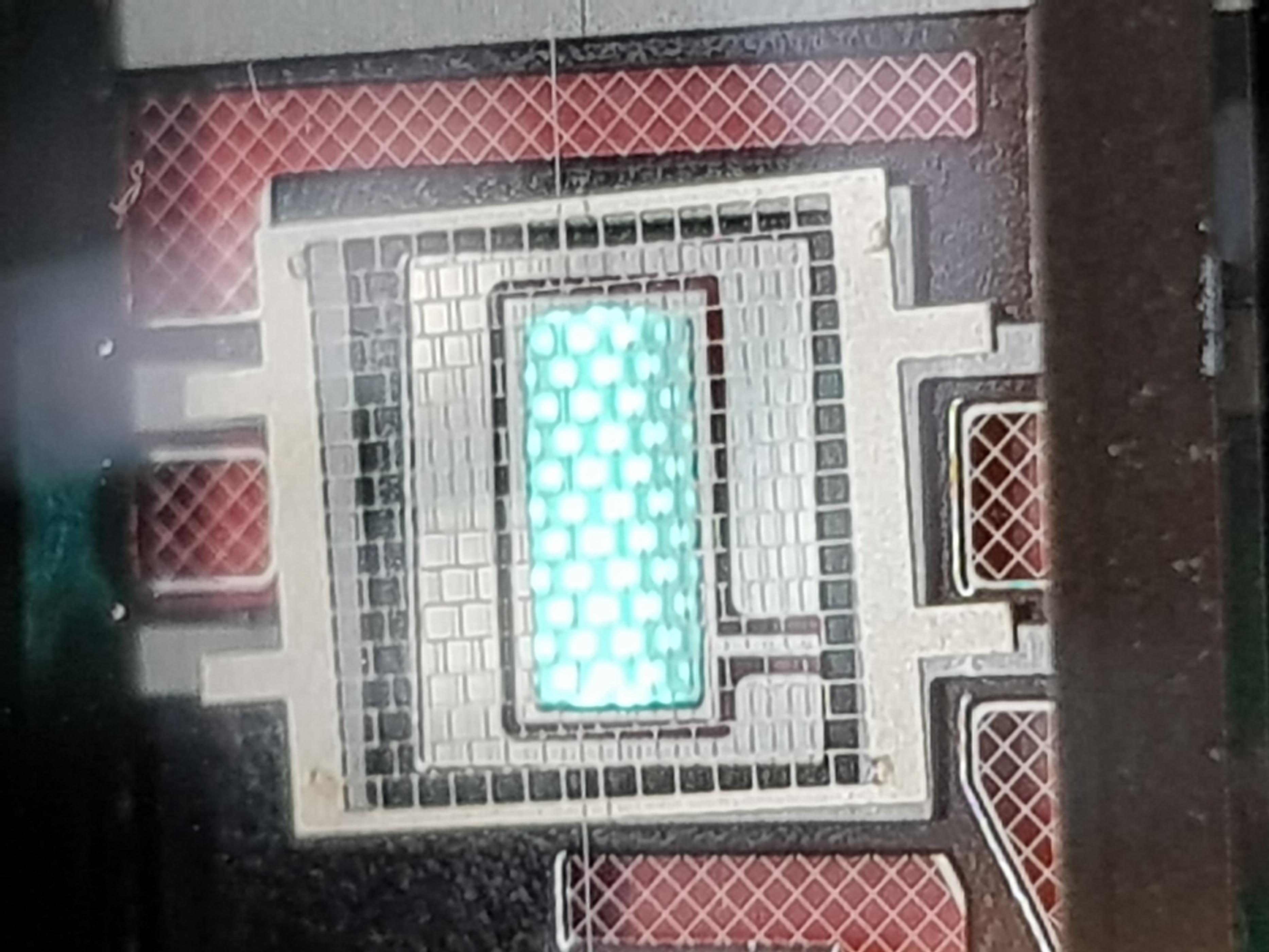

Hi there. I’m not able to get a stable voltage at T8. After trying to set to 9.5V it’s now fluctuating between 8.5 to 10V... All good at T7 with a very stable 9.5V. I’m wondering if the crooked “frame” on the right channel of my Nutube is more important than I thought? See attached photo. Any suggestions?
Hi, sorry for butting in earlier. Could my T8 voltage instability be a consequence of a defective Nutube? Seek advice as to seeking a replacement Nutube or could this be caused by something else?

if you done everything as prescribed and you have stable voltage at T4, point B, same as across R1 , then tube is in question
