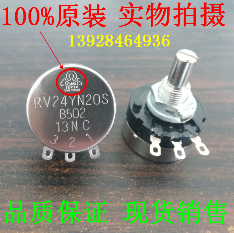

Then came the Tocos Cosmos. That one was recommended by some UK sources as heir to the Black Beauty and even perhaps bettering that one. They were measuring outstandingly well and putting shadows on the need for step actuators sonicaly. But then it appears sellers complained about channel tracking and stopped importing it.
I looked closer and found out that this nice and still small sized potentiometer was in fact standard ware, nothing fancy audiophile. That could explain some tolerance variations (and no special line), or the fact sellers didn’t like it – well, they must have made a HUGE margin, but perhaps that was also killing some myths. Nowadays you can buy it online at the usual providers with a 5% tolerance waranty for 8$ only (and nearly as much shipping in my case LOL). A real bargain if it delivers.
You can have it cheaper without tolerance waranty but that wasn’t for me as I expect the bad ones to be sold that way… But that’s just me thinking loud.

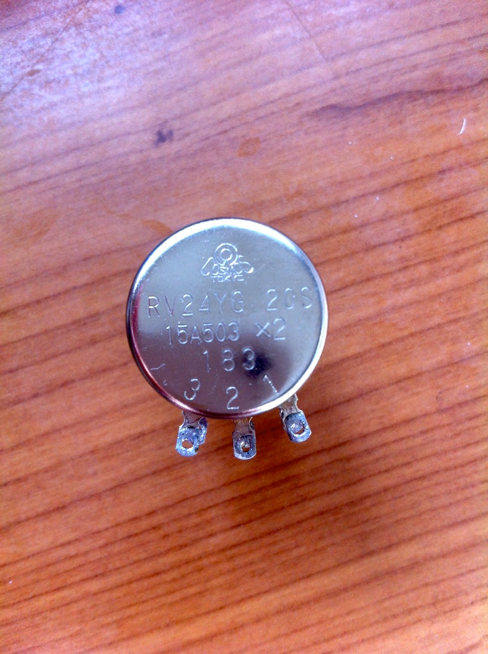

Again I couldn’t help carrying out numerous measurements to find out how it behaved. It came with a 5 point channel accuracy record and that one proved to be dead accurate , giving -0 +5% channel tracking (but not voltage divider values). Well done though and as advertised. But these were just… 5 listening positions. This is what I found out, taking of course into account the slightly different full channel resistance for the ratios :
- channel mismatch of around 3% up to 11h00
- Oddity at 10h00 with very punctual 8% mismatch, same around 2h00 (construction ?)
- Other than these picks around 3 to 4% mismatch most of the time, always one channel showing more than the other (did over 70 measurments)
- Front channel total 49.4k, rear one 48.8k
It is like this double mono potentiometer is slightly shifted between channels, but its construction doesn’t allow you to ‘bend it’ right again. One has though to put this values into perspective. These are real life measurements of the full contact line.
Enthousiasts like 1% variation, but once resistors are soldered in place etc. real mismatch is often bigger… but does it matter ? Not really, as if I did my math correctly ( ???), 1% is 0.09dB variation and 5% still very acceptable 0.42dB and 10% would still be acceptable 0.83dB (but as things can add up in a device…). So one has to look beyond the pure values : this pot measures well and has a real several megaohm channel isolation.
However, I figured then something out. Guys, don’t shout at me if this is a COMPLETELY SILLY IDEA - which it is probably again as I couldn’t read anything on what my poor brain decided to do.
As the (slight and non critical again !) mismatch was only in one way, I calculated that adding a 2.1k resistor at the entry of the rear channel would bring outstanding values. And it did ! 1% 50ppm resistor in and we get a compensated pot with :
- +-1% channel variation mostly all the way
- bare the to afore mentionated oddities that are though brought back now to roughly 4% channel mismatch (this is just on 2 points, like something on the track right there)
I don’t know if what I did makes sense, please let me know, I can still undo it when it goes back to the to B1 KORG. And going back it does, as it completely killed any potentiometer I had so that I had only to compare it directly with my reference divider. Whereas the small pot’s weaknesses were spotted in a few seconds, that high level comparison took me hours as the Tocos is nearly as good as a pure directly soldered and wired resistor set up. There was though a little someting, I noted :

About the Tocos it seems HiFi Collective had them for a while but they don't stock them more because Tocos could not guarantee 1.2 dB channel matching. More info here:
Tocos Cosmos Stereo Potentiometers | Hifi Collective
There are some review also. As they are quite cheap you could just buy a lot and then select the best of them. Apart for the not so good channel match they seems to be good value.
Yep, that's were I discovered them and there is (<as years ago at least) also a proper review of them against other pots on the net... But this old and I wanted real life experience.

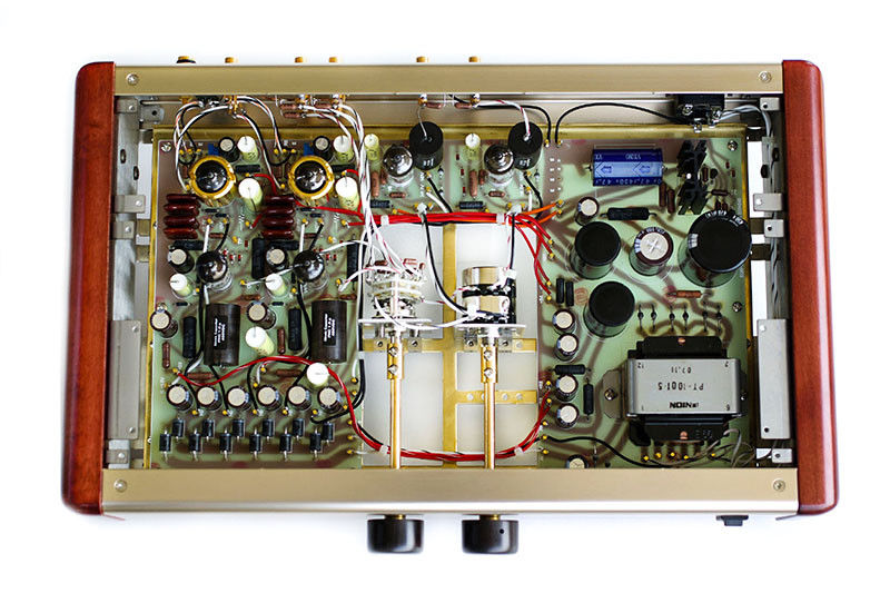

Do you know which pots Yamamoto use in their phono pre-amp (picture)? From distance they could look like normal cheap pots.....but I guess they are not. Maybe some that could be used in DIY constructions also. My guess is they are very good.

Re Yamamoto I can't see on the pix, but browsing on internet through other pix (bottom view) it could indeed well be the Tocos by the look of it.
