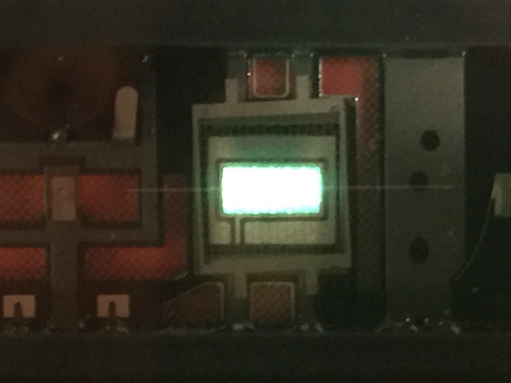

Well, all solder joints were reflowed. Tubes still green...

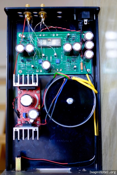

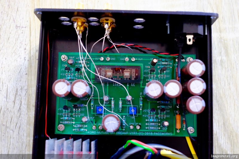

MEPER, I will post a clear photo of the board. I have to re activate casimages.com (pay some more...), then extract a link to post here.

Nelson :
Near Nutube :
left, R1 = 1,8V right, R1 = 1,8V
left Q2 - 9,5V right Q2 - 9,7V
Near Trimmers :
left, R1 = 1V right, R1 = 1,6V
left Q2 - 9,7V right, R1 = 10,4V
Across T1 - 0,824V; across T2 - 0,824V; across T3, 3,2V
Voltage in Q2 is measured between left and right leg

http://www.imageshotel.org/images/polaron/dsf2208.jpg

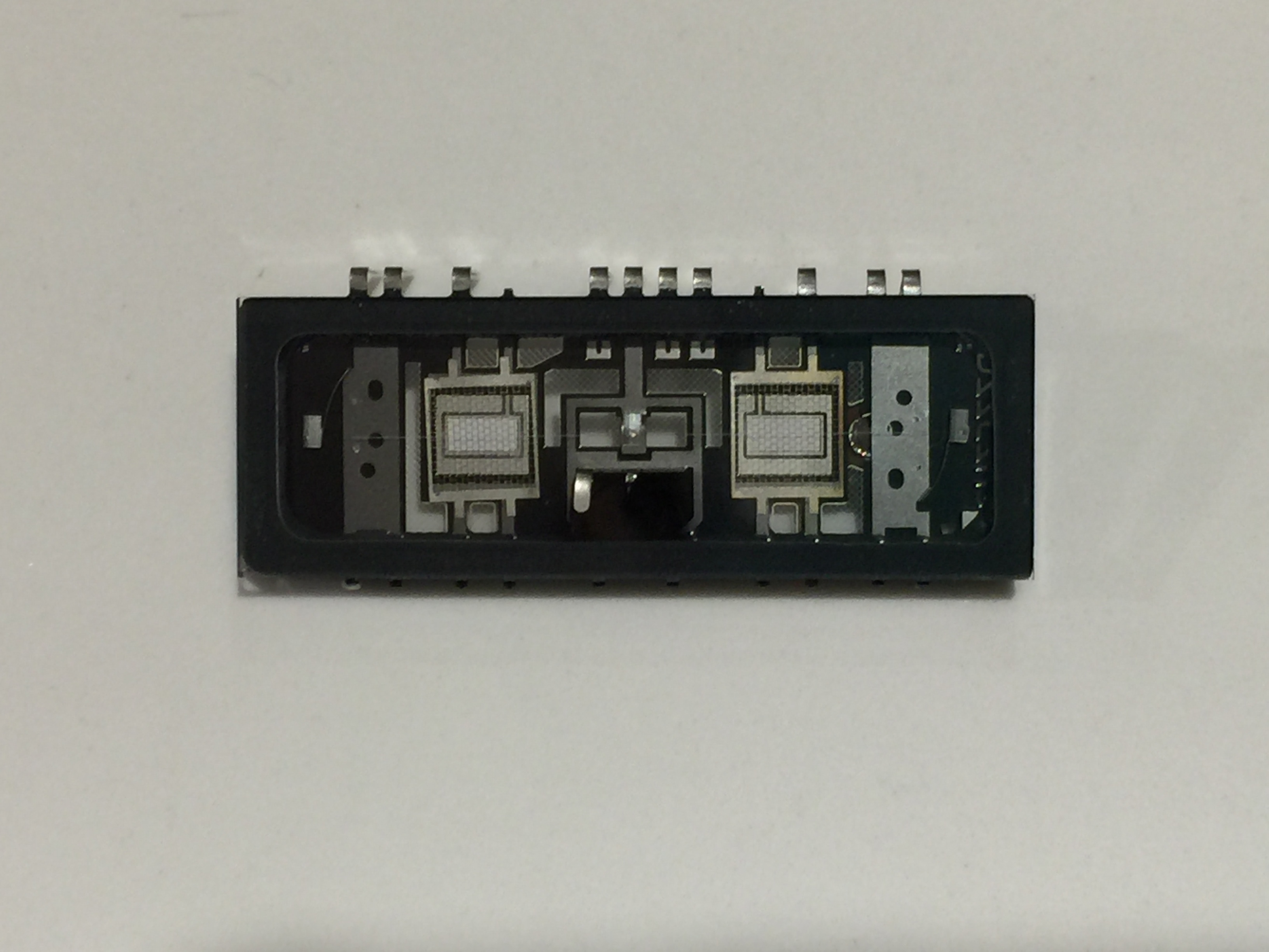

Hi there. I’m not able to get a stable voltage at T8. After trying to set to 9.5V it’s now fluctuating between 8.5 to 10V... All good at T7 with a very stable 9.5V. I’m wondering if the crooked “frame” on the right channel of my Nutube is more important than I thought? See attached photo. Any suggestions?
