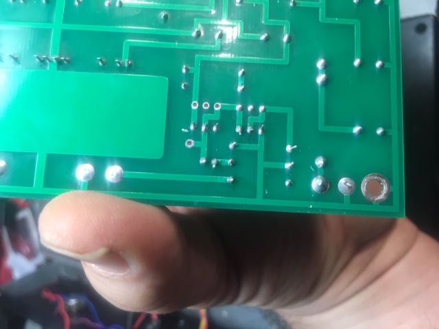

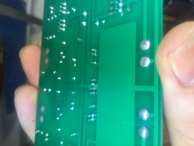

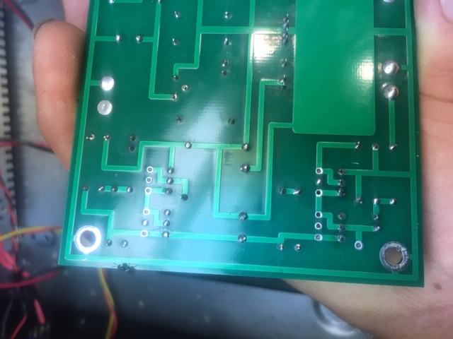

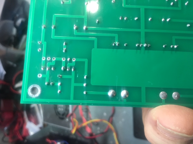

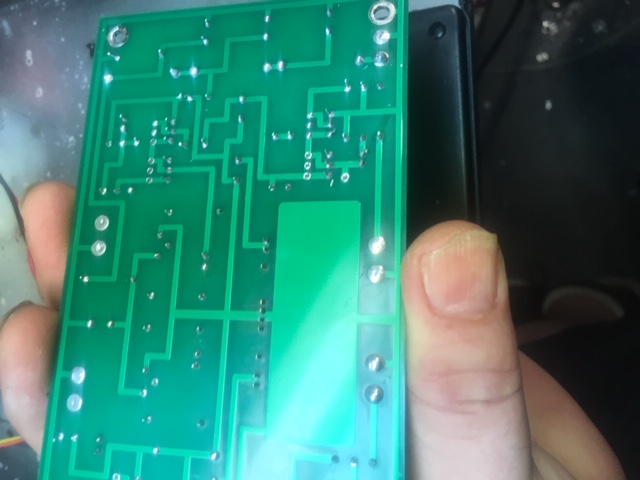

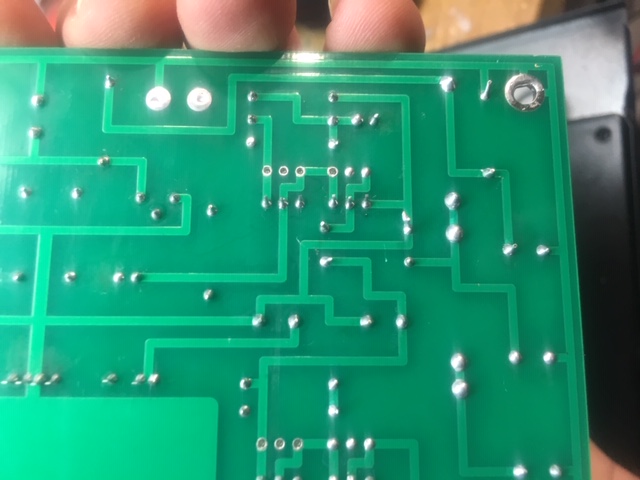

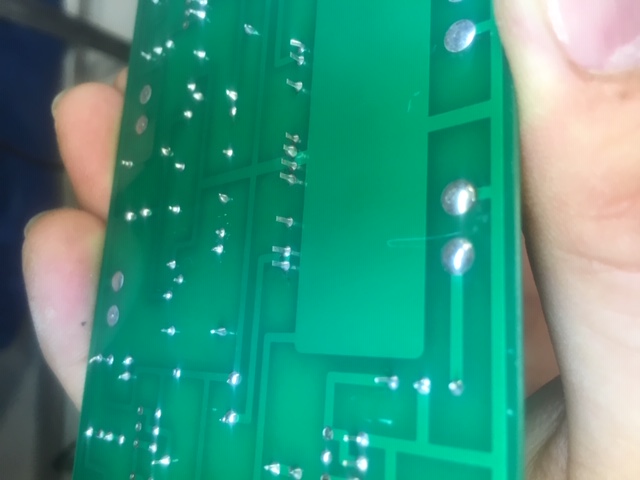

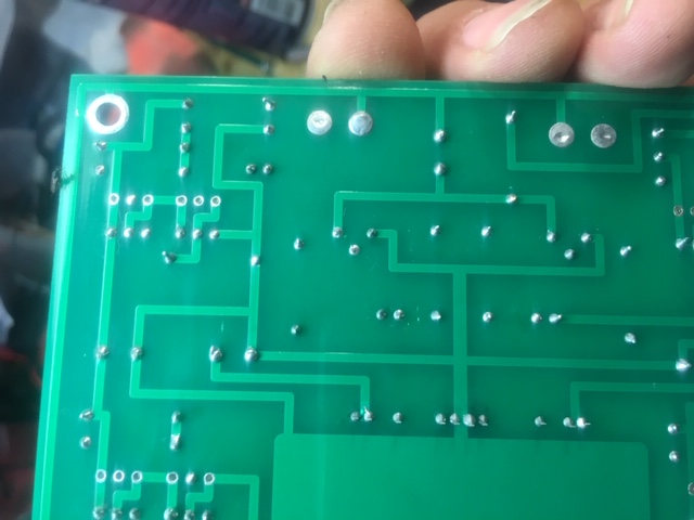

Can we see pictures of the back of your board?
Sure can, I will have to send them in the morning, as I am home now and my hobby (obsession) shop is 45 minutes away! It will be a fruitless endeavor though, I checked all traces and connections with the schematic, solder joints are good, I checked with high magnification, I may have just gotten a 6p1 with a small vacuum leak which led to its early demise. It was handled with anti static protocol on my end.
Back of board pictures per your request.

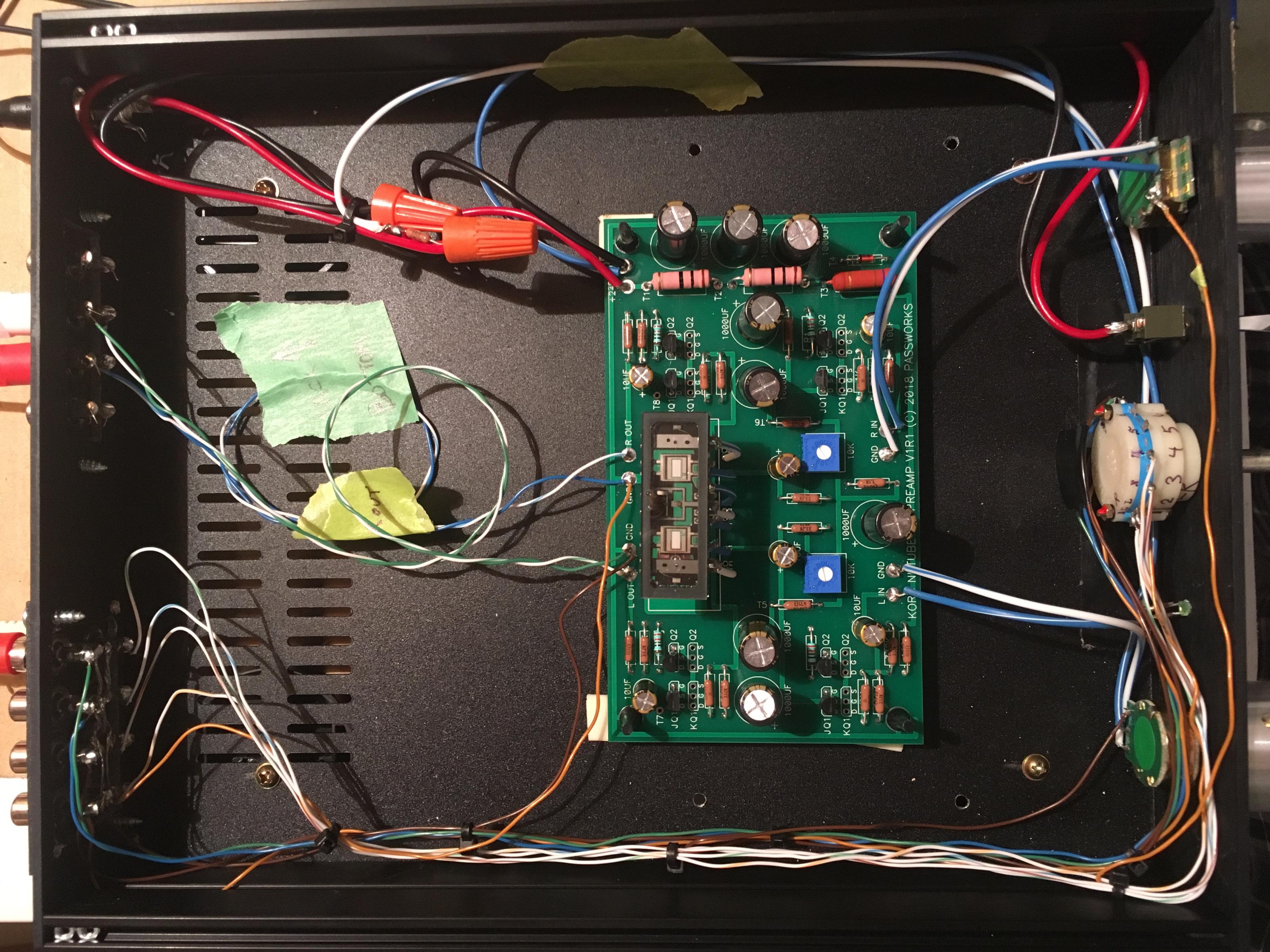

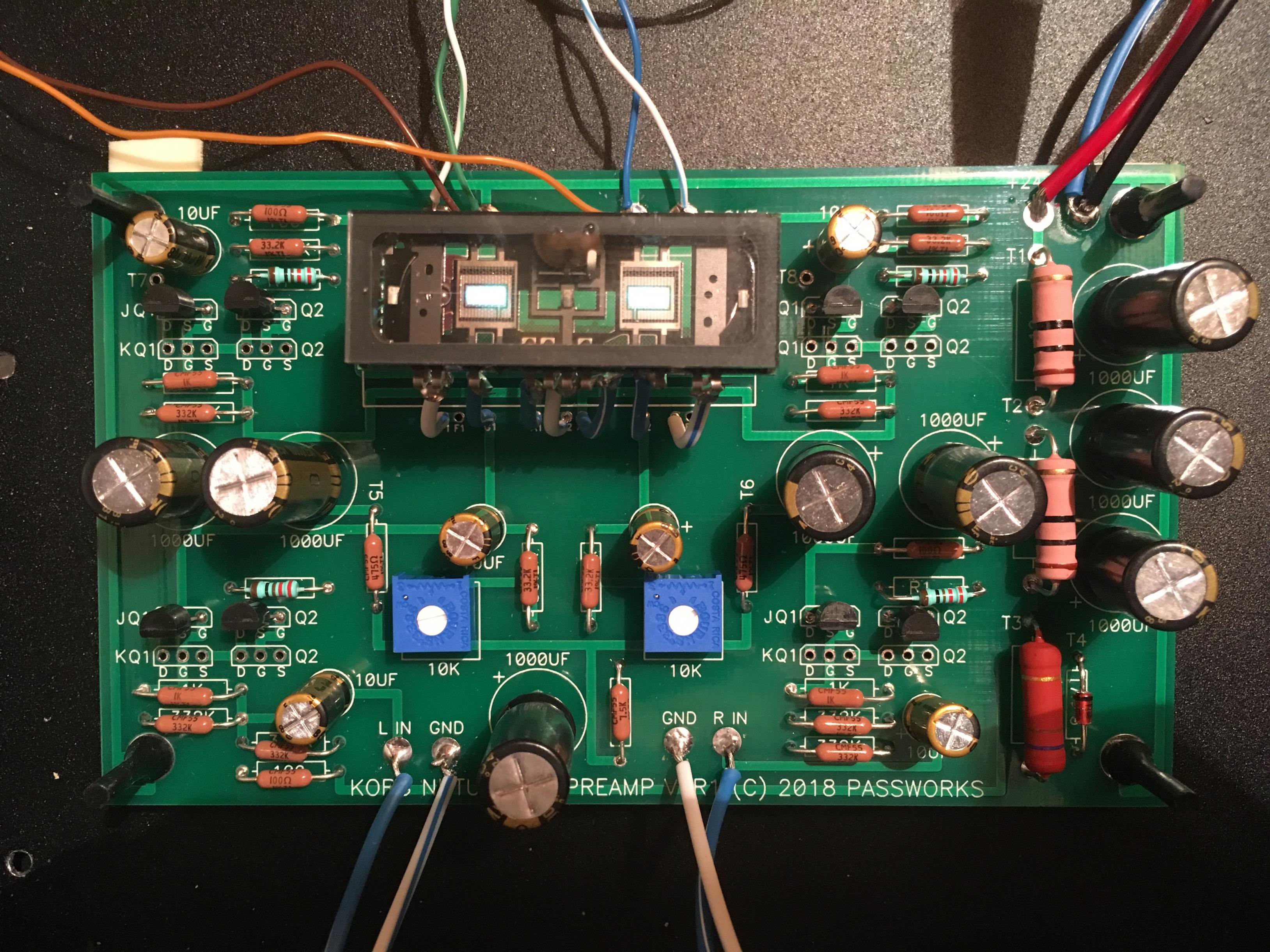

Hello All, I finally had a chance to assemble my B1 Nutube and get it in a chassis. I repurposed the chassis I'd used for my B1 buffer and just added a power switch. In an effort to tame the microphonic issue that's been reported I used silicone PC fan mounts with two sided tape to keep them still. I also soldered wire leads to the Nutube to try and dampen any direct vibration as others have done. Being a rookie I made the leads a little short which made getting the leads soldered into the pcb a near headbanging experience. I would recommend that anyone going this route make the leads longer to provide more flexibility to solder the wires in. There is the "tinging bell" microphonic sound that has been reported, but only when I turn the input knob. To be honest its no where as loud or intrusive as I thought it would be, and fades quickly. All of my initial measurements were within 0.5 volts as described in Nelson's Nutube PDF, and I adjusted the pots to 9.6v to start. I've been listening to it along with my M2x for almost two days and all seems ok. I'll play around with the pots settings after my current setting has sunk in a little.
A huge thank you to Nelson for creating this project, and to the DiyStore for getting it out for everyone to buy. The quick build guide that 6L6 put together in the thread is as always very helpful, thanks Jim!

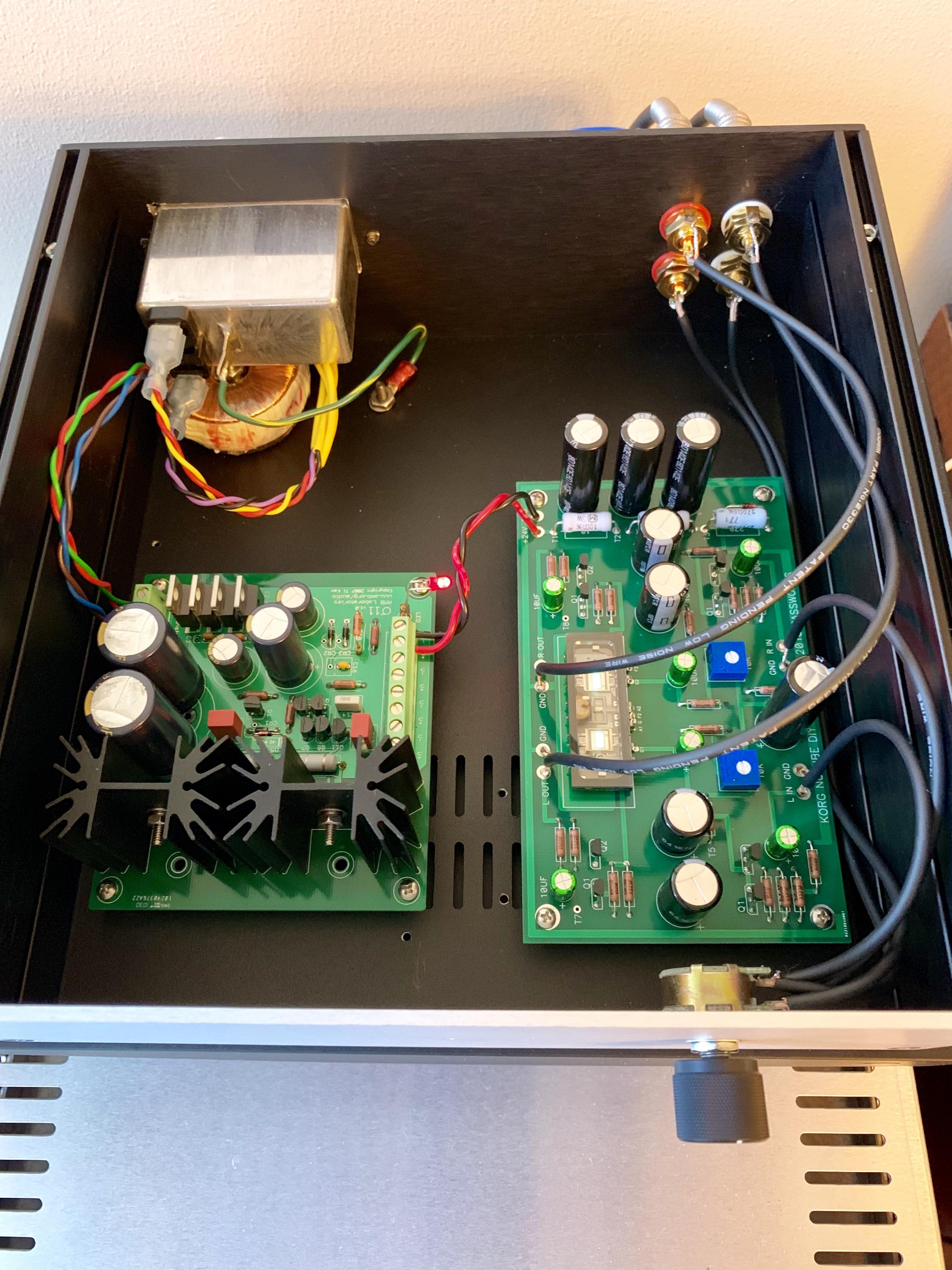

Another one comes to life. Galaxy case, 10k stepped attenuator, AMB s11 supply. This is from the xmas batch - thanks Papa!
BK
Clean build bk, well done!
