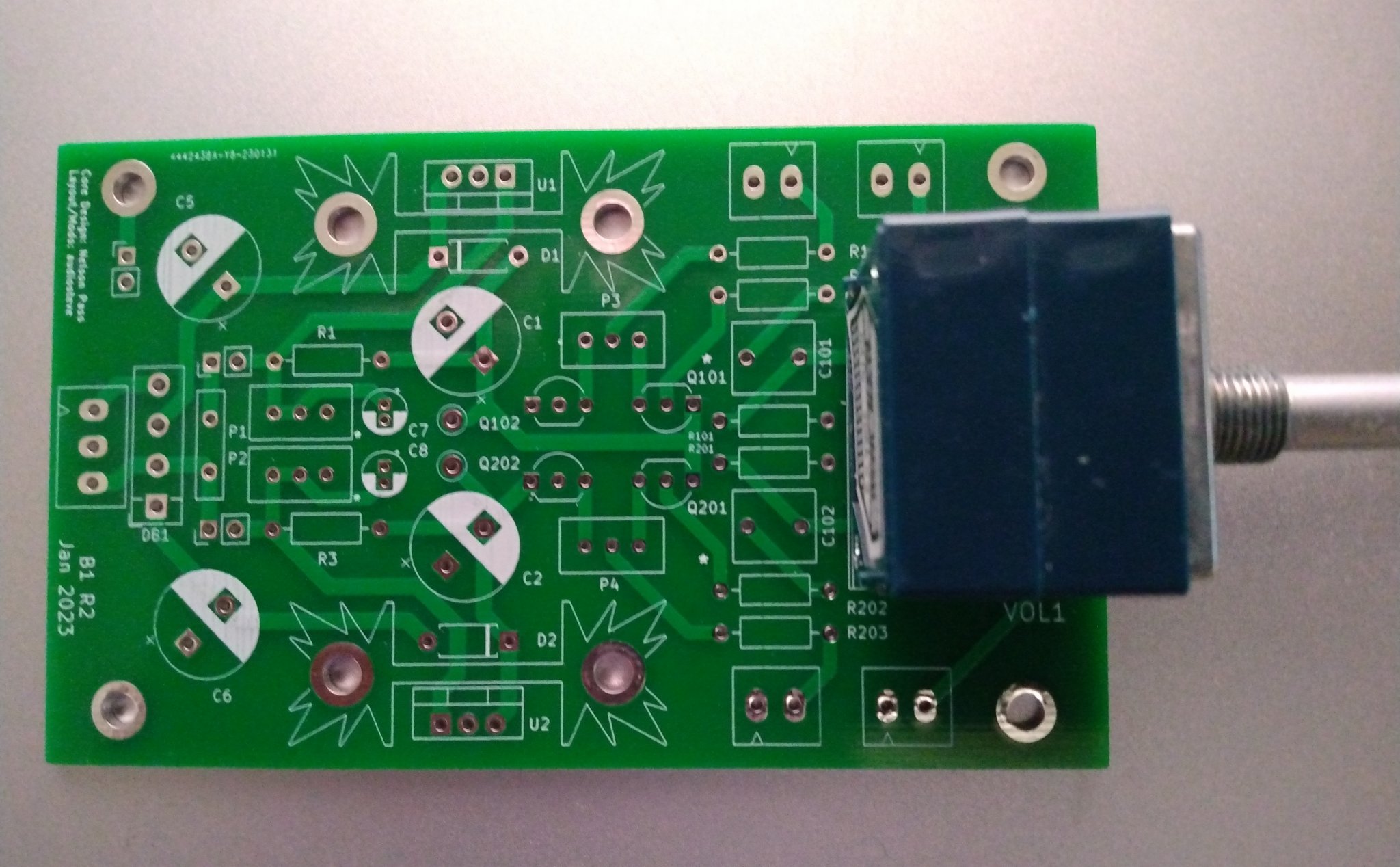

Has anyone made a board for B1 Rev.2 with a complete power supply?
Some pictures, please.
I got these boards back last week. I saw some one else do something similar and wanted one for myself so laid out my own. I may be able to get them stuffed and tested this weekend. It uses LM317 and LM337 for the regulators and an Alps pot. I'll use a wall wart transformer. There are also jumpers so you can forgo the onboard power supply and populate and use it with an external supply. The pot is sitting on the board to show scale.
If it works Ok, I'd be happy to share the boards, BOM, Gerbers, or KiCad project files.
AudioSteve, that board looks terrific! Nice work!

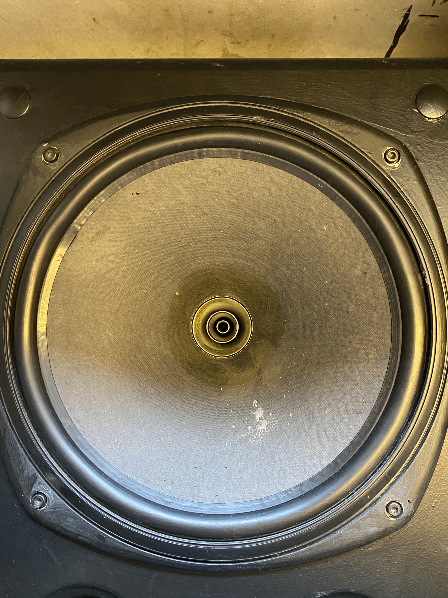

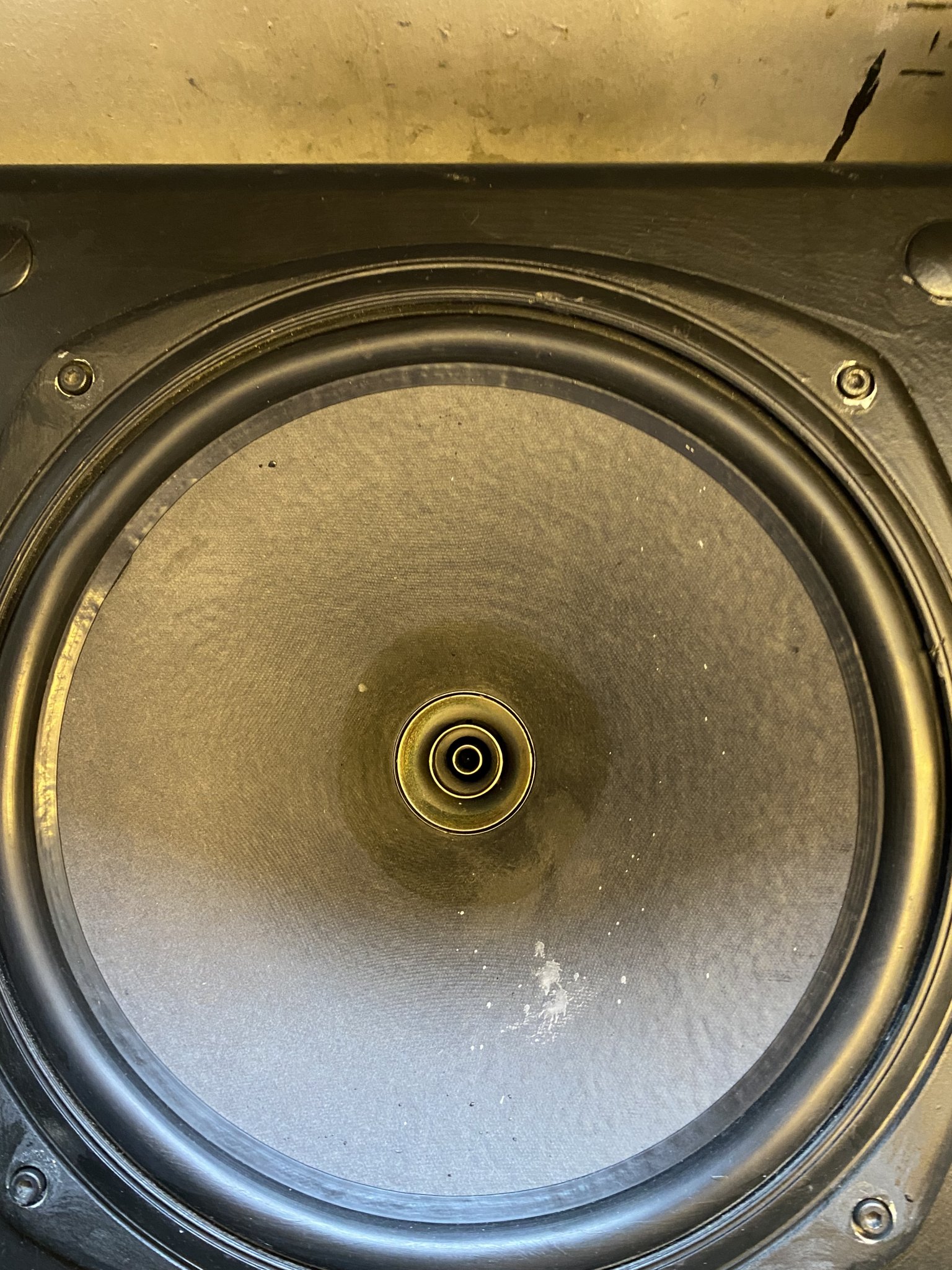

Still working on driver A. Attached is before and after pic of cone and surround cleanup (yes, hours there…) and two coats of Dammar, awaiting third coat. Then on to removing paint from the basket, sanding and spraypainting to pimp it up.
Tweeter diaphragm will also be replaced, and I also got hold of a second tweeter replacement for driver B from Tannoy’s stock, on it’s way. Nice to have on hand, and more won’t be made.
Drivers are 3134’s from CPA12. I have those boxes too, won’t be used, and crossovers (will be used). Drivers will eventually go into boxes drawn by the great MZM.
These drivers are like an old race car/pr0nstar: you can readily see the former grandeur, but some glossing is needed for further duty ❤️
The CPA’s used to sit in the national theater playing lounge music. But even though initial listening impressions were OK, they clearly need a lot of tlc. Just found out I may need to disassemble cone/driver B, there is scratching. Need to investigate further, but first I wanna finish driver A.

I am not too familiar with Tannoys design. However, Do the magnets shift on them? What I have done in the past is to gently touch the outer perimeter of the cone in different spots while playing a sine wave that exemplifies the scratch/buzz sound. cautiously of course. When the scratching goes away, the cause is usually on the opposing side of the voice coil. I don't know how easy they are to take apart but they look to be in pretty good shape after your work.
A few things that I have run into that cause noise is, junk in the voice coil gap which can sometimes be cleaned with tape. A loose spider to basket or spider to voice coil joint. bad voice coils which can usually be measured. A magnet doesn't have index pins but rather a failed glue joint. The magnet can be slid back into place while checking the gap, and then epoxied around the parameter. I have done that a couple of times.
However, Tannoys may just be a completely different beast and I may just have no clue what I am talking about. 🙂

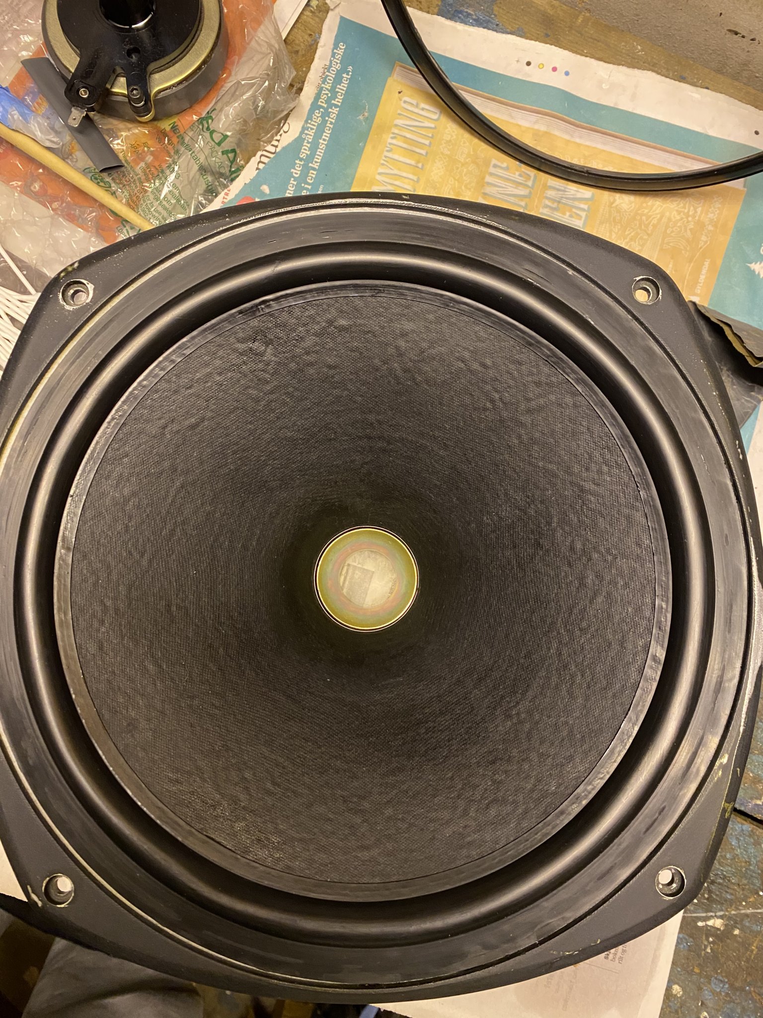

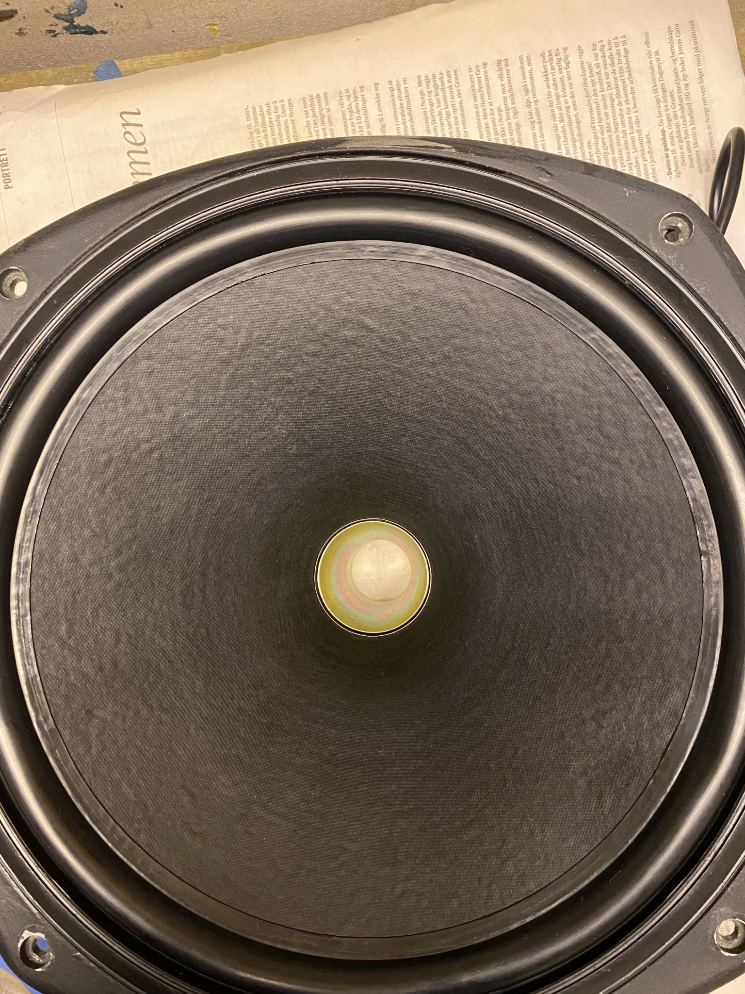

Driver A ready for basket paint after 3rd coat of dammar. No, they did not dammarize at the factory, that much I know :rofl:
The outer rim (haha) fell off. But that was so damaged and ugly, I want a new one. Links appreciated.
