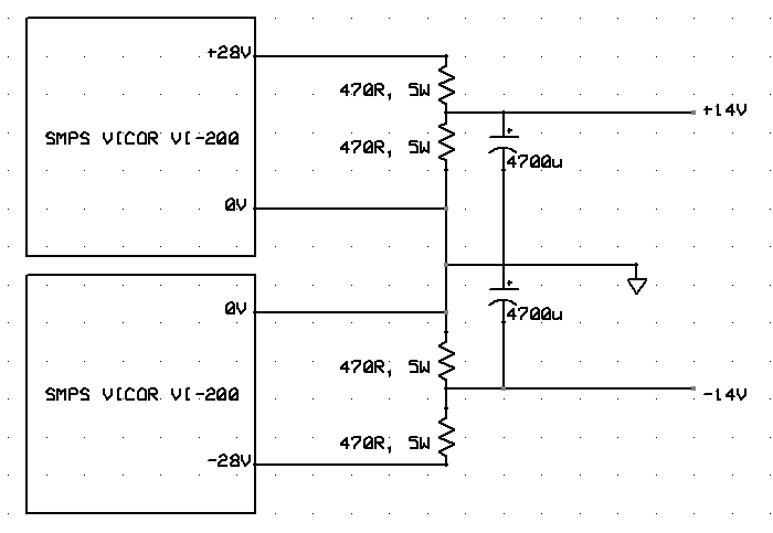

Thanks Pico. I think the 500 Ohm V dropper sounds simple enough.
Unfortunately, I have no space in my chassis for any additional components or transformers. I have some 28V switchers in place already in place for a solid state power amp stage. Additionally, I have some B+ stuff happening for a tube pre stage. I just need the B1 because I'm using a 100K pot after the tube stage and before the power stage, and need the buffer to clean up some voltage loss because of the impedance mismatch.
As an alternative, does the attached caveman approach work ok, from a B1 input impedance and also performance perspective? I don't care about the wasted heat of the divider. Actually, the SMPS works better (resonant type) with a little extra load on it, and I have power to spare.
The idea is totally fine but you will be pulling a lot more current across the first resistor so the voltage drop will be larger than expected.
If that’s driving both channels then something like 470/1500 is probably closer to what you might want.

Thanks! I hadn't considered the draw across the first resistor in calculating. Just used the dumb resistor divider equation.The idea is totally fine but you will be pulling a lot more current across the first resistor so the voltage drop will be larger than expected.
I can play with some values.
Do you consider this a compromise in power supply (as per your response to Andynor). Seems that a 100-500R and 4700uF have a pretty good low pass filter response across the audible range especially because with the SMPS the 60 and 120Hz components are already way down below -100dB (from previous measurements)
Could do away with the voltage divider and just use a series dropping resistor. Combined with the decoupling capacitor at the buffer pcb will make a nice RC filter.The idea is totally fine but you will be pulling a lot more current across the first resistor so the voltage drop will be larger than expected.
Yeah this is one benefit of a switcher, it's easier filtering out high frequency noise with RC filtering compared with getting rid of 100Hz of rectified ripple.
I would include additional RC filtering per channel - say 5 Ohms and 4700uF per channel after the main supply you have illustrated.
Taking it one step further would be adding shunts or a loaded series regulator per channel after that additional dual mono RC filtering step.
Yes that will also work, but I think it is preferable having less series resistance and more capacitance, rather than more series resistance and less capacitance.
Adding a little extra load on the supply is also beneficial, so I like his idea a little more.
