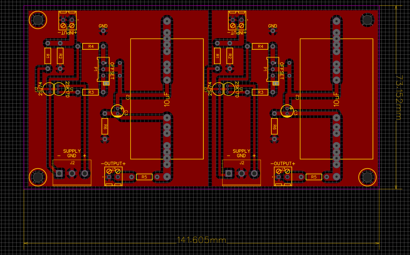

This should be the turn on/off protocol ALL the time 😉 .Pico, Are you thinking of a resistor from the output of the cap to ground like how it is on the Korg Nutube b1? When I get the boards on my next order, I will play around with the 10uf signal output cap board and see if it stores energy in it. I guess it would cause a turn on thump or something like that. Maybe the protocol should be, turn on the preamp, then amp. Amp off, then preamp.

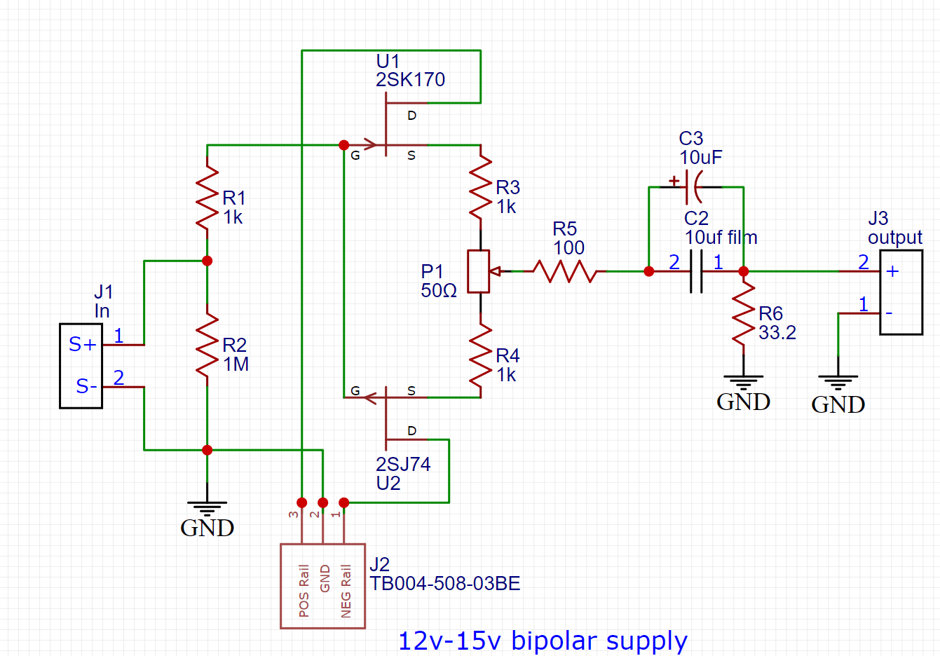

Okay. added a R6 from the cap output to ground to bleed the 10uf cap. Any other precautions that would be good to have on the board?
That was what I thought when I looked at the B1 Buffer with the caps. I didn't know whether it made a difference or not and it wasn't mentioned so I left it.

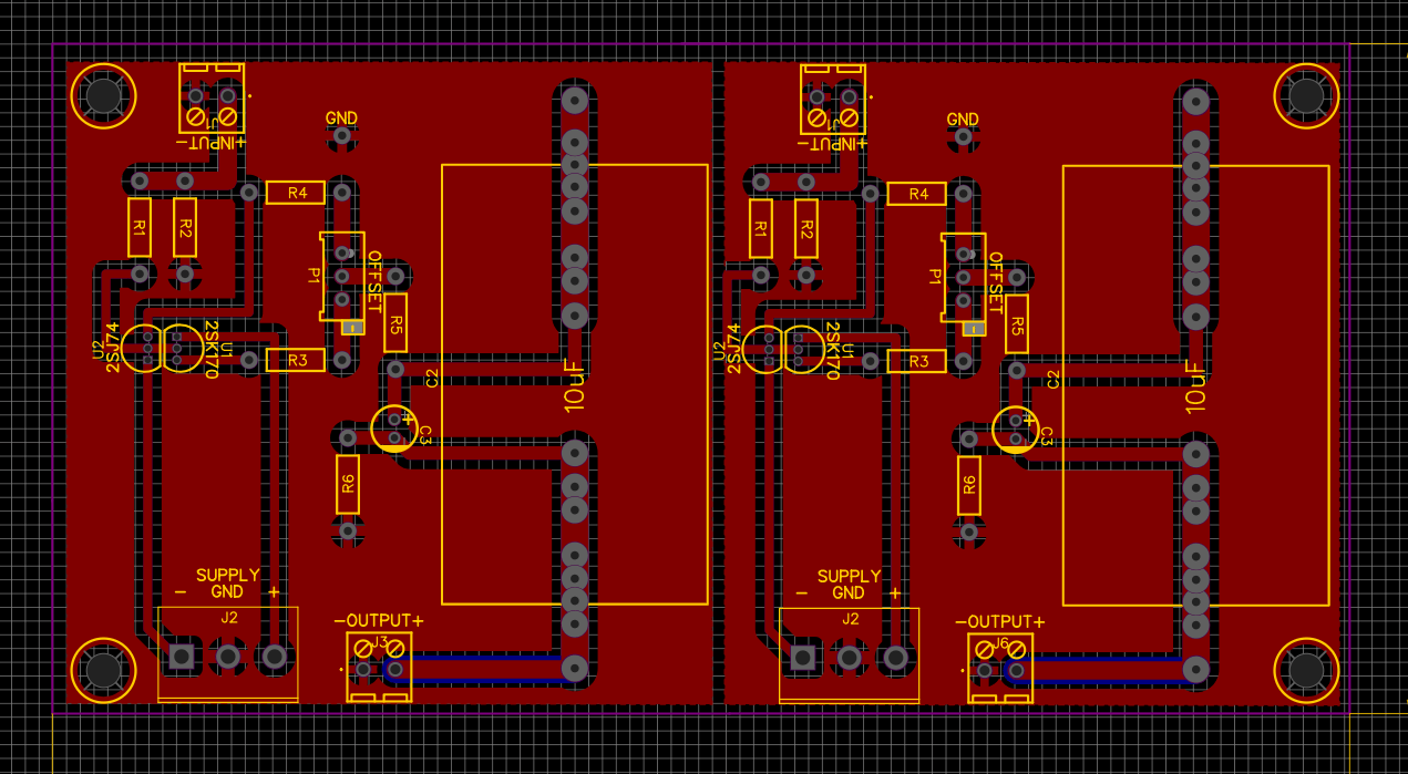

Here it is with R5 in the new position. I also added two pads so that the jumpers that are in R3 and R4 can be transferred to where the legs of the pot were. That way everything can be easily connected once the trimmer is bypassed.

I think my next step for me is to get the no cap and the output cap boards and test them. If that goes well, I will likely try adding a feature or two as it is fun to play with these PCB board programs. I am relatively new to drawing up circuit boards so I need to test my work so far.
There are a few programs that you can try if you want to play around with adding a cascode circuit. EasyEDA has a good library for components so it is easy to get started with. Kicad is another. Eagle is another program but that costs money I believe.
I can try to figure out how to get the file project file to you if you like. Such a simple circuit like this is a good way to jump in. 🙂

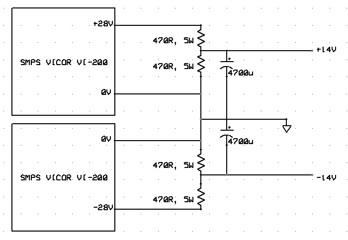

Not really ideal, if you want the best from this circuit, but if you didn't want to purchase a new transformer then I would probably go RC then Regulator eg
500 Ohms, 15000uF, Regulator
That would drop the voltage about 8 Volts on each rail.
I don't think a new transformer is that expensive though. Just get a new one if you can.
Edit: If you used a mosfet cap multipler (instead of 3 pin regulator) you could drop more voltage so maybe that would be better.

A few questions. The original schematic has no R3 or R4 yet it has appeared in subsequent schematics here. I looked through the entire thread here and saw no discussion of what they are there for. Why are they there? What is the upside and downside of adding them and why was 1k chosen? Many thanks in advance for an elucidating reply.
The original R2 schematic has both R3 and R4. They are part of the power supply filter section, intended for a SMPS. And they are not 1k. I do not use these parts, since i have a regulated linear psu. I don’t think we are talking about the same circuit.A few questions. The original schematic has no R3 or R4 yet it has appeared in subsequent schematics here. I looked through the entire thread here and saw no discussion of what they are there for. Why are they there? What is the upside and downside of adding them and why was 1k chosen? Many thanks in advance for an elucidating reply.
If you are referring to Mike’s revised circuit, the R3-4 1k’s are nominal values to symbolize the possibility of replacing the pot with resistors. Values should end up very much lower, and will take care of matching differences between JFETs normally taken care of by the pot plus apply some degeneration.
Andynor has the right answer. 1k is just the value automatically inserted by the PCB program. I should have probably put a "?" in there or something.
You'll likely end up with a value like 20-30 for each spot but you would have to measure the pot to figure it out. The idea is to get the trimmer out of the signal path.

That makes more sense. The R3 and R4 I was referring to are in the schematic at post #345 and are not the voltage divider in the PS of the original design. But they have the same numbers. Thanks for the replies, gents.Andynor has the right answer. 1k is just the value automatically inserted by the PCB program. I should have probably put a "?" in there or something.

Unfortunately, I have no space in my chassis for any additional components or transformers. I have some 28V switchers in place already in place for a solid state power amp stage. Additionally, I have some B+ stuff happening for a tube pre stage. I just need the B1 because I'm using a 100K pot after the tube stage and before the power stage, and need the buffer to clean up some voltage loss because of the impedance mismatch.
As an alternative, does the attached caveman approach work ok, from a B1 input impedance and also performance perspective? I don't care about the wasted heat of the divider. Actually, the SMPS works better (resonant type) with a little extra load on it, and I have power to spare.
