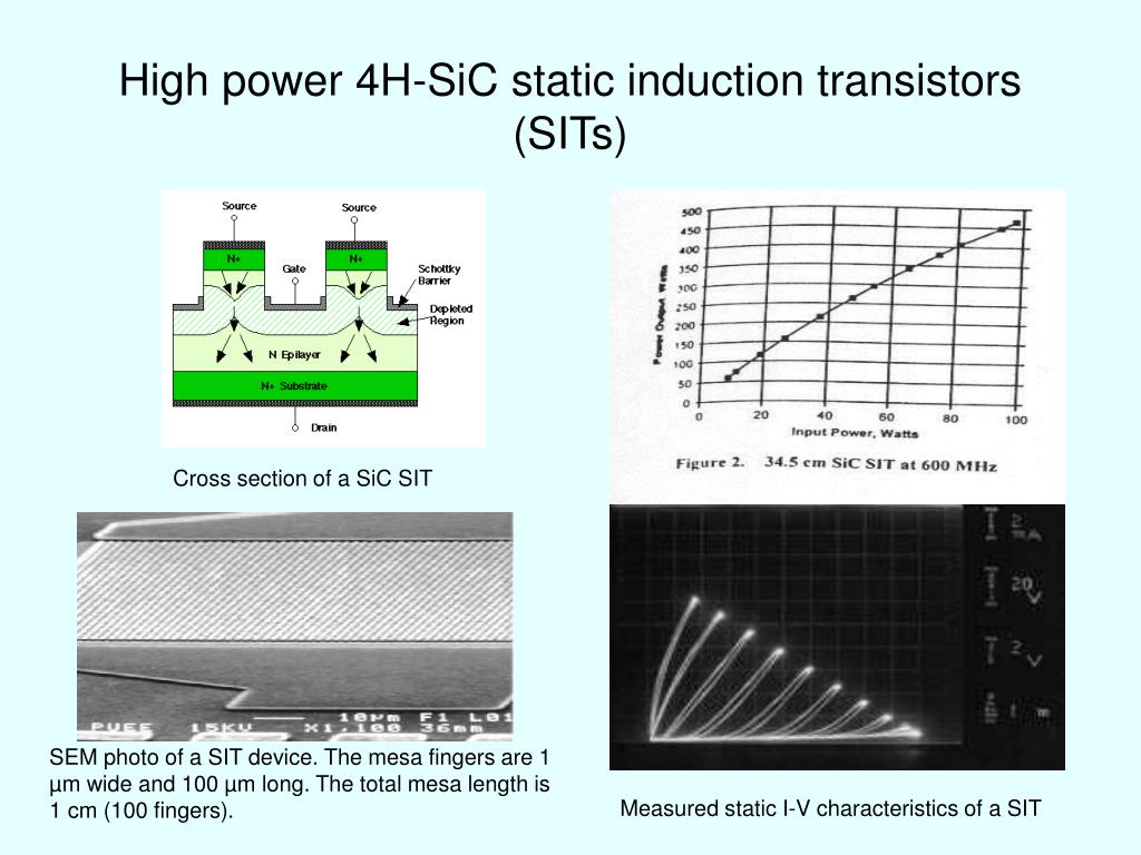

According to "Mr V-Fet" the MTX uses a V-MOSFET which has a pentode characteristic. (I do love the pentode sound)
He further claims in an unclear sentence that Papa's SIT's are actually JFets. I think he may be referencing this article: Nelson Pass
TAN-8550 finds a new home | Page 2 | Audiokarma Home Audio Stereo Discussion Forums
Mosfetz are typically characterized as having pentode-like gain characteristics, SITs as having triode like gain characteristics. This is a good article from Nelson for further reading: https://www.firstwatt.com/pdf/art_sit_intro.pdf

he claims that they claimed falsely, or wrong (and there he's correct)
then he claims wrong , about Papa's claims
in fact, for the record, Pa made distinct classification of various Fets and V-Fets and whatever, in his articles; of course that classification in everyday correspondence here is slightly more loose

This site does a nice job of explaining the differences too. AMPLIMOS V-Fet & SIT Amplifiers, One Stage Amplifiers
Great articles cody! ty! Little bits are starting to sink in with every (re)read.
ZM- I had little doubt the poster was overreaching. As I am one who also overreaches and could recognize myself in the statement. Thanks for the confirmation
I'm starting to understand why SIT is a more useful term than VFET

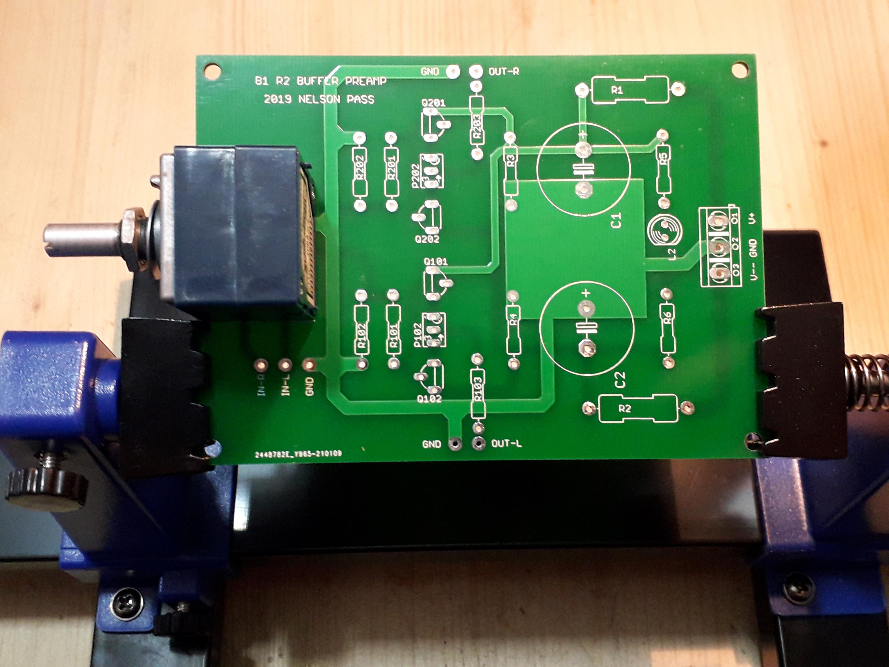

- B1 r2 proto or prod?
